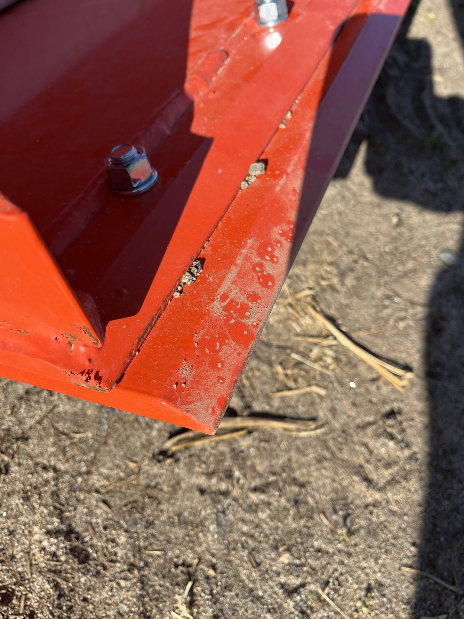

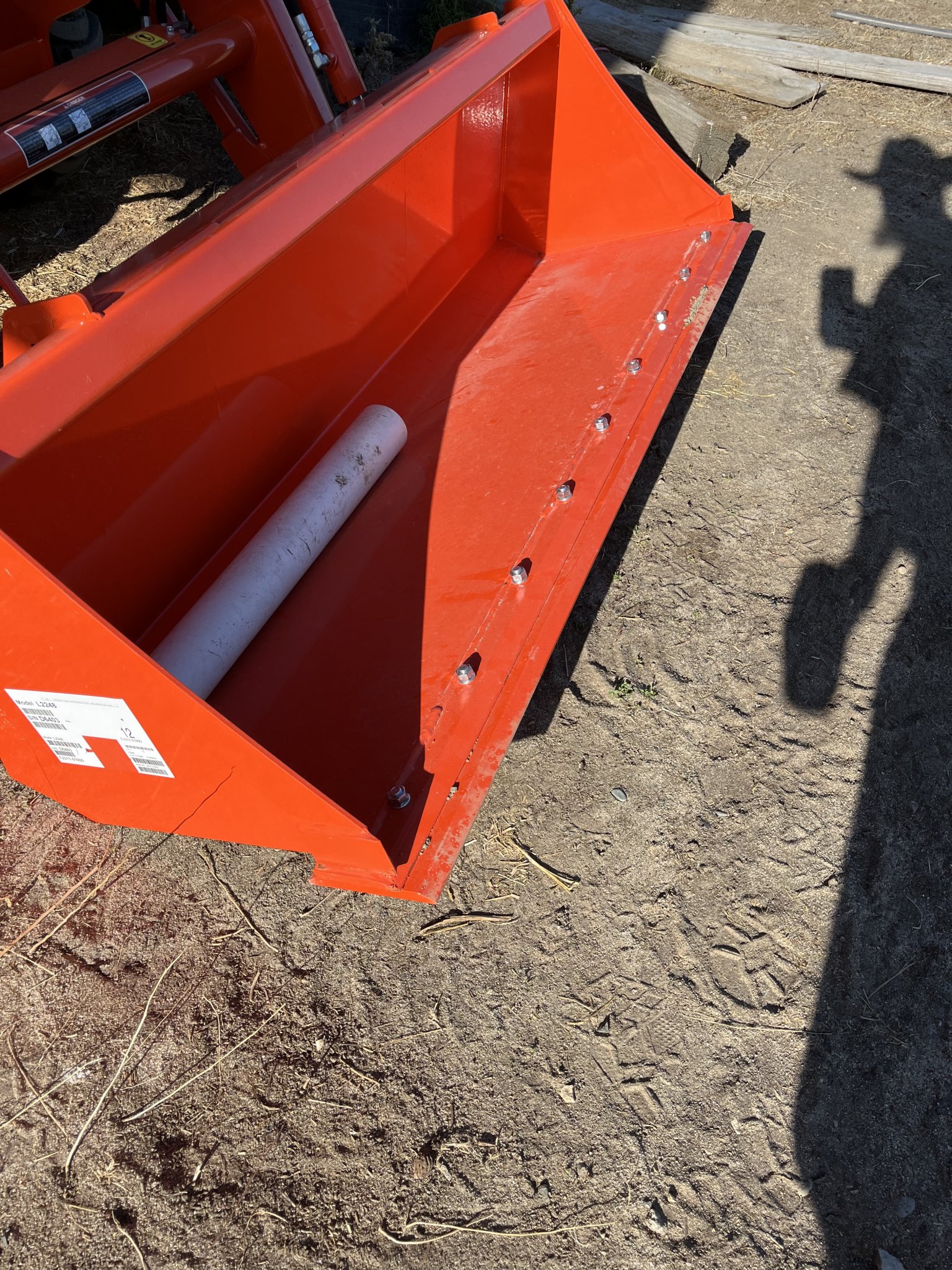

I’ve had my 3302 for about a month. The cutting edge was on backorder, but I finally got it yesterday. Now I want to add a tooth bar, some forks. And some hooks. I like the looks of the piranha but it only looks like you can put forks towards the side of the bucket. I could be wrong about this. That’s why I’m asking. Is the piranha tooth bar that much better than the old style? Also my new bucket with cutting edge has a quarter inch bow in the bottom of it. I haven’t had the best service so far on this tractor. So maybe I’m being a little picky. Thanks in advance. Also has anybody had any bad luck with these hook plates with the rings and receiver on it.

If your bucket has a bend in the bottom edge the dealer should replace it. It should sit level and if it doesn't then let the dealer know. You wouldn't accept a defect like that if you spent money on a new car, so why would you with a new tractor? If I had a bend in my bucket and it was used, I would fix it. If it were new, I would tell the dealer that I wanted a new bucket. That bend isn't going to go away or get any better, but it could get worse.

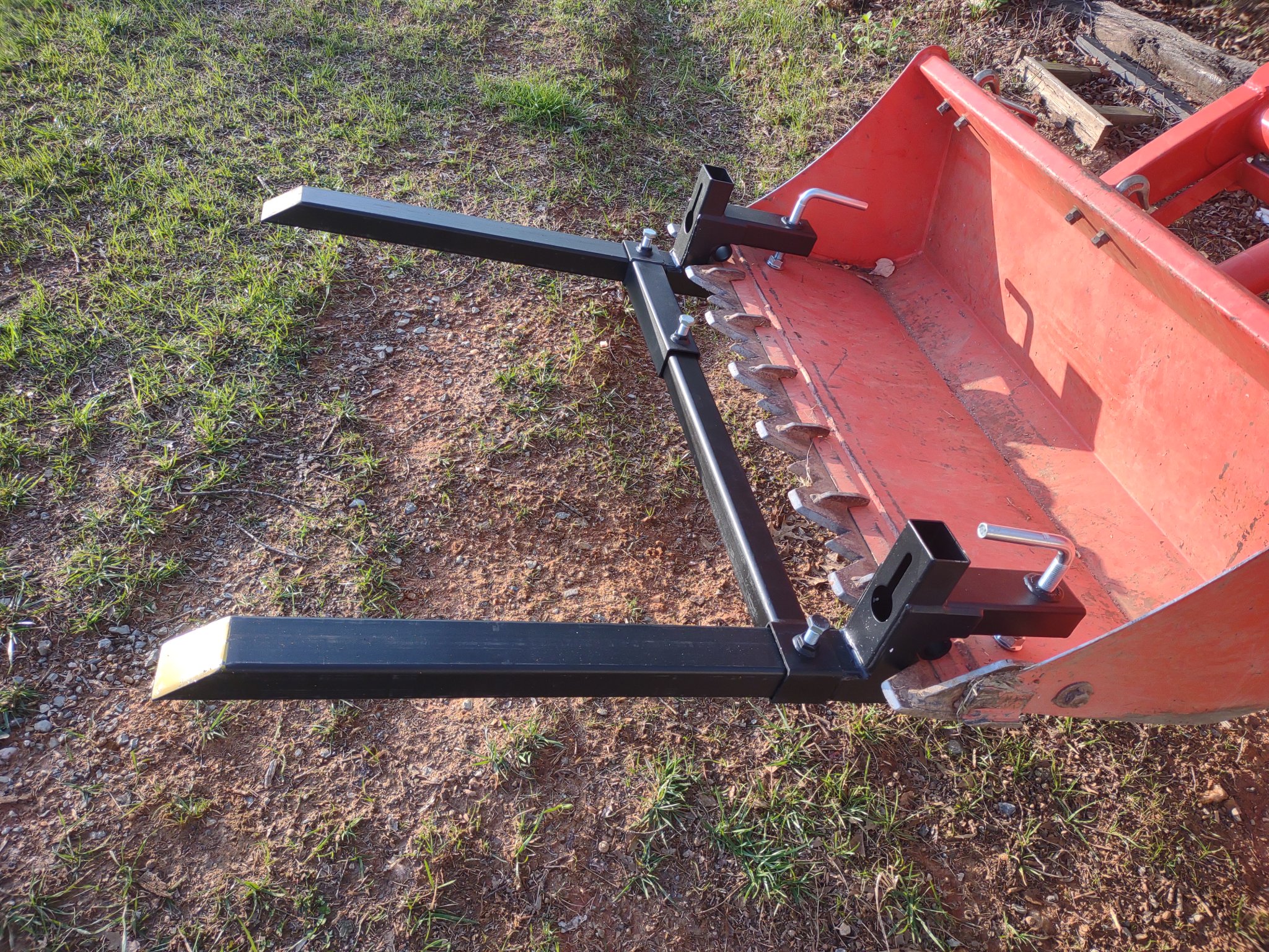

As for forks - I have the old style on my BX and I added forks - I did not want tight forks, so I did find they fit well near the outer limits of the bucket edge.

I take it you are comparing the "old" tooth bar to the newer style? IF so - I cannot imagine it being twice as good - the price is almost twice!!
It looks like there is enough room to move the forks inwards. Am I correct ? Thanks
Not really the "teeth" prevent the forks from sitting closer to the lip of the bucket.
