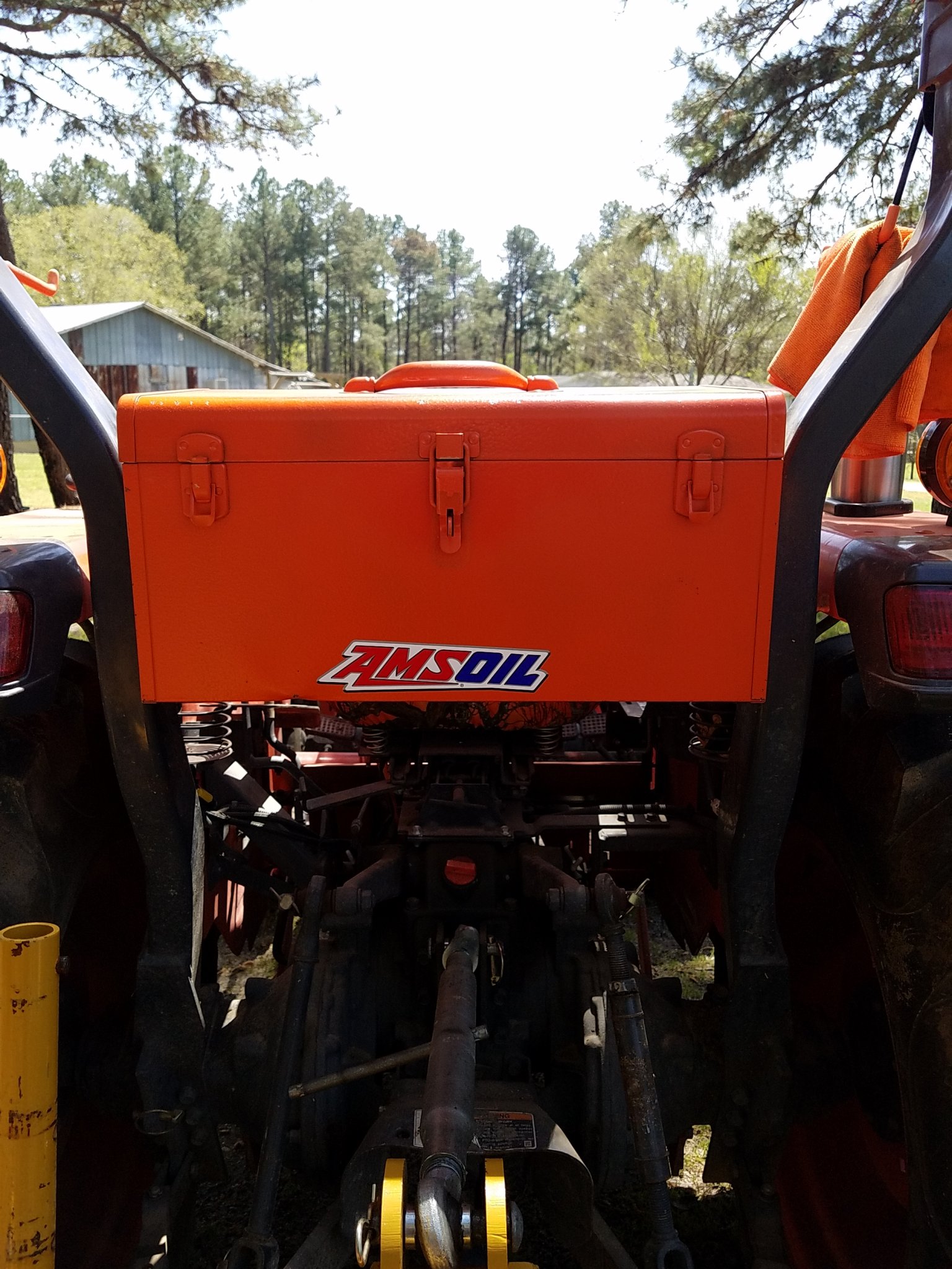

I had a nice size old Kennedy tool box I painted orange and mounted it. Drilled 3 holes through the tool box and the support that held the reflector, couple big washers on the inside of the tool box and done. It is great and holds plenty of stuff.
Only down side so far is when looking back when using my garden bedder in the garden it is little hard to see. If I were to raise it up 3 or 4 inches the line of sight would be plenty good.

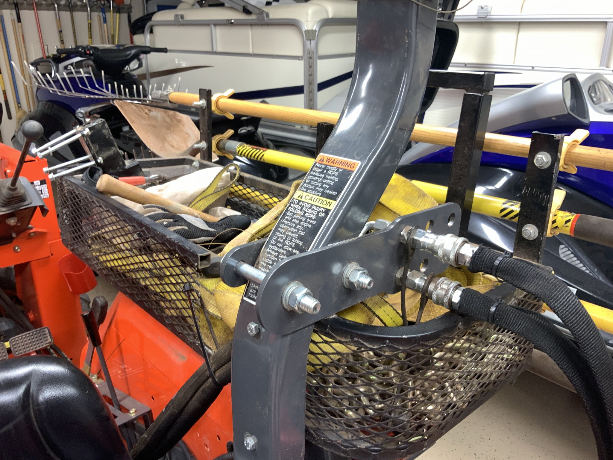

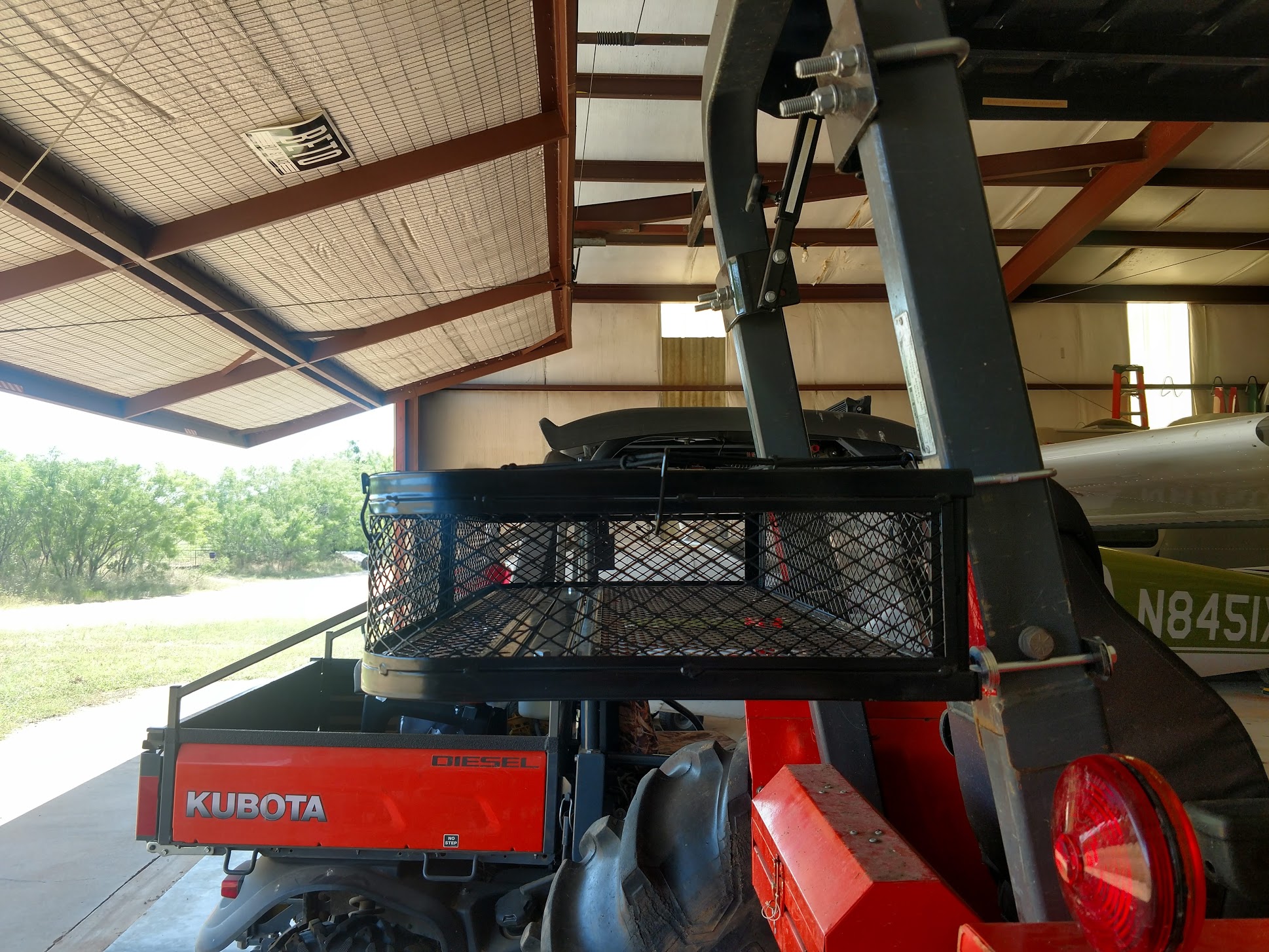

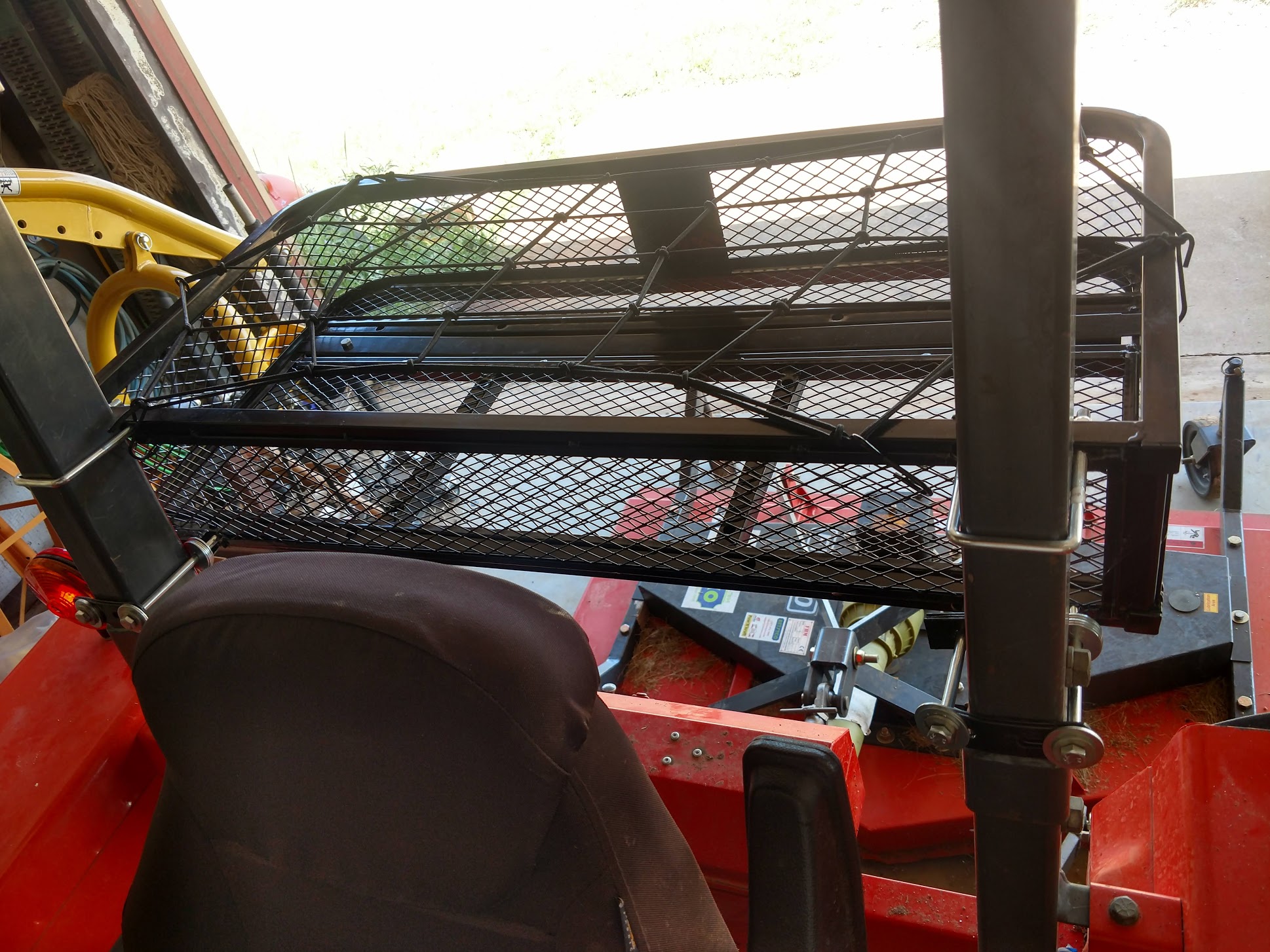

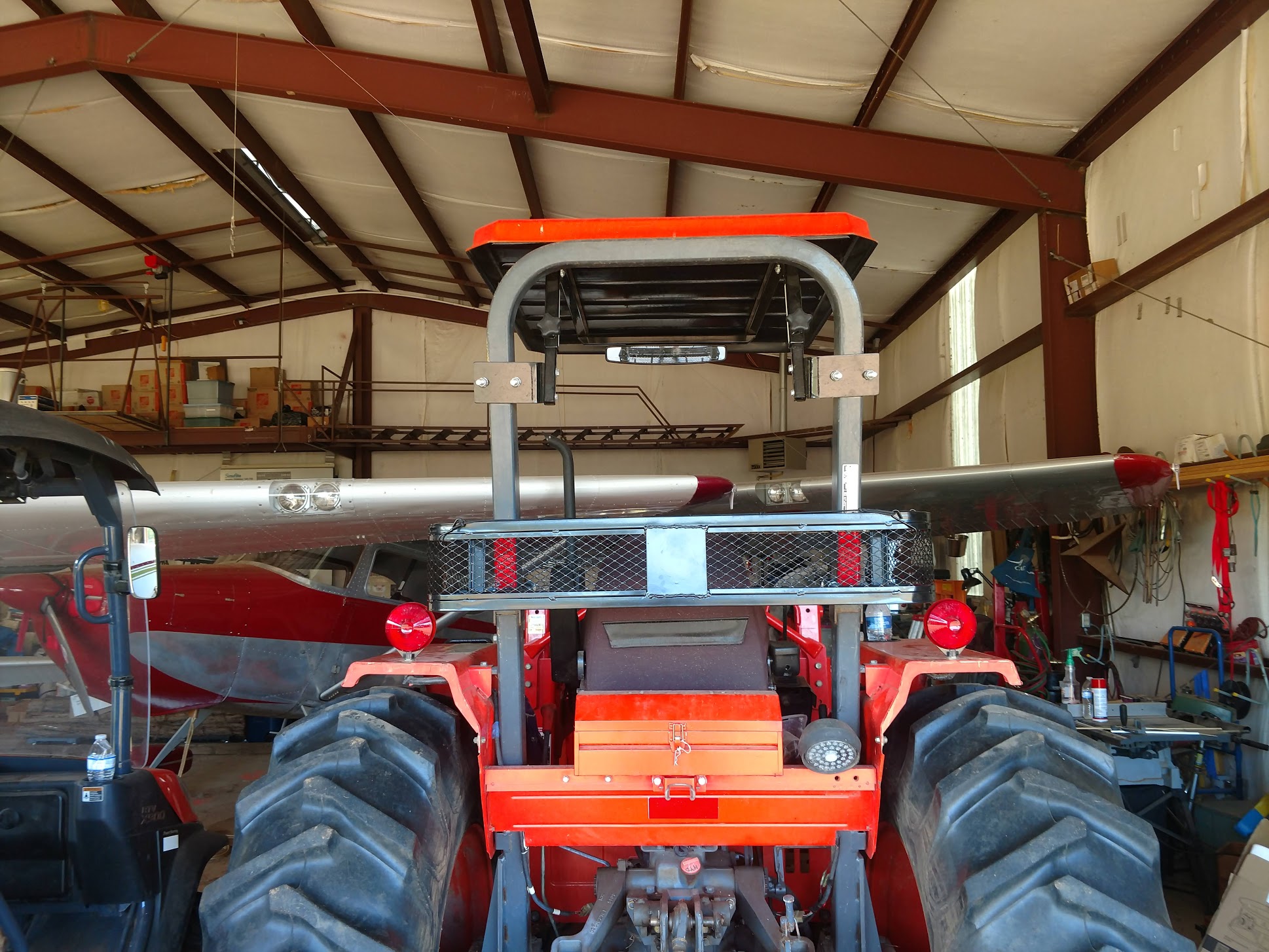

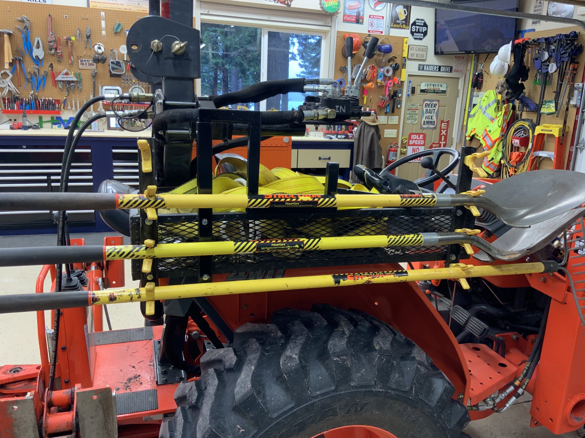

Mount an ATV front-basket on the ROPs and put your. Tools and/or toolbox in it.
It will do double-duty to prevent things from being tossed up from a shredder and into your back or back of your head. (if you look behind my seat you can see the ordinary steel mechanics toolbox I bought, painted orange, and mounted there also. I keep smaller tools like screwdrivers, wrenches, pliers, etc. in it. Larger stuff like Axe, bow-saw, crowbar,chain-saw, beer-cooler etc. are in the basket. A web-net made of bungee material from HF (which they call a motorcycle helmet net) has hooks on each corner is also depicted in these photos, and is something I have stretched across the top of the basket to keep things from bouncing out.... although that is overkill. Nothing has ever done that.). My triangle-SMV sign has a strong 3” round-magnet bolted on it, and it sticks to that flat, rectangular piece of steel in the middle of the aft view of the basket, for when/if I ever get out on a county road.)
That is awesome. I have the same basket on my Polaris Sportsman.

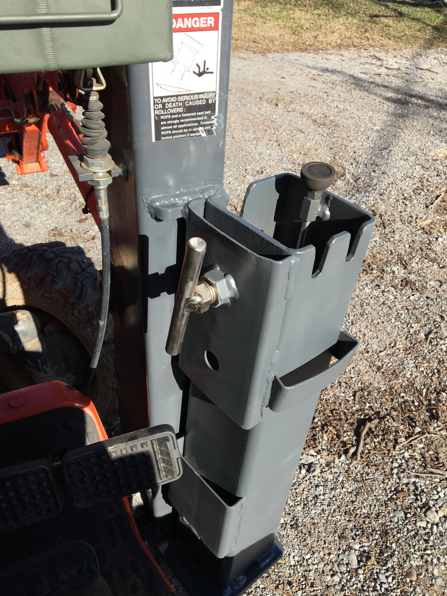

Square tubing has solved my chain, chainsaw and long tool carrying problem.
Orange, M59, 6x6” tubing bolted on. Lower skid plates added to protect hydraulics.
Gray, B26, 5x5” tubing welded on.

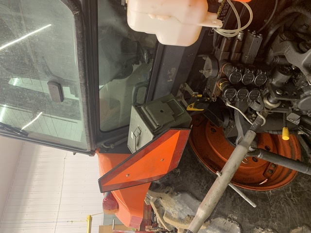

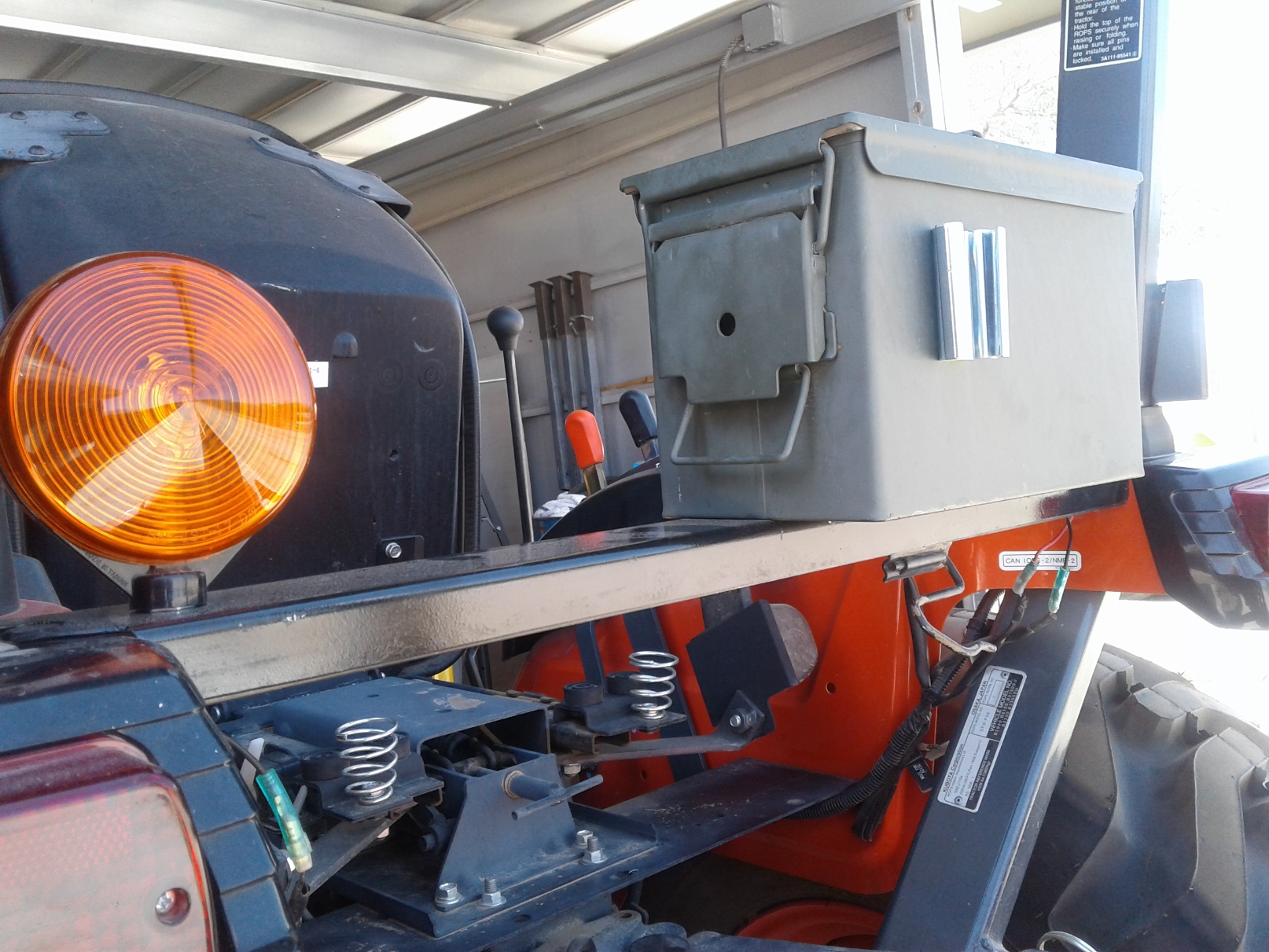

Not sure how this is gonna hold up, but I mounted an ammo can on the SMV sign bracket. Then added a SMV bracket for the sign. If I had one complaint.....one thing about inside the cab... hardly room for an adjustable wrench!

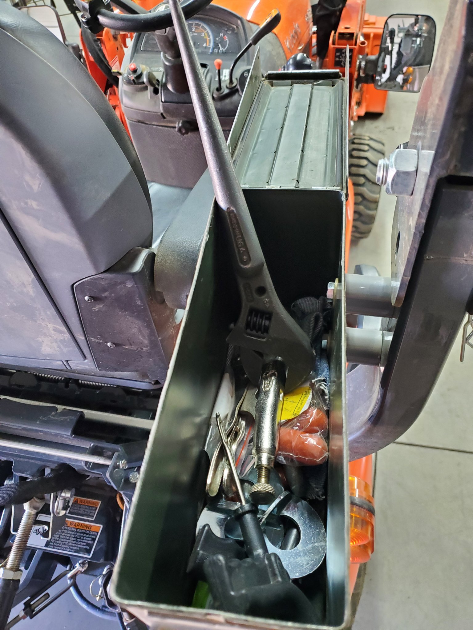

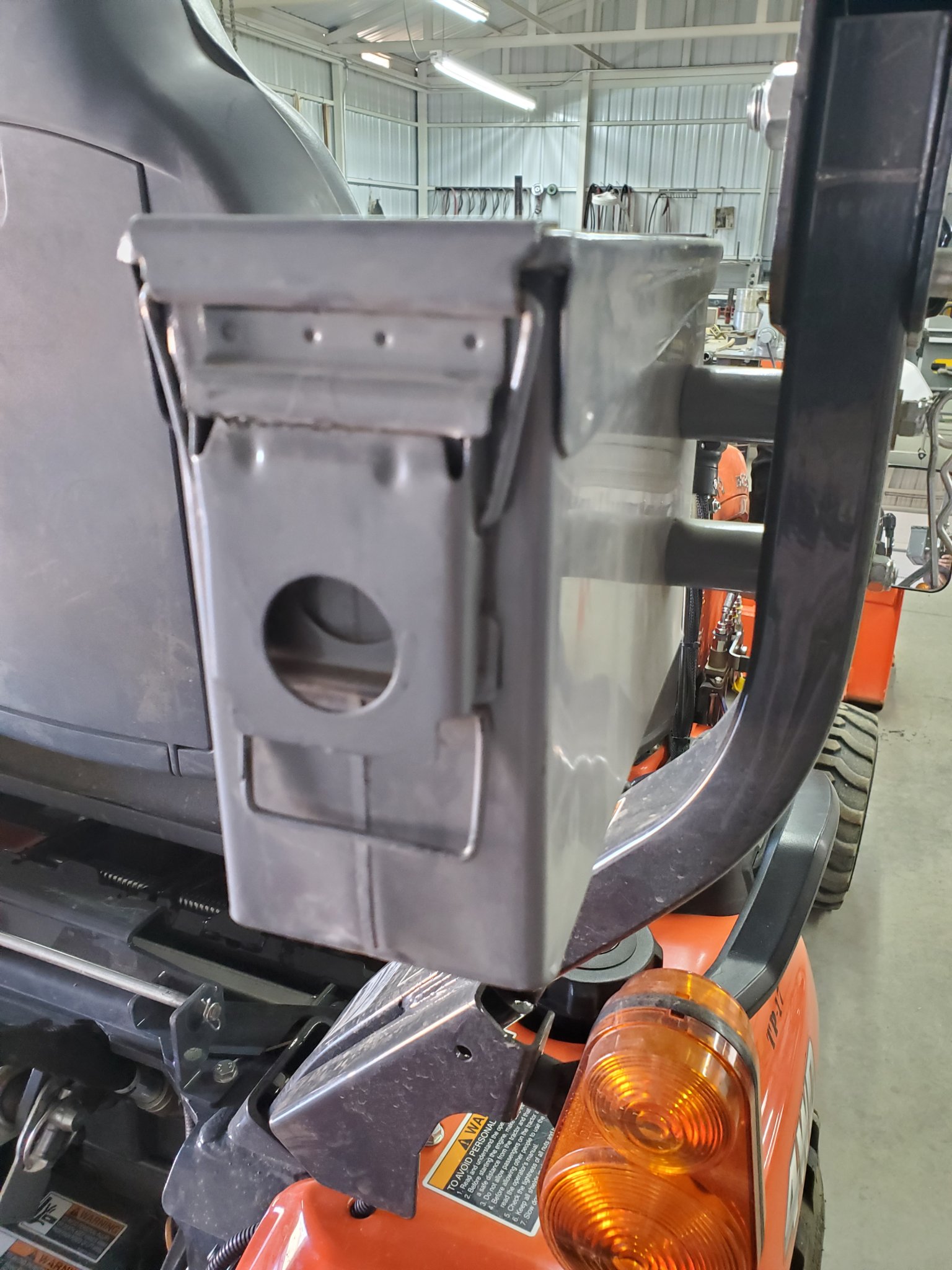

Just to add to the collection. I added a 5.56 ammo can (I'm on a BX23S) to the inside of ROPs in existing holes. Turned down some aluminum spacers & bolted straight through. A bit flexible as the smaller cans don't have beads rolled into the side so may add a plate to the inside.
