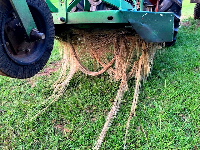

I feel your pain! Not wire, but a big bunch of 'hay string' (not seen in the grass until too late).
12,758
5,552
Agree with 'take it off and get it up high and safe ! 'book' yourself ALL day to do the job, use whatever 'cutters' you have, piece by piece by piece by.....

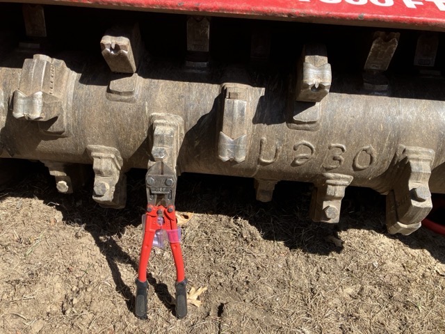

I recently removed fencing wire from the drum of a forestry head.
We discussed a angle grinder, which would have worked well but the location and time of year was not conducive to throwing lots of sparks. Last thing I needed was to deal with a wildfire or a burned up track loader.
The wire was too large in diameter to use a heavy duty side cutters, at least in my hands. I picked up a 14 inch bolt cutters which worked well. There was enough compound leverage that I could snip the wire right at the tip or anywhere else along the cutting edges.
I can say I was able to clip wires that was wound super tight right up against the drum without leaving a mark. I do not think that would have been possible or time efficient with the angle grinder and cut off wheel.
