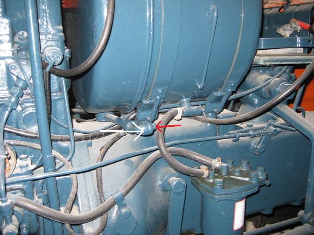

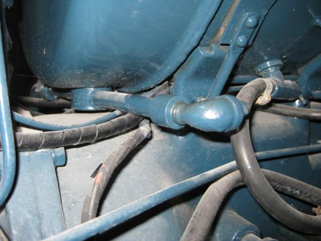

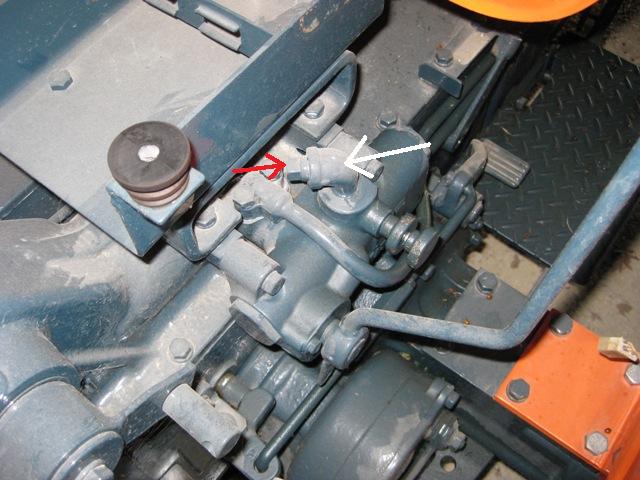

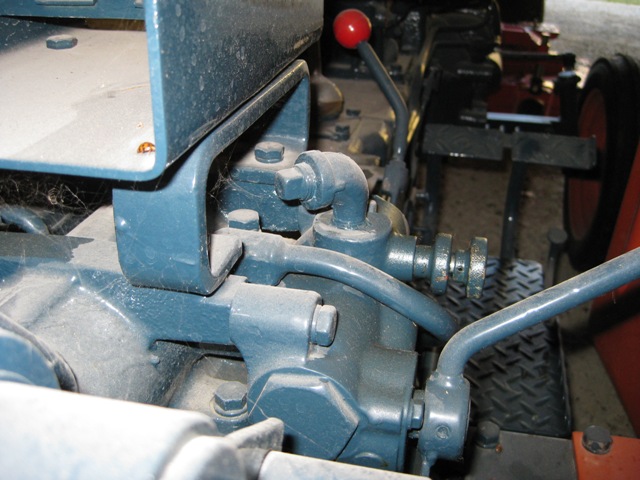

I removed a hyd. blade from my L210 during the restoration. The L200 was the predecessor to the L210 but other than some styling differences they are virtually the same tractor.
Here are some pictures of how it was tapped into the valve under the seat, and how the return was plummed directly back to the bottom of the tank. Who ever did it, just used regular galvanized street el's. I just used regular SAE threaded plugs to cap them off when I removed the hoses. I hope this helps.

Thanks L4740, that helps a lot! I haven't noticed whether the return pipe on mine extends to the left side of the frame like yours, under the tank... but I will check! Standard SAE fittings, eh? Hmm... I might have to take that plug out of the top of the valve tomorrow, and check it out!

Norm, I might add that the L210 was the first L series tractor to be exclusively sold in the USA. The L200 was sold here in the USA before the
L210, but was also sold in Japan. I don't know if this would have any bearing on what type of threads there may be on your hyd. valve. Also, all the work of adding the remote hyd. was done prior to me acquiring the tractor. I just removed them. And in my case, the standard pipe thread plugs screwed into the elbows. Good luck.

I checked my L200, and it has the same return pipe coming out from under the left side of the hydraulic tank... and it has a plug in it... (pictures soon) good news!
