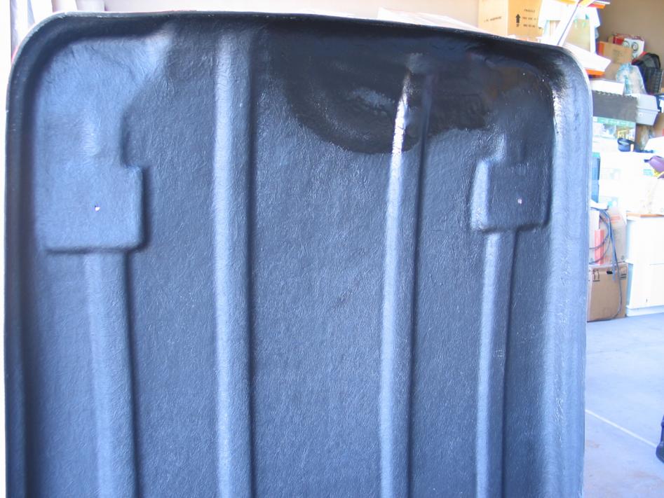

My tractor had seen a mobile home axle dropped on the roof and hood. The roof was cracked but I drove it that way for a year until I had time to repair it. The flexing over time spread the crack back further yet.
I called here in Phoenix where one of the subs that makes Kubota shades is situated. They have "repaired" lids for $350 plus shipping. New ones were $575. I spent $30 on resin and cloth and got mine repaired in a few days work. I found fiberglass work was actually kind of fun. Just be sure to wear a mask when sanding or grinding it.
The front edge was bashed and the roof was cracked 2/3 of the way to the rear...
I chucked the edging/moulding after the fiberglass work. To hide the repair, I shot the inside with plastic undercoating spray. Sure looks a lot better and its hasn't cracked in two years since repair.
