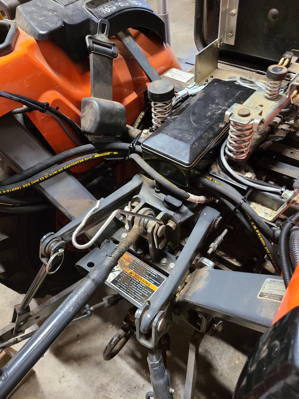

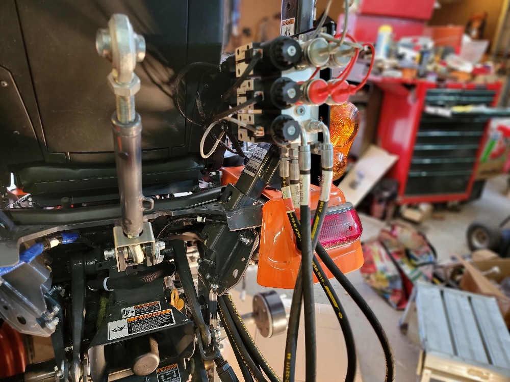

Pressure, third-function, and tank hose routing to the left side of the tractor:
The hose and wire harness routing and the valve manifold with a lot of background clutter:

Nice write up. just completed running my BX2380 and making sure no leaks per instruction after mounting rocker switch.
I also have narrow ROPES but in my case, I just ran a die over supplied bolt. Thank goodness they attach a PDF file. There was a few other questionable order of operation, but like I keep hearing from a few and realizing it is a DIY kit. and chewing gum and driving nail at same time is required that was an attempt at humor)
I agree they are generous (over on BX) with hose length. On my project just have to do wiring in a way that I can accept and be switched. and figure what to do with this extra hose and not possibly come in contact with my three point.

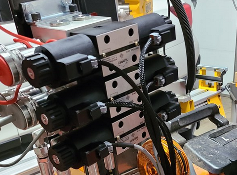

You can unscrew the dust covers on the valves and turn the female electric connections 180 degrees to get the wiring connectors on the inside to tame the wiring on the manifold a little bit if you want:
The wiring is tricky. I was fortunate that my B2320 had the unused, switched bullet connectors under the right-rear taillight. Maybe your B has the same?
I changed one on the bench before mounting manifold, but thought I'd wait until after mounting system on Ropes. Not sure if it will clear coupler, I'll give it a try. I was thinking just one end. It would all depend how my wire placement goes.
