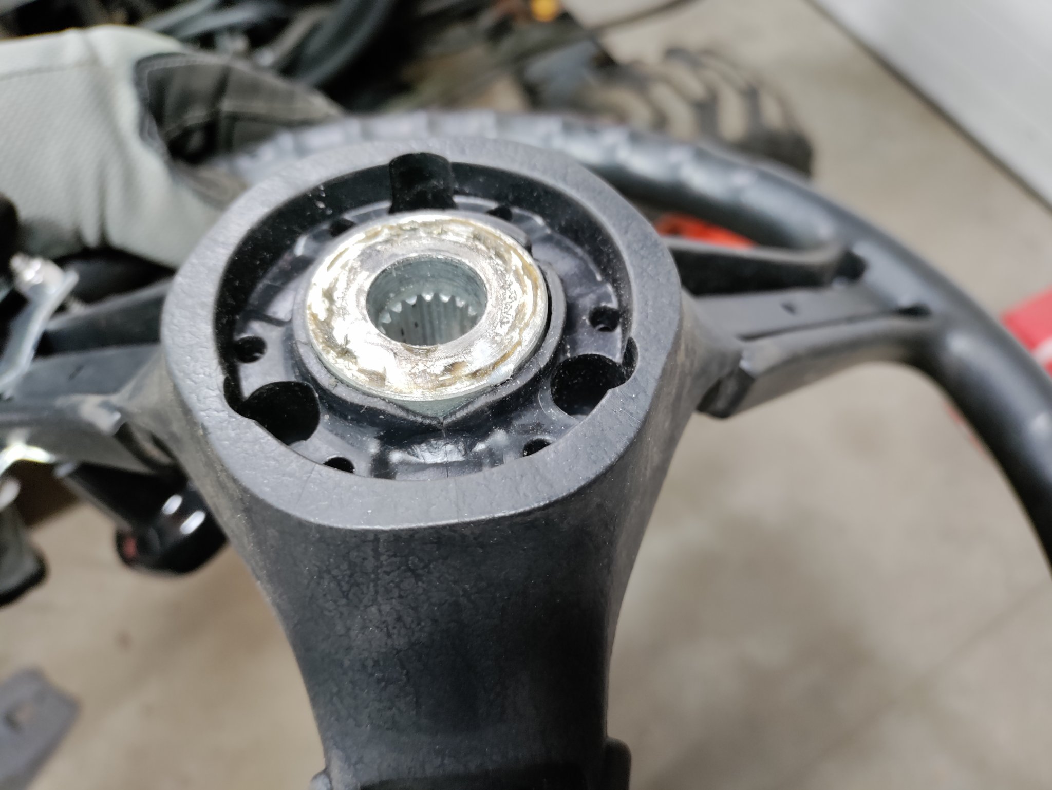

I went through this myself recently. I already had a power steering pump pulley puller (PSPPP for short) and it turned out to work perfectly.
I used a hose clamp to hold the two halves of the PSPPP together (without the outer ring) snug but not too tight on the steering shaft. I then set my 2-jaw puller to pull against the PSPPP and it popped right off.
Pictures explain it a whole lot better than words.
