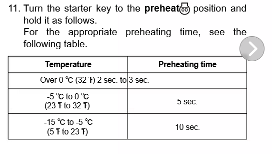

Glow to a diesel is like coffee to a human - more is typically better when both are cold.
I would glow even more than 10 seconds. The air and head and cylinder will absorb that heat and it will allow the fuel to ignite much quicker and with less start up smoke.
Even a 30 second glow is fine - depending on battery and how cold everything is.
