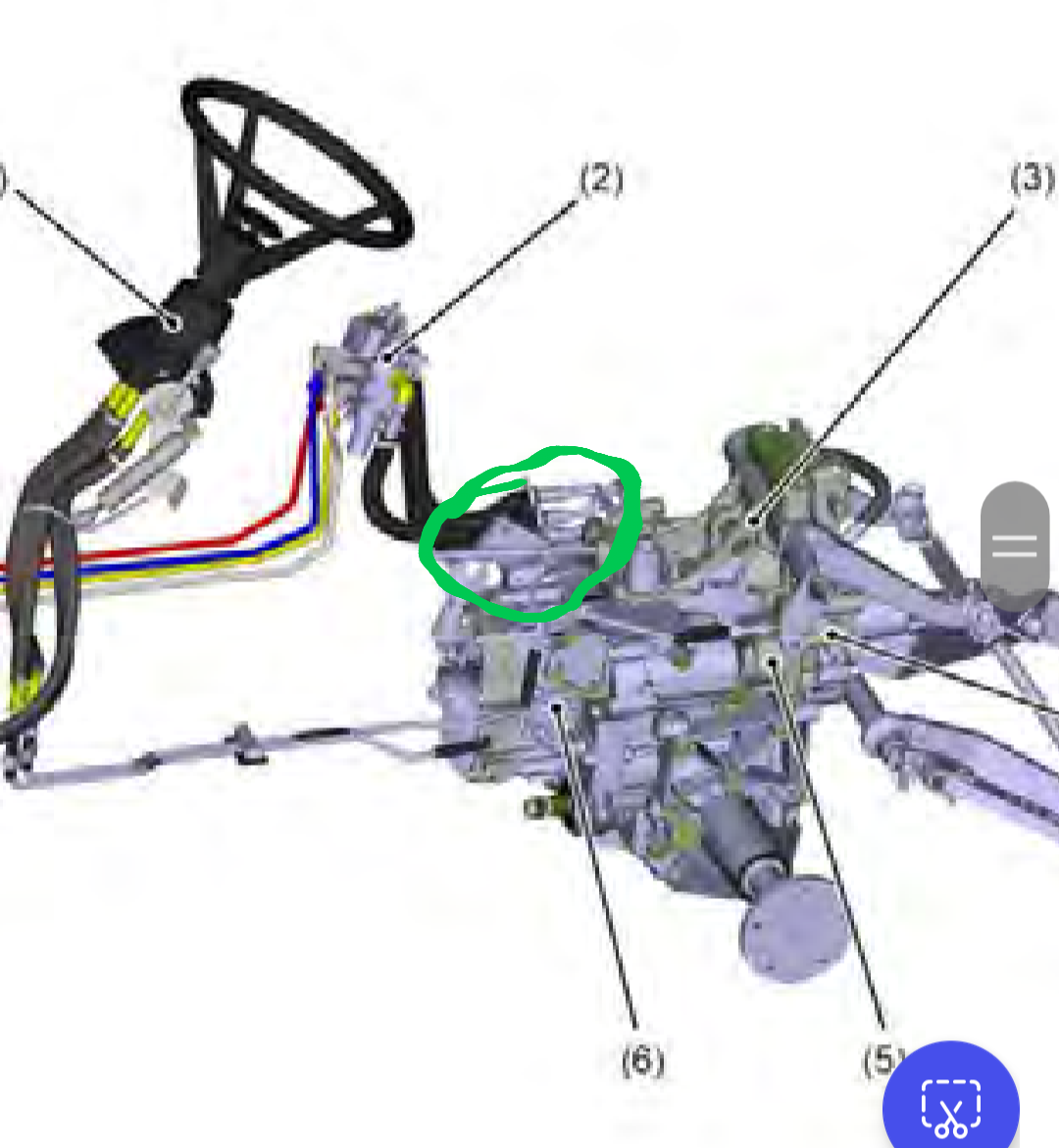

Is there a way for him to disconnect the PB (hose, hopefully) at the 3ph and put it in the bucket and see if it works?
Yes but not in a bucket - it needs to go in the hydraulic filler. As soon as the tractor is started oil is going to be flowing through the power beyond hose non- stop and would pump the tractor dry PDQ if its not returning to sump.
I think all that will do is confirm what we already suspect. The loader valve is fine - the path back to tank inside the tractor is not.

According to the WSM (chapter7 -2 ), oil flows 1st to the loader valves then to the 3PH valve. Since 'bucket' functions, it's not a 3PH issue.
I'd still like visual confirmation that the joystick is connected and moves the loader lift valve fully in and out.

Yes we would but only for about 2 minutes....
Go read post #16 - I think its germane just dont know how.
Has the 3ph operation been confirmed? If it goes up, PB flow has to be moving. If so, I think he hit on something in post #4, the loader valve/linkage got messed up when he tried float.

That was my guess. It all happened after using float. But the loader went up fine with the hose to the cylinder disconnected! So the linkage is fine????

Read more carefully expeciakly the detsiled description of individual functions.
When bucket spool is shifted exhaust oil from bucket does not go to 3pt - it goes straight to tank via tank port on vslve.
When lift spool is shifted exhaust oil does not go to tank pory. It goes to powet beyond port and 3pt vslve, through the 3pt valve, and then to tank. If that 3pt valve is not in neutral the loader lift function will be blocked.
This is standard Kubota design and a regular problem with all current Kubota loaders. I have probably helpef half a dozen people experiencing some variant of this ptoblem in the past two weeks. Should be a FAQ.
8,196
4,126
Yes the linkage is fine and the spool is being shifted. . If you really think float has caused an arcane internal malfunction in the loader valve we can easily test it by disconnecting power beyond hose on the loader valve and re-routing it straight to tank. Break out the wrenches and some bandaids for cuts and scraped knuckles.

Can you discern when the relief valve is relieving? You should hear it when the bucket curl reaches its stop, but not when no hydraulics are being used.
Yours is located under the seat, I believe.

I am familiar with the sound the relief valve makes. When no hyd are being used I do not hear the relief valve

Don't think that's necessary. Not yet, anyway. If his 3ph is working, he's bound to be getting PB through the loader valve, right?

He has a pressure gauge. A pressure measurement at backhoe connection and all valves in neutral will definitively tell us if PB is blocked or not. It wont tell us where.

I domt doubt he is getting PB from the loader valve. In fact I am pretty sure he is. The 3pt valve is my concern. Looking at the parts diagram the spool is not s rigid connection to the lever. Possible the lever is in neutral but the spool is stuck in a shifted position ????

We know the lift spool is working. As soon as we disconnect the rod end hose and let it dump into a bucket up she goes.. Its not a joystick linkage problem.
Do you have sny insight into how the 3pt vslve works. Clearly not position control.
The BX has a quarter inching valve for the 3ph. Lift the lever up, the 3ph goes up until you let go the lever. Push the lever down, the 3ph goes down until you let go the lever. When the lever is in the middle nothing happens. It's a pretty simple setup, not too much could go wrong I suspect.
Is it possible there's some grot in the pipework somewhere between the quick connect coupler and the tank? That would block flow. Or a bend or crimp in the pipe I guess.
A float valve is supposed to open the circuit (both ways), right? If the float valve was jammed I don't see how that stops oil returning to the tank.
