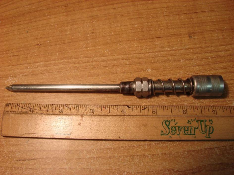

As others said. Use a socket to drive the new fitting on. Some nipples aren't threaded. There just press on.
One of the problems with using those grease guns if the nipple of the gun has to good of a grip on the fitting and it pulls them out. What you should do is use a needle attachment to go into your gun and when you grease those nipples you;ll just be placing the needle into the middle of the grease nipple and there's no danger of pulling them off. If you haven't seen those type of needles I'll post a picture of one tomorrow if you like.

Anyway here's the fitting I was talking about. It's a needle and it fits right over the grease fitting of the gun. If you need to grease a hard to get at u-joint this is the baby to use. In the case of your blowers fittings you won't end up pulling them off with this tool. It's less than $10. to buy around here and it's worth it.

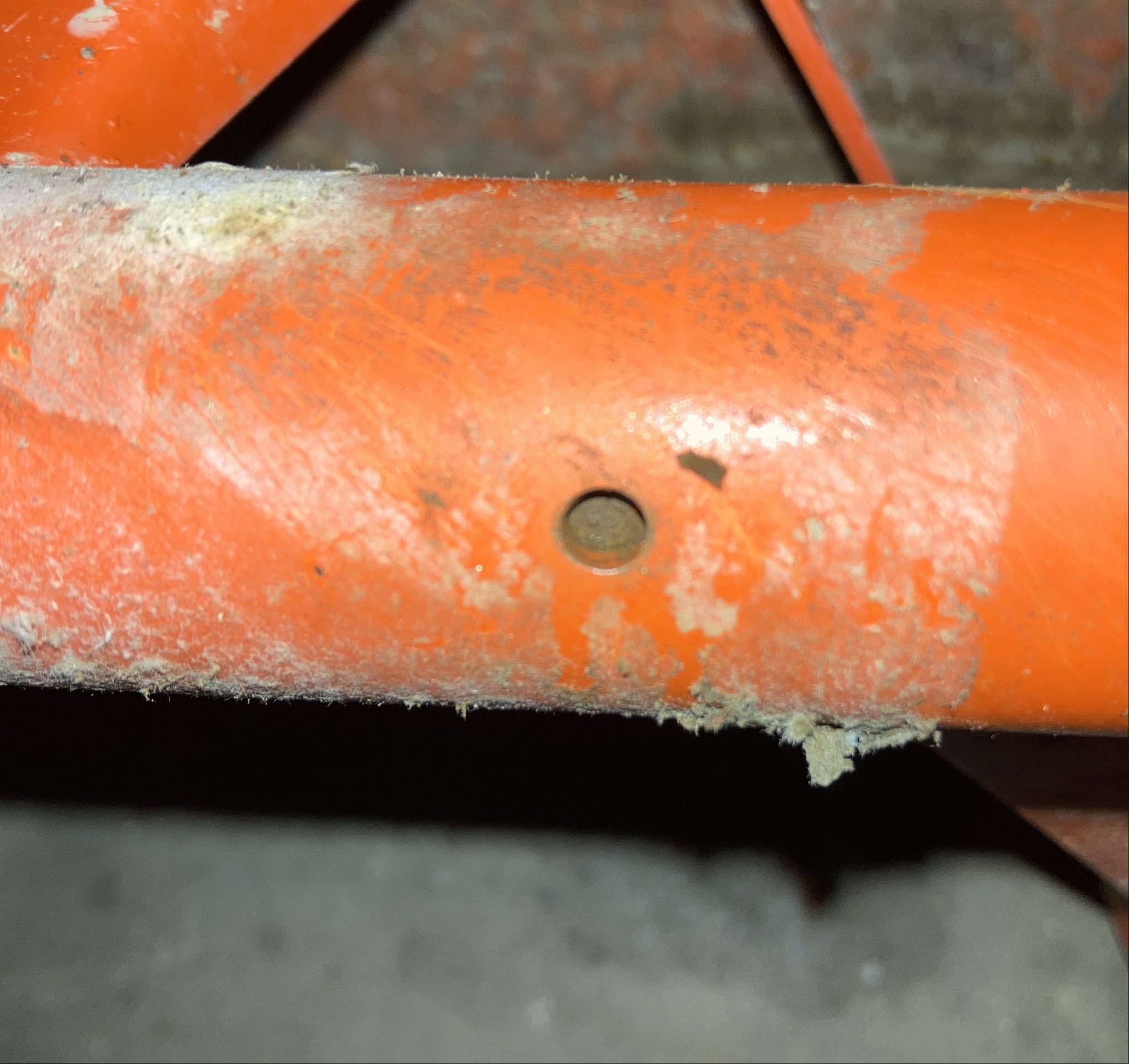

Does any one have a part number for this fitting. I have gone onto many Kubota web sites and they all list the wrong fitting for a BX2750 snow blower. I even went to the dealer, bought the listed part, far from being able to fit even though it's threaded. Can any one help with the press on Kubota zerk part number?
Did you ever find the part number for this, or at least figure out the size? I've got a BX2750C that has no zerk fittings on the auger. Looks like I need the drive in/pressure kind. Part number says a 1/4"-28 but that is much bigger than the hole.
Any help would be appreciated!
