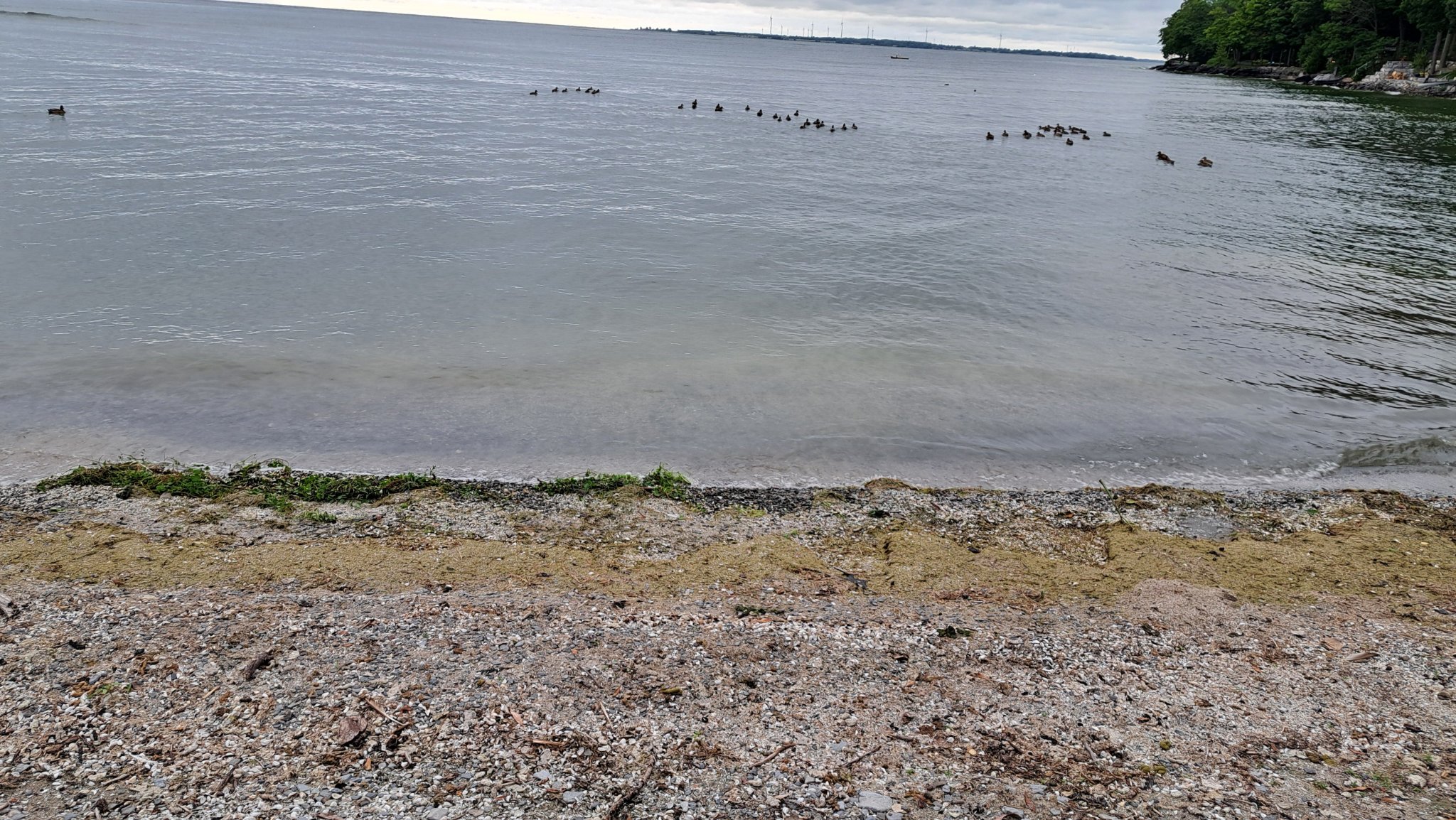

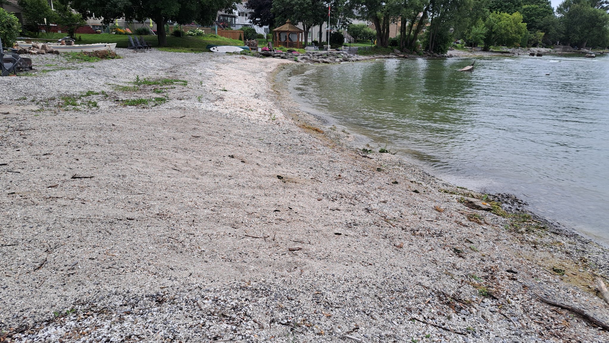

Hi all,

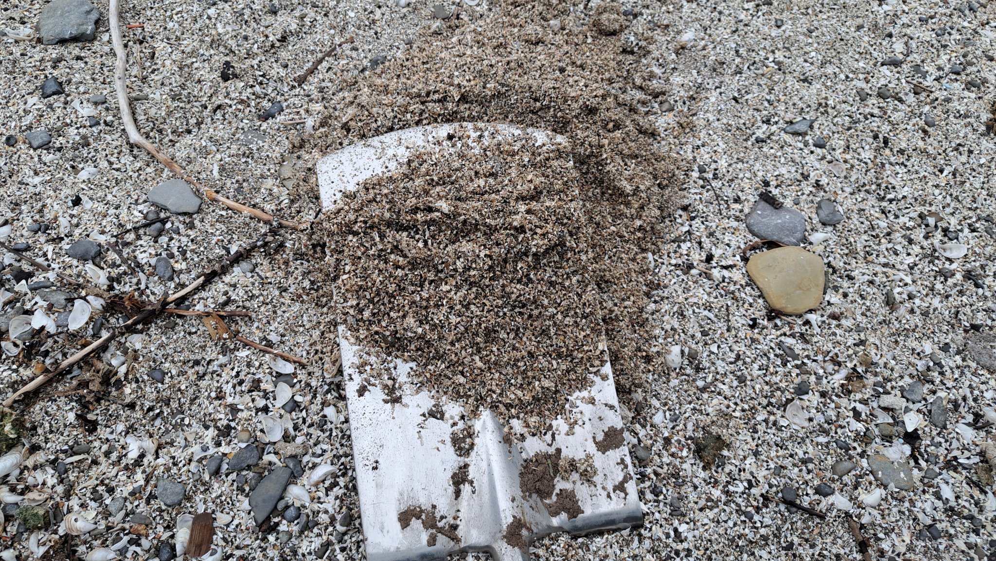

I would like to get a machine to maintain this beach that is about 1/2 acre. The initial job is to dig down the upper half of the beach 12" and drag it back towards the water. After that gets done I need to drag it every couple months to kill weeds from growing. The material is zebra muscles and they are kind of like coarse sand after they get broken down by the waves.
What would be a safe small hydrostatic machine to do this relatively efficiently? My access limits to me 48" wide across the widest part of the machine less implements. I can get to the water through neighbouring properties with an 8' wide machine but would like to use my access.
Cheers, Steve

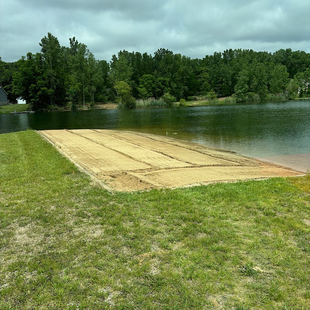

I would agree a BX machine with a landscape rake for moving the "sand", and then a land plane/grading scraper to flatten it, and maybe even a chain harrow to give it a bit of a finished look. The harrow will only disturb the top few inches.
The turfs would be your best bet, but R14's would be another option for tires.
