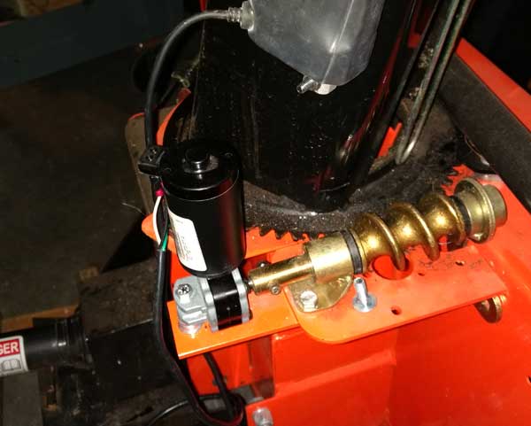

Does not take much torque to turn the chute. Too much torque and you could damage the worm or chute gear at end of rotation.
I will second the simple 12 volt motor. Adapted a surplus seat adjuster motor for my chute rotate.
Then a joystick on the control lever to control both the chute rotation motor and height linear actuator. The blower lift and chute controls are all in one place.

I haven't had good luck with electric motors. When the ice builds up, the motors stall. Also if you don't get a fast enough motor it takes a long time to turn the chute ( and I am not a patient man). I am looking to convert to hydraulic.
