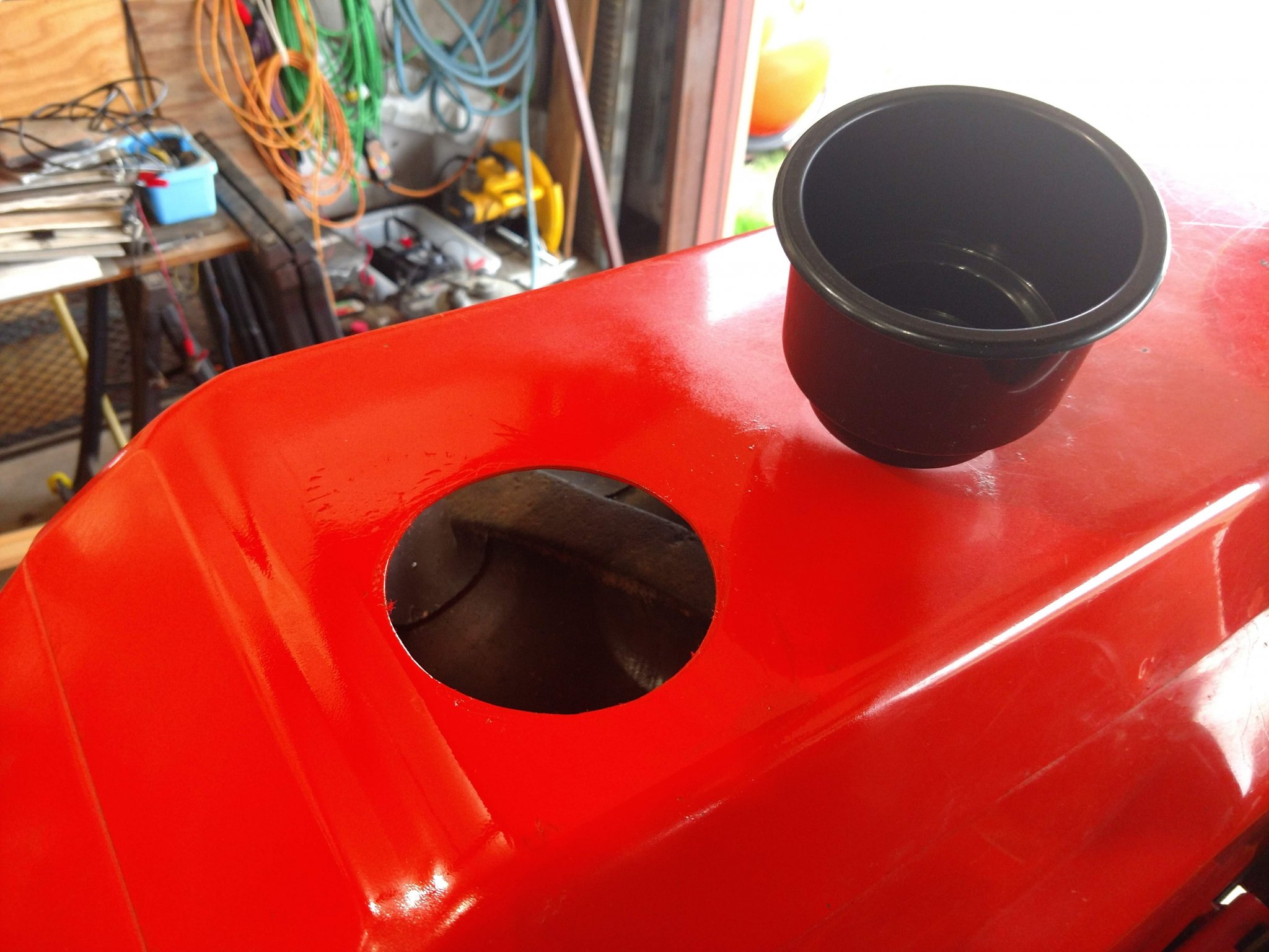

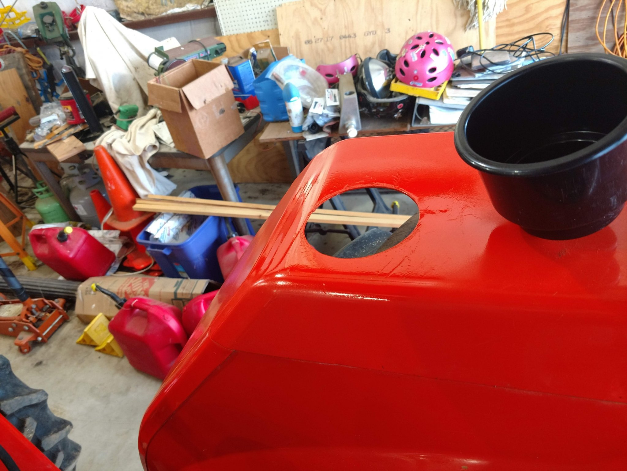

I agree that it’s an oversight for K to forget about cupholders. I used a 1/8” drill bit and drilled a circle of little holes I’d drawn around the base of a marine cup holder in the fender …. then a hack saw blade to cut-out the circle…. smoothed it with a file…. painted it with Rustoleum rattle-can Kubota Orange…and stuck a marine cup holder in the hole…

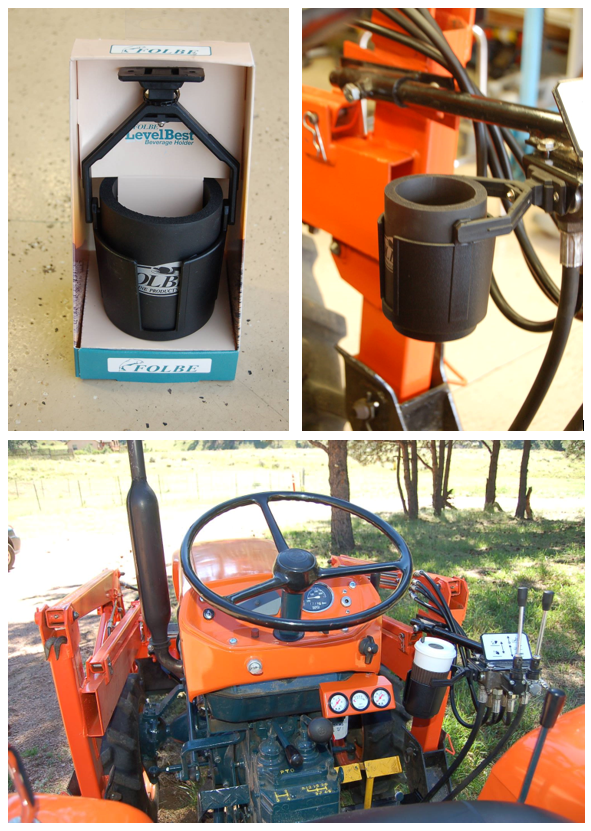

When I bought mine, the previous owner had installed one of these on the FEL controller. I was constantly banging my leg or knee on it, so i took it off.

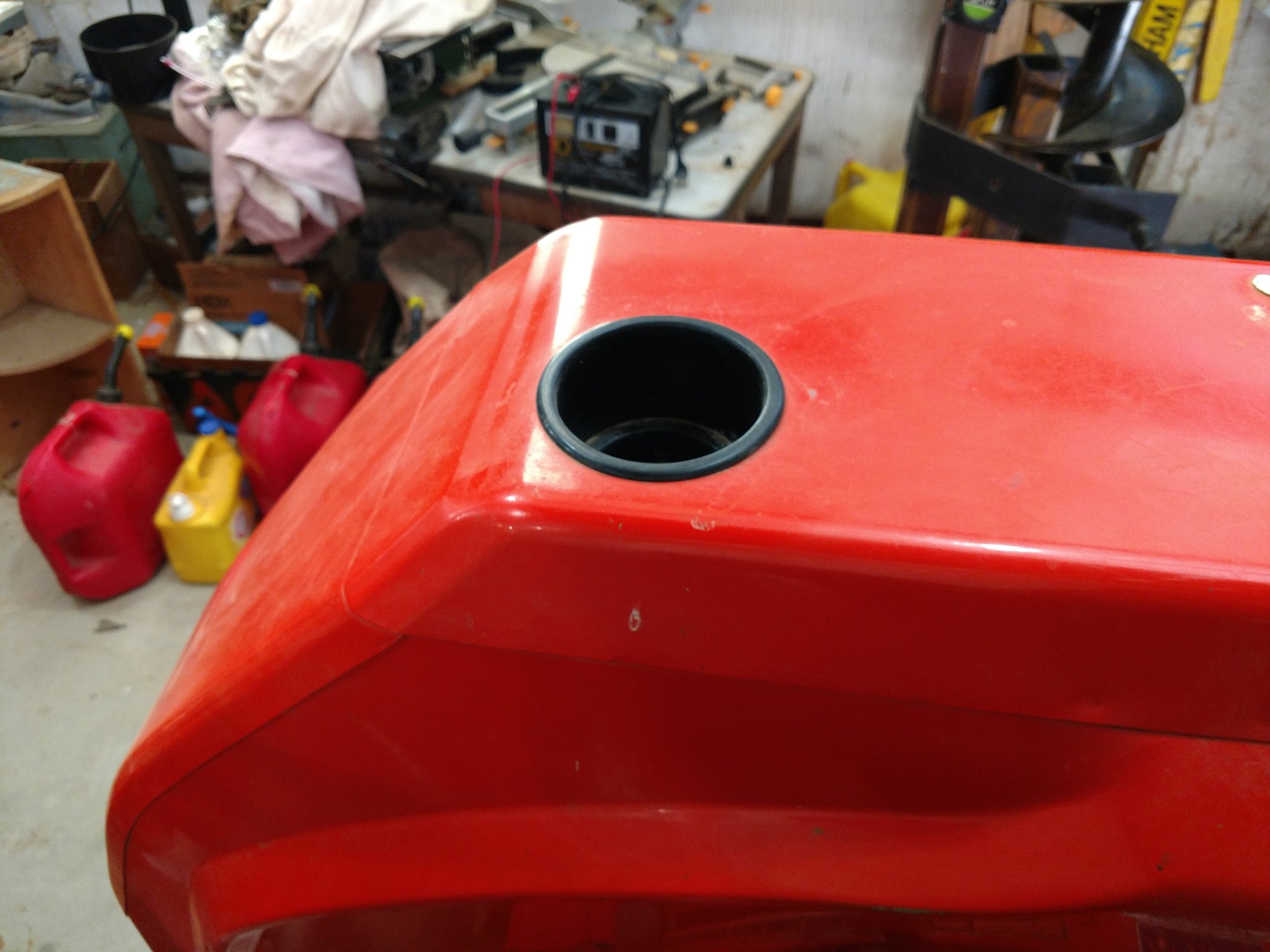

B7100 - boat cup holder

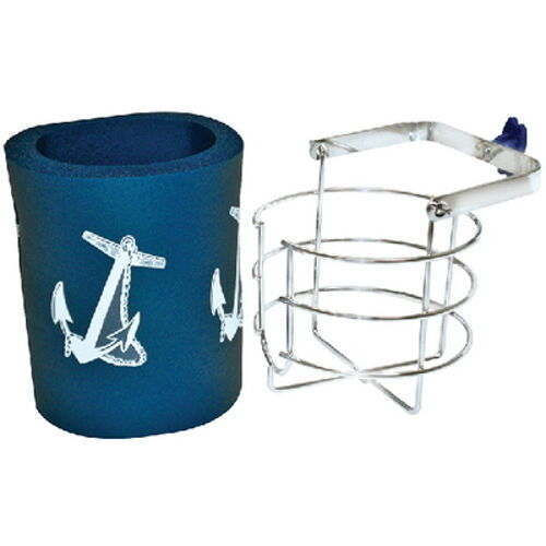

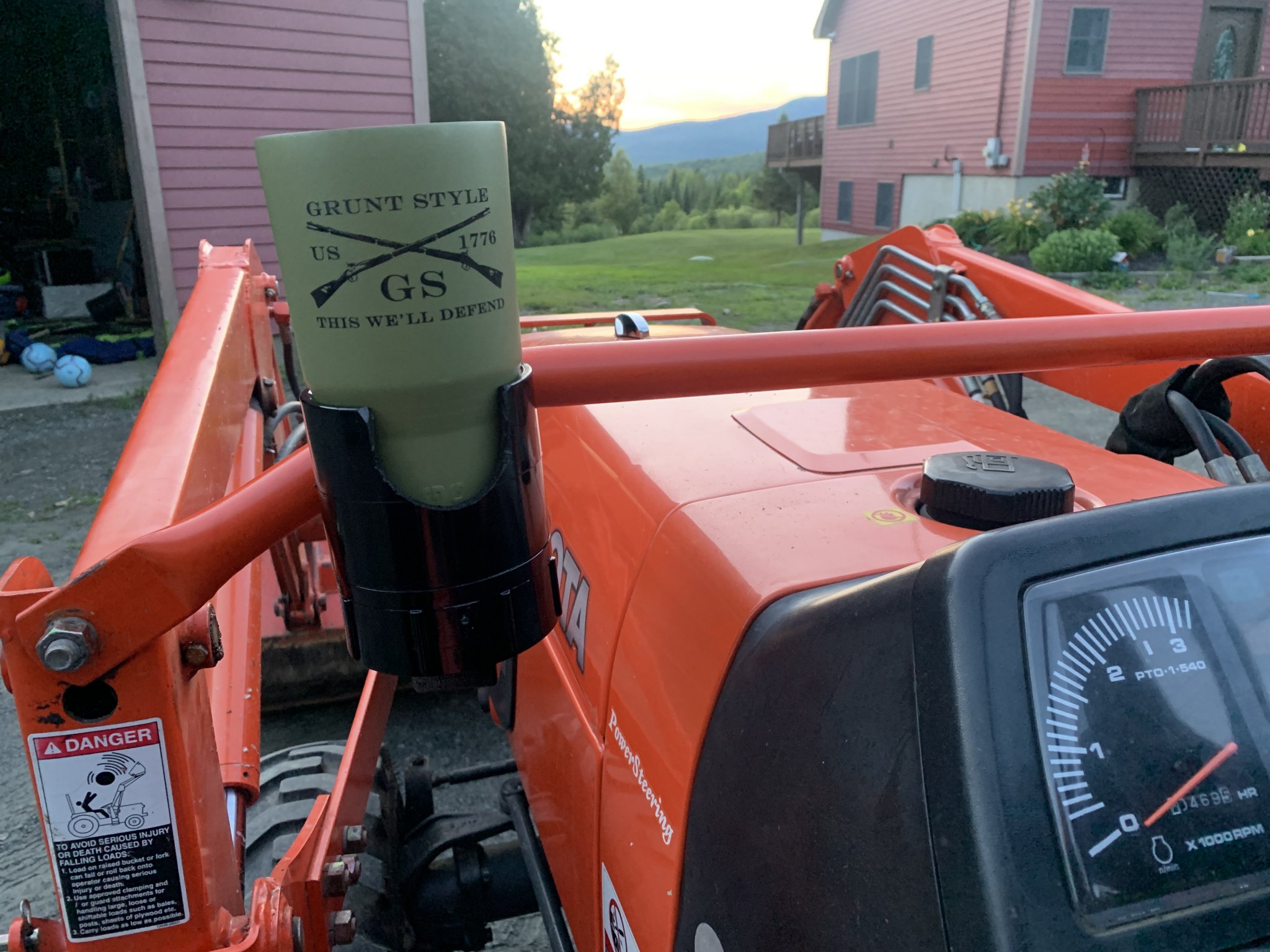

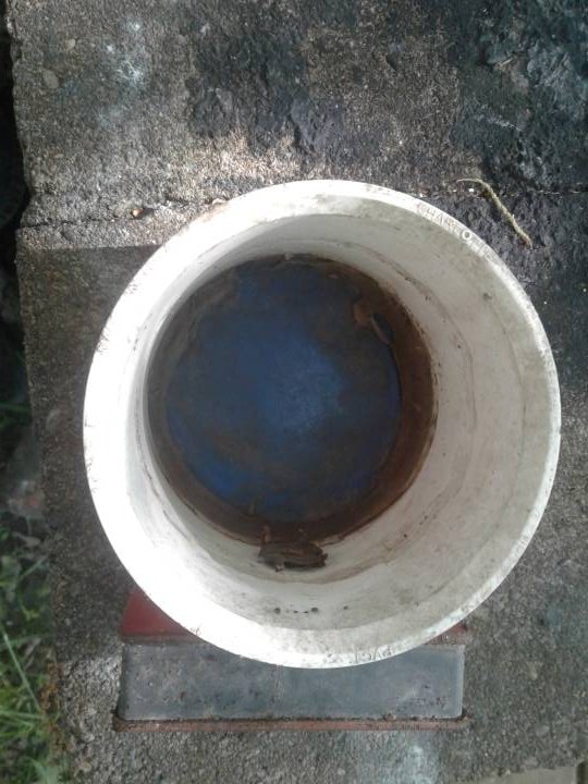

Attached to the cross bar on my B7800 the previous owner had a handle there. I needed water over the handle. Just used a 3inch PVC coupler glued to a PVC clean out. Drilled a drain hole in the square clean out and counter sunk my bolt as to not be in the way. Now I have my 32oz Yeti for long days bush hogging.
