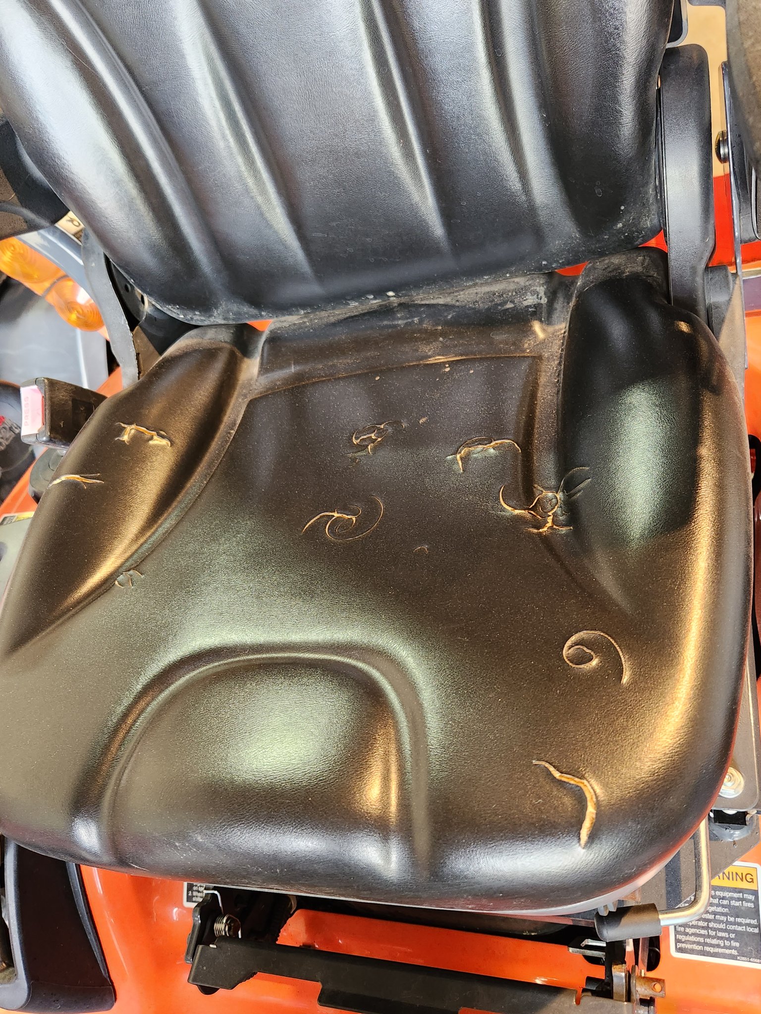

I let my son borrow the tractor, Kubota BX25DLB, and it survived a hail storm, except for the seat. In looking for a seat replacement, all I can find is a new seat, listed at over $1300.00. The seat is ok, except for the bottom. Does anyone know where I can get just the bottom? It looks like it is removable but I can't find it. The seat from the drawings is K2751-41123 (old number K2771-41120) Any help would certainly be appreciated. I like the seat it is comfortable, but hate to spend lots of $$$ for a new one when just the bottom is bad. Thanks again! Seat Picture.jpg

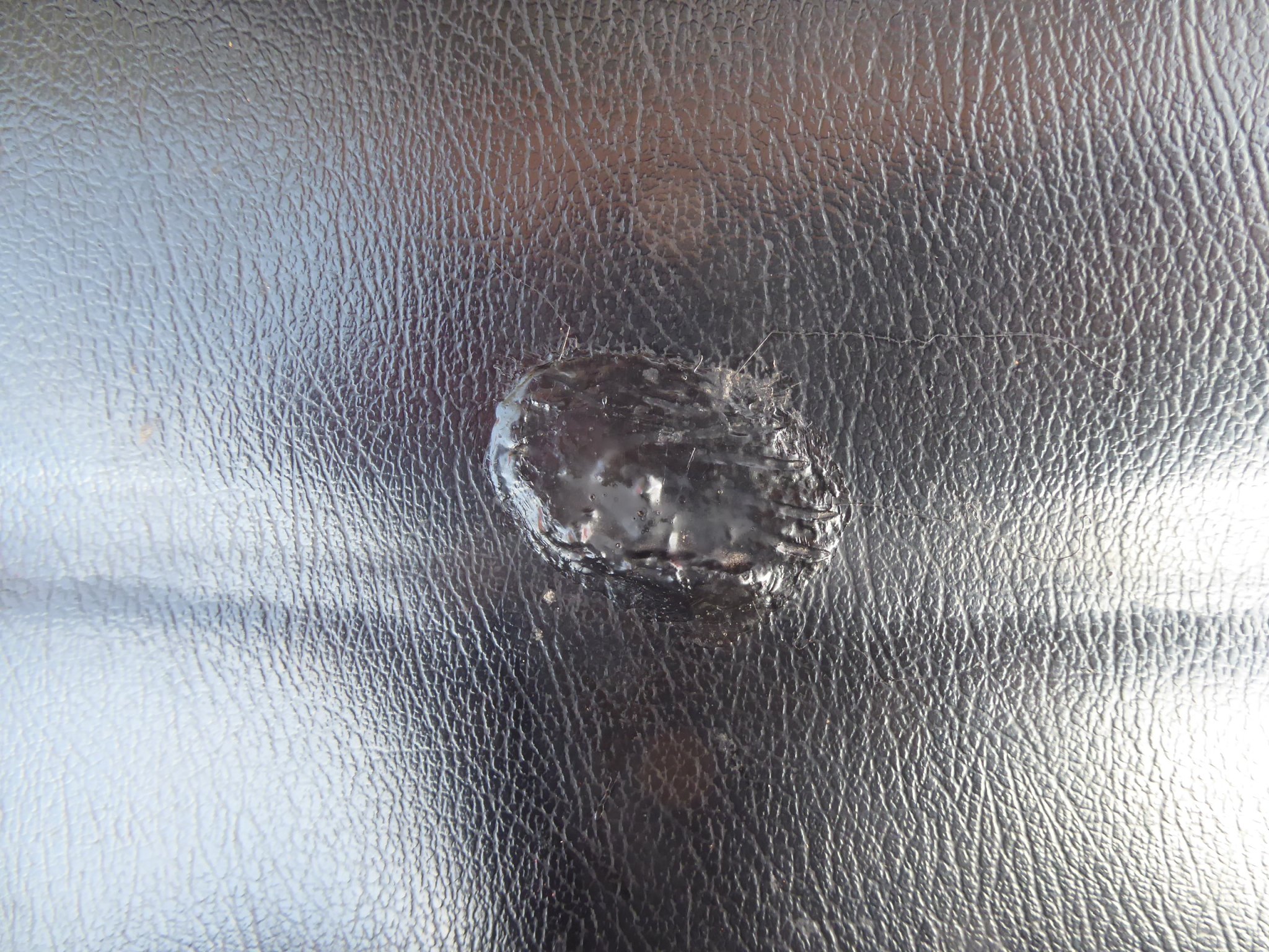

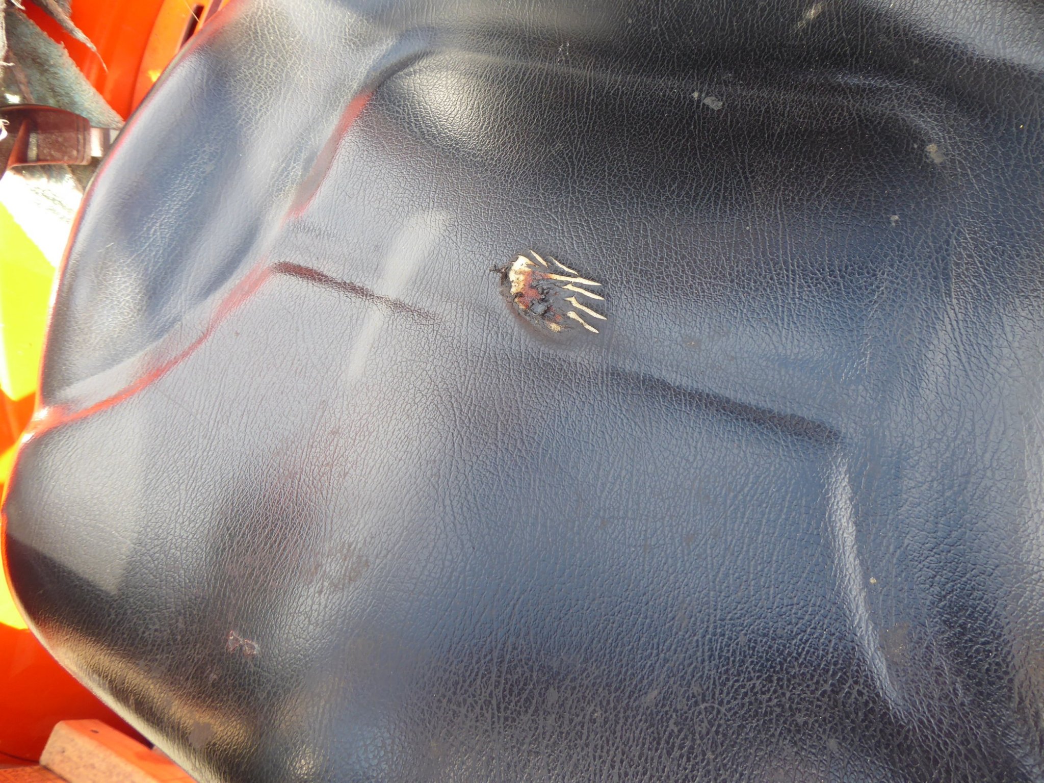

Two years ago I was welding over head and some hot weld dropped on my seat. Forgot to wet down my cover sheets - Duh.
Anyway, I just wanted to keep the injury from growing. Going against much advise in favor of more complicated repairs, I just put several coats of Liquid Electrical Tape from Home Despot on it. I use the tractor summer and winter and have to place my knee on the hole when I take my tarp cover on and off. The repair has held up fine and looks the same as it did two years ago.
This might help ???

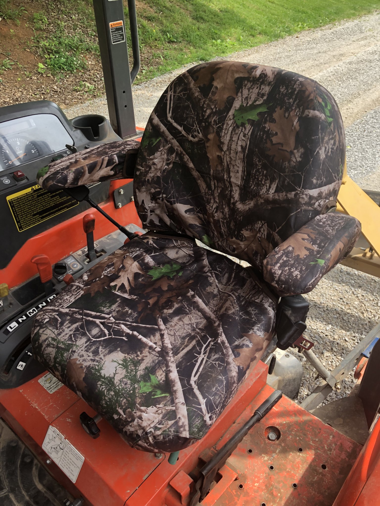

Durafit covers fit tight,
are inexpensive, tuff and nice upgrade to vinyl.

Thanks so much to everyone for their solutions! I think I covered them all. The BX1880 seat does not cross. I used the liquid electrical tape on the holes in the seat to keep the water out of the interior. I checked with Tractorseats.com (good site) but they had no replacement available and I purchased a Durafit cover (in Kubota Orange) during the Labor Day sale and got some $$$ off.
