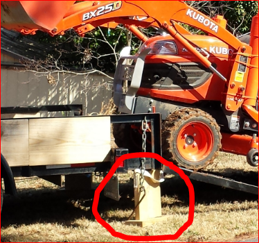

One thing I will add - when loading on a trailer, build some compression blocks to place on either side of the drop down gate. I made a pair out of 2x10's like an upside down T, they has been going on 15 years, worn but still usable. Most "newer" trailers have them installed with a drop down leg.
The guy who delivered my BX25D in 2013 did it on a single axle - I was shocked and sure enough when he backed it down HIS TRUCK's rear end came off the ground.

Note to self: Make sure you leave enough gap between the compression block and trailer frame to account for the "sag" of the trailer when loaded. ....Hahahha......If not, you will "trap" the compression block and have to unload your tractor to get it out......Ask me how I know this......:D

I use jackstands under the back of the trailer and block the trailer wheels when loading. Nothing odd there.
I also carry a jack tall enough to reach the back of the trailer so I don’t have to unload if I mess up and trap the jackstands with the loaded trailer squat (like that would ever happen 🙂). And since I’m generally towing with a 4WD pickup I put it in 4WD when loading as a backup just so it won’t freewheel if everything fails and the back of the truck lifts. Might still jack knife but it ain’t going far.
Seen too many truck/trailer/equipment combos at the bottom of a hill to not be a little over cautious. That and I don’t tow the tractor often, so efficiency isn’t of much importance.
In other words, measure your fully-loaded clearance beneath the trailer back frame and subtract an inch or so, and use that measure to build the compression blocks.

Just drive truck and trailer forward or reverse, blocks will fall over. Easy peasy.
