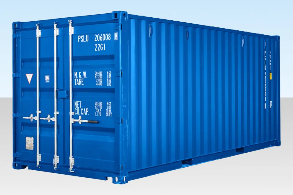

3. buying storage container and putting the tractor inside of it
With the 3rd option I am afraid of lack of ventilation and heat inside during the summer.
