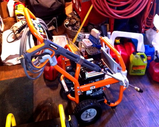

No, not unless the pressure washer is made for hot water.
Most pressure washers overheat and will seize up when you use Hot water through them.
