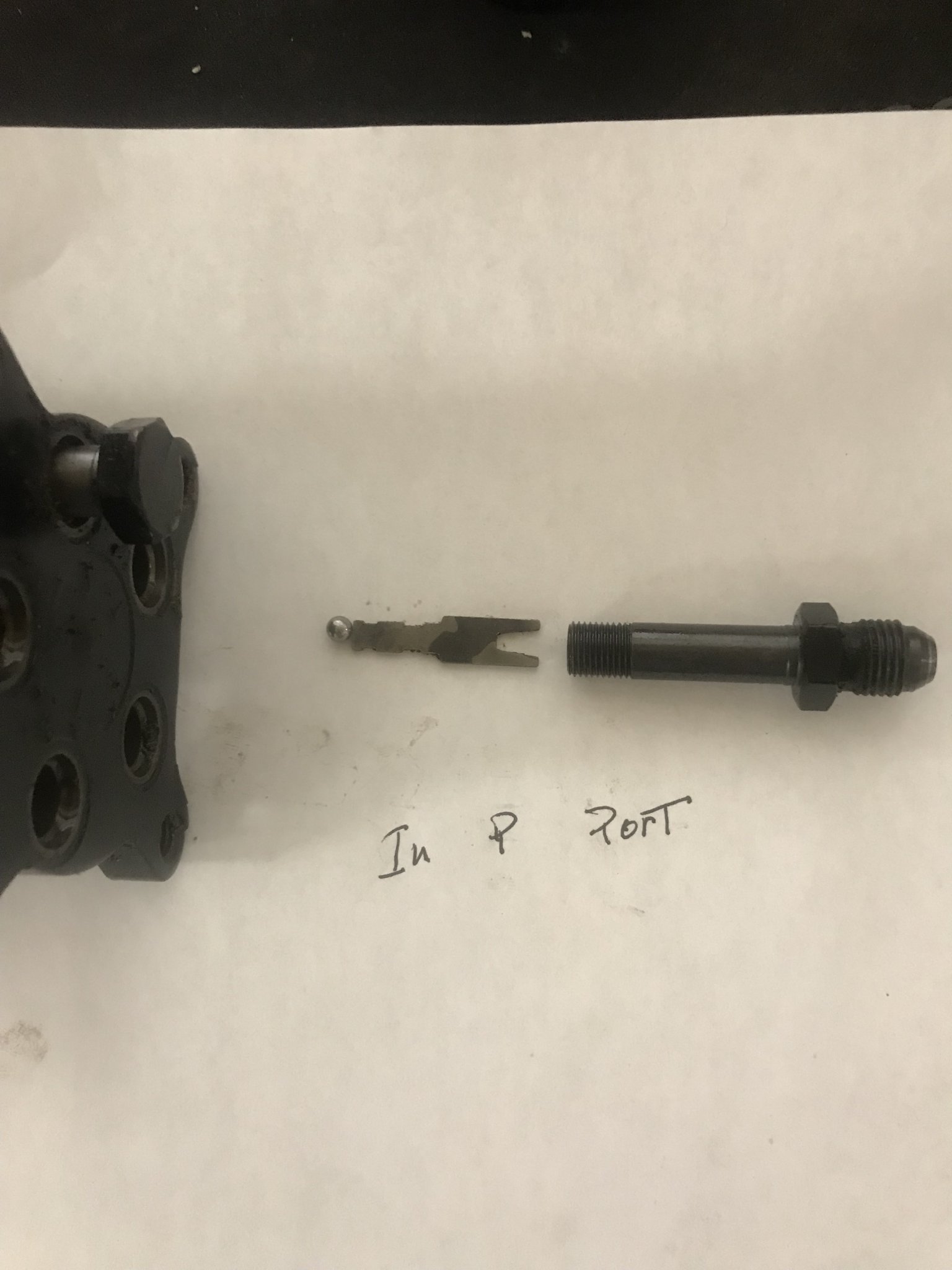

I replaced a damaged steering pump pressure hose on my RTV900. When I took the hose off the steering controller, the black fitting came off with it. I didn't see guts (springs, balls, etc.) come out with. I go to screw the fitting back in and it doesn't go all the way in. So I stick an inspection camera up the port and see a fork and ball. I don't see a spring on the fork but the camera isn't that great. I push a screw diver up the port and the fork and ball come out. Maybe there was a spring on the fork, but I don't see it anywhere. Of course, it could have fallen out and I didn't notice it and can't find it. So I manage to get the ball and fork stuffed back up in the steering controller with some transmission assembly lube. The black fitting now goes in and seats properly. But I have no power steering. The pump doesn't get hot and doesn't make any noise. Anyone have a parts breakdown of the steering controller? I checked the RTV 900 WSM and FRS but no luck. Thanks.
