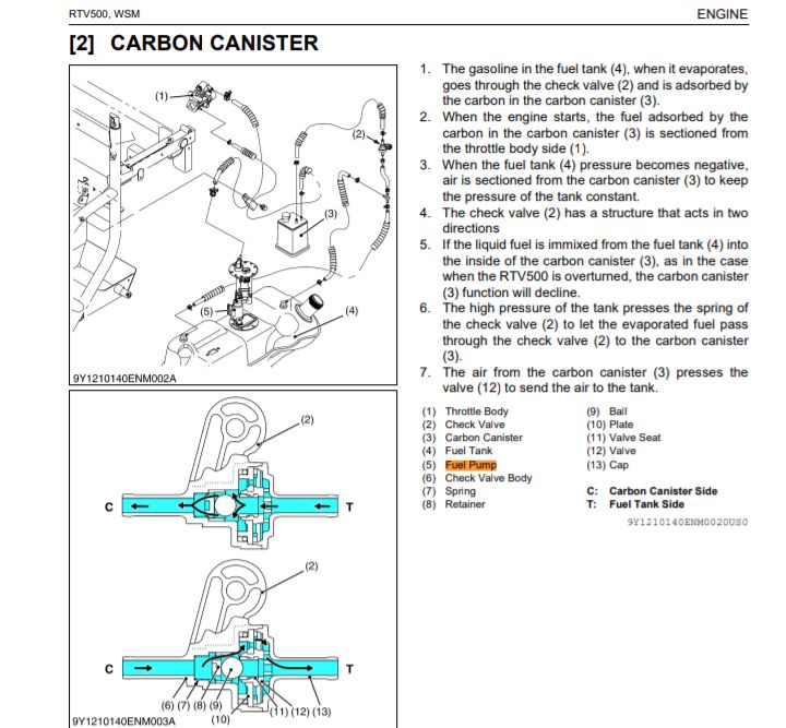

Check the one way check valve (#2)
Verify fuel pump pressure in hot conditions as you claim
Inspect fuel filter inside tank
That's where I would start
