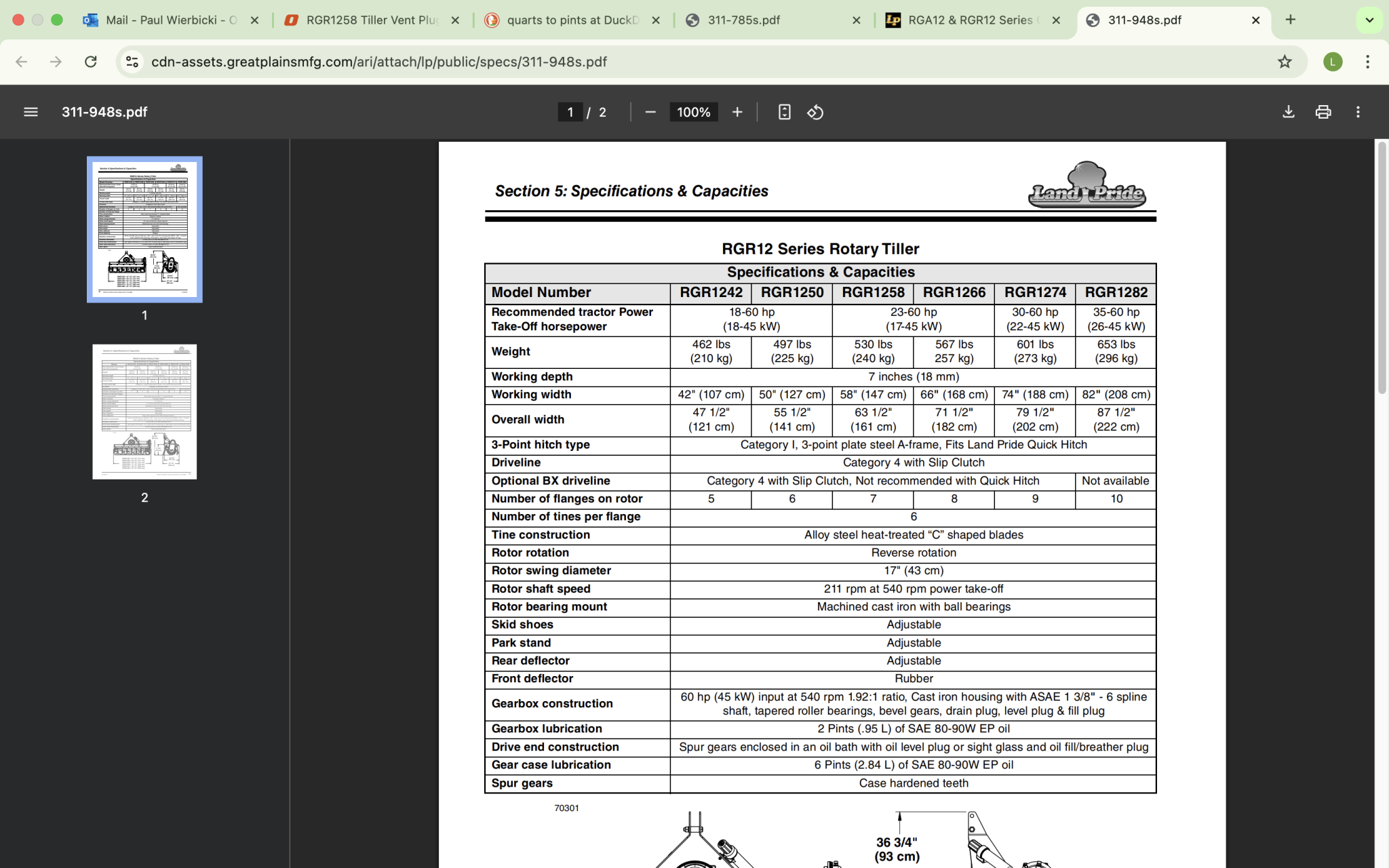

I am just "spit ballin" here, are you sure your putting the gear oil in the right place?
Gear BOX is 2 pints.
Gear CASE is 6 pints.
Just an observation.....

It is stored outside. Yes, I am putting the 6 pints / 3 qts in the gear case. The one that is on the side of the tiller, not the gear box on top. I just can’t believe there isn’t a better solution than what I have heard from others which is “just change your oil after use”. That to me sounds like a waste. There has to be a solution to keep water out. Could it be a bag vent plug? Also, why would oil be leaking out from where the vent plug is when I am using the tiller? It isn’t over full
