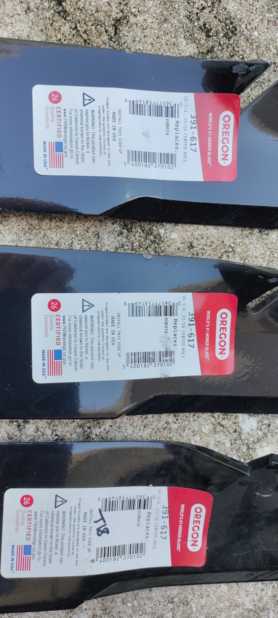

I bought these for my 48 inch MMM. They are very thick and heavy. Cheaper too. They seem to cut marginally better with less vibration and the edge seems to last longer.

Not same mower, but I’ve used something similar to these for a while.
As @xrocketengineer says, I recall them to be a little cheaper but also pretty stout and hold an edge well.
Didn’t dislike the OEM blades. Not a huge fan of these either they do seem to hold up well.

Do your blades have the dual bellville washers on the bolts? My 72 inch MMM does and the aftermarket gator blades were too thin to tighten with them. I had to add a third washer to get the blades to tighten and not spin on the bolts. Factory blades were 1/4" thick and the gator blades were 3/16". I've seen some 1/4" thick gator style blades at the dealer but I don't remember the brand name. The Oregon blades are working fine with the extra washer on them though.

Are those as thick as the OEM version? Where did you buy these at?
I believe that they were thicker and heavier than the OEM blades and they installed with the standard hardware with no problems. I got them from yardparts.com but they don't seem to carry that model any longer.

I don't recall vendor, but mine were Oregon G6 Gator blades. Different mower, but look like those @xrocketengineer pictured.
On my second set, and both sets were also a little heavier and wider than the OEM blades. No issues with mounting with stock washers.
Like I said, not enamored with them, but they do hold up well.
