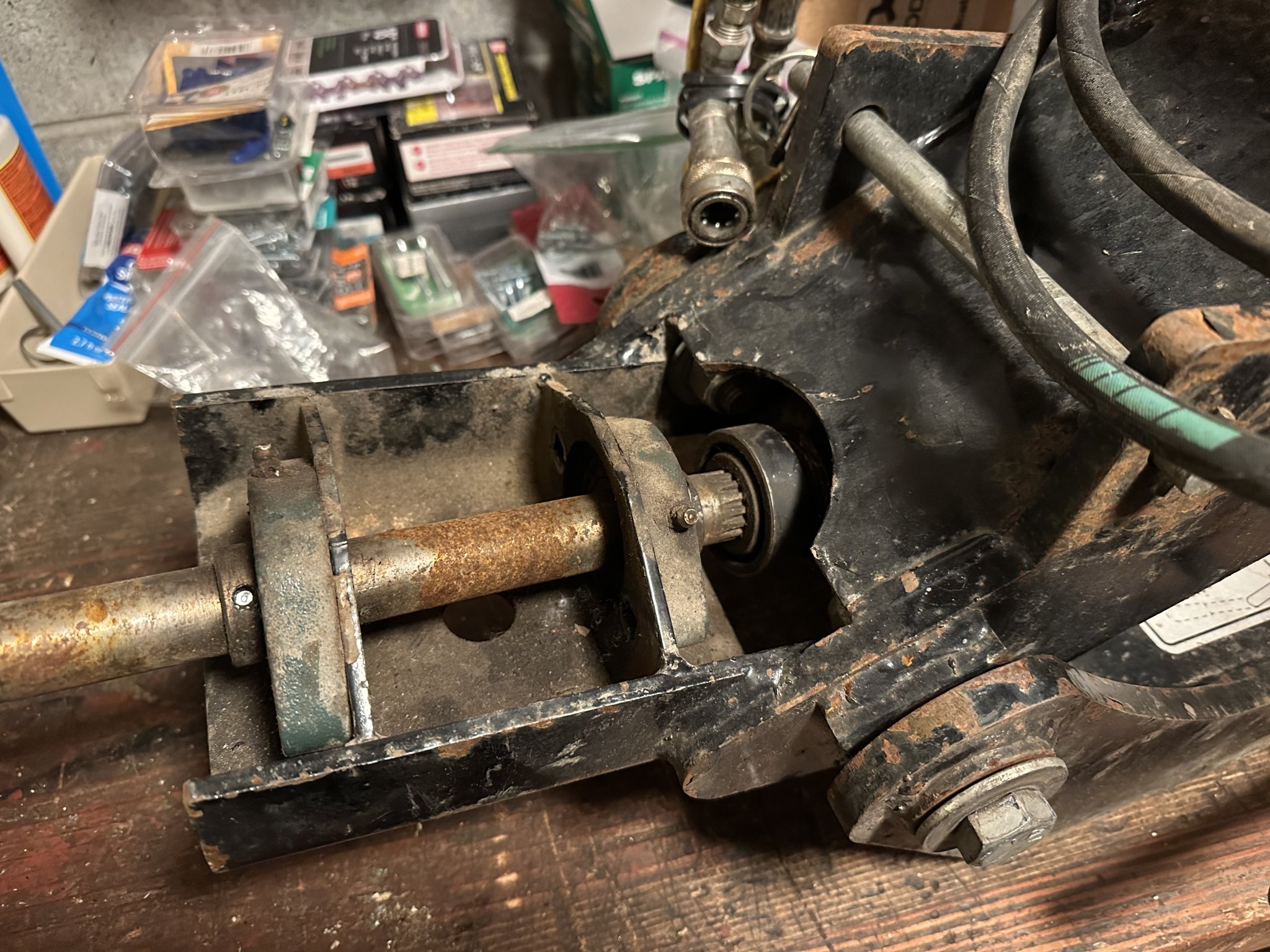

I bought a used BX2751 quick hitch and at least one of the bearings needs to be replaced. And there may be an additional bearing stuck to it and PTO linkage may be used on to the shaft? I removed the grub screws on the bearings but can't get them off. Should I just order the extra bearings then take the whole to a gear shop to have them clean it up instead of messing monkeying with it? Thanks!

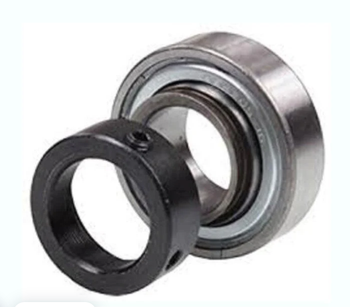

Those bearings may be 'locking' or 'eccentric' bearings. You remove the setscrews, then rotate the ring CW or CCW, I forget, to release it from the shaft. They do that to set the distance then end of the shaft is from the bearing mount. The critical dimension will be listed in the installation sheet....
29,384
5,658
They are locking collars, there is a second dimple in them that you use a punch on to release the collar.
10,643
4,495
THAT's them ! Lightly tap with a small punch cause 1st direction you go, you'll tighten it even more so go the other way .... I 'think' CCW to loosen ?

The lock collars are to be tightened in the direction of the shaft rotation, in this case they might be tightened in either direction.
10,643
4,495
THAT explains why I've had 'fun' in previous encounters with them ! Unless you KNOW which way the shaft rotates AND that the installer turned them the correct way, you have a 50-50 chance of loosening them the 1st time. Me, I have a 100% chance of TIGHTENING them even more ! Yup, Mr. Murphy follows me around.....

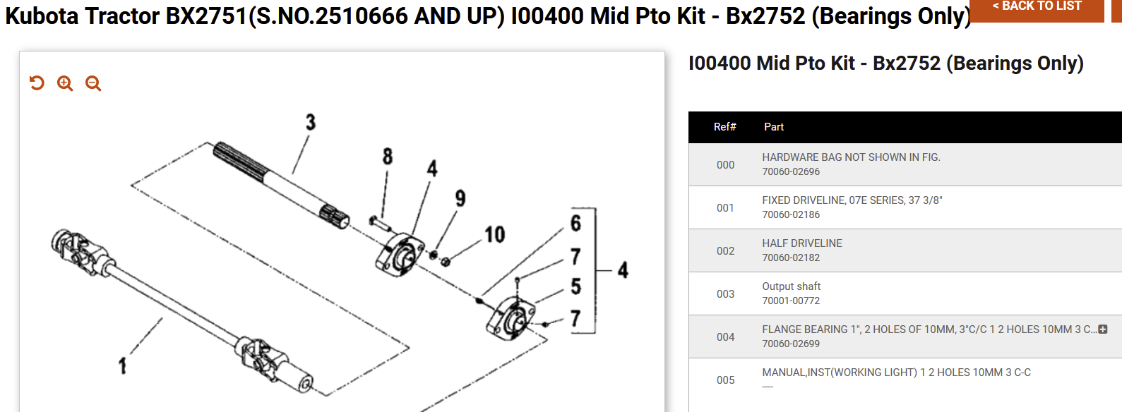

The bearings on this particular one is not a locking collar type.
70060-02699
The issue with this type is that sometimes a raised ring will form on the shaft where the set screws are tightened which may make it difficult to extract the shaft from the bearing.
  • Dislike
5,809
4,387
Looking at the picture, the rust alone on the shaft will prevent it from sliding off. I would spray it down with penetrating oil and using a strip of abrasive cloth polish the shaft down to bare metal. Just had to do this to a cylinder that rusted when I left the dump body up over the winter so snow and rain didn't rust out the dump body floor.
29,384
5,658
70060-02699
Where did you get your information?

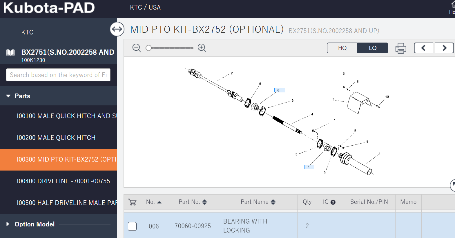

That's not the bearing on that quick hitch!
The bearing for that model is:
70060-00925
And it does have locking collar

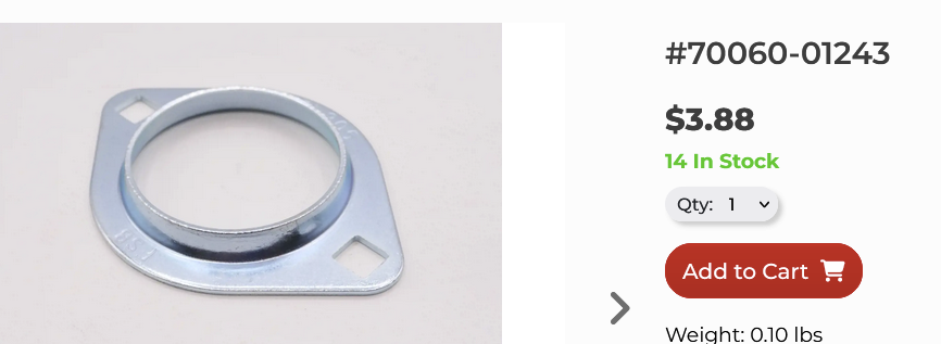

It's blatantly obvious that you're wrong when you look at the bearings in the OP's picture.

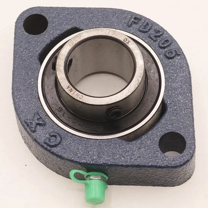

The bearing you're showing is an insert and requires flanges.
How can you say that I'm wrong when the OP's picture is so obvious.
This is what the OP has.

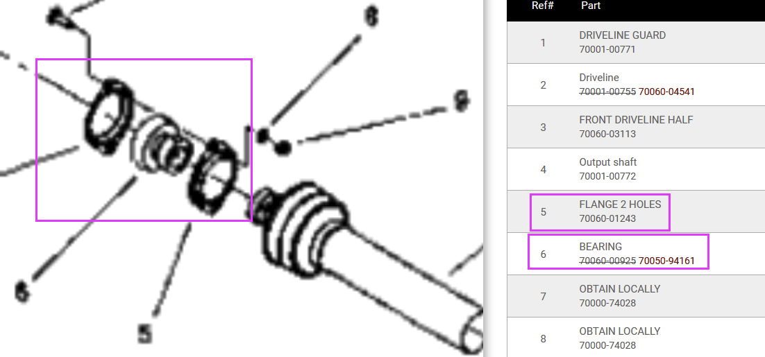

Yep your right I missed that detail when I looked at 2 sets of prints with 2 different serial number breaks and 2 different prints.

curious, so I found the snowblower 4 point hitch manual and it uses the same bearings(same part number ). There are TWO setscrews (@ 90* ) used to secure the shaft to the bearing. I'm wondering if the OP hasn't removed BOTH of the setscrews on EACH bearing ? If he has , a solid 'tap' to move the shaft ,in and out may free it up a bit from the bearings.
It'd be nice to see IF what ever is on the right side ( front ?) of the hitch could be removed. I assume a U-jointed shaft to snowblower box ?
