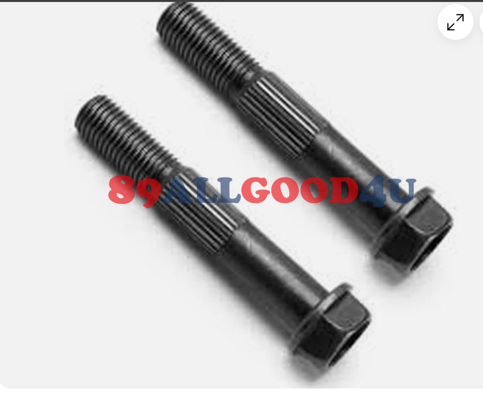

So replacement rod bolts I bought are completely different designs from the originals in my L2850. The new ones on left fit the old rods, but are they going to work out ok? And is 28-30 ft lbs torque still correct with these bolts?
32,593
8,194
Yes that's an updated style, it's not even the newest style of rod bolt.
And yes same torque spec.
Here is the newest look for them.
