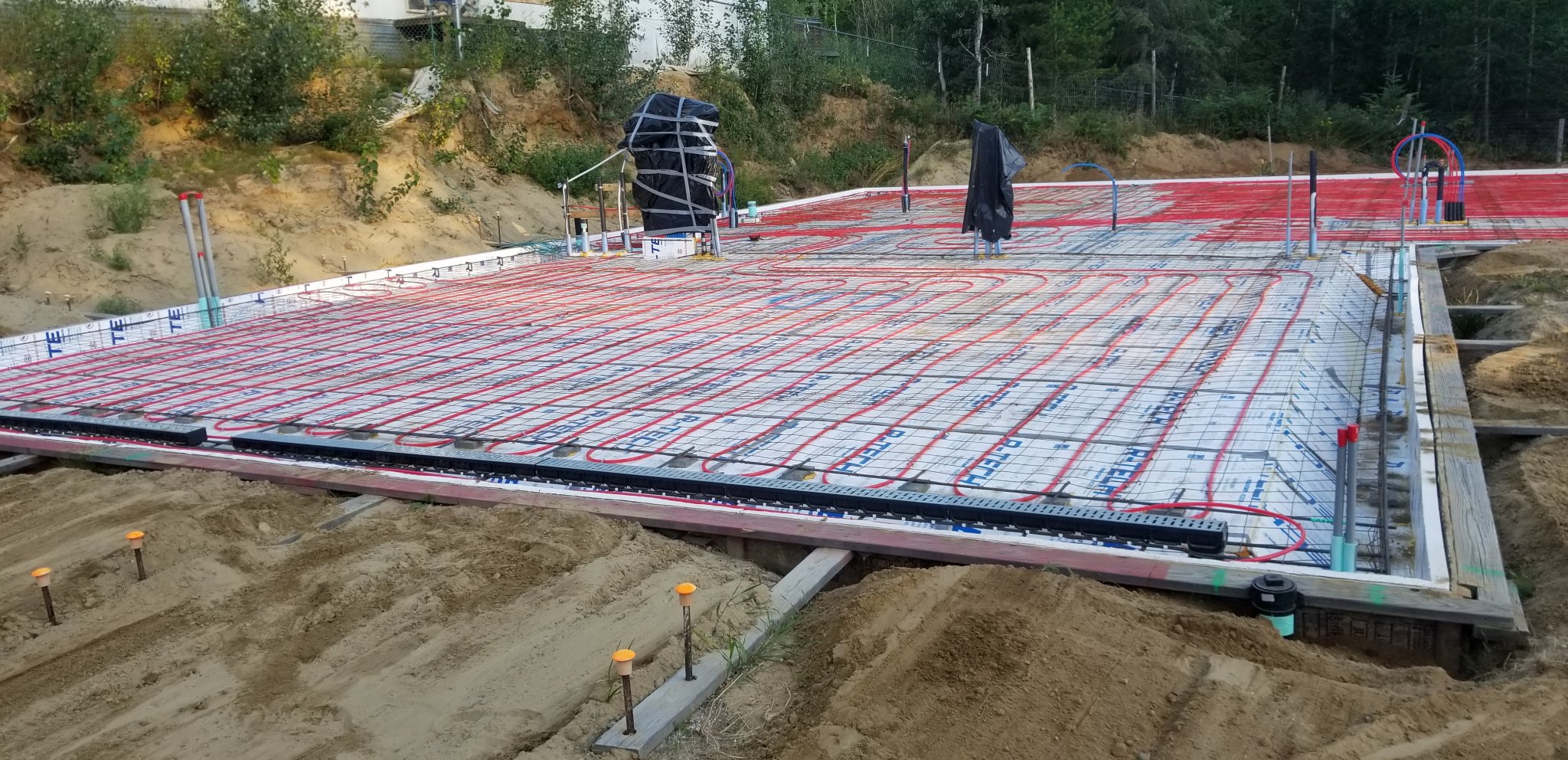

This is exactly why my garage is heated and has a slope and a drain across the entire front of it, no standing water.

@niw curious, why the 'gap' between the troughs ? My luck THAT is where the water would go.....
Middle of 2 doors and no water sits on the surface there.
The main reason for the break was slope on the bottom of the drains.
As it's been done no water sits in the bottom of the drains.
The guys that did my concrete are the best around.
Everything was finished perfectly, they got the slope and flats, spot on everywhere.

Yea I talked with my plumbing inspector and he said as long as during underground he could physically see that the sewer and floor drains did not connect he would be happy.
That little detail was a bear, because my main sewer leaves the house at 3 foot 6" and the floor drain was at 4' and we are on sand so it kept wanting to fill itself in before inspection.

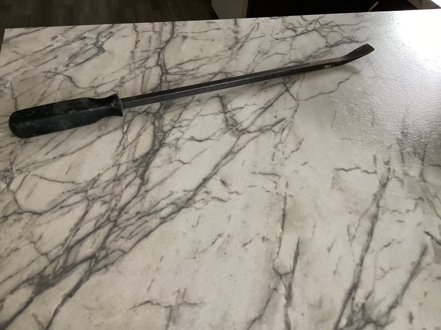

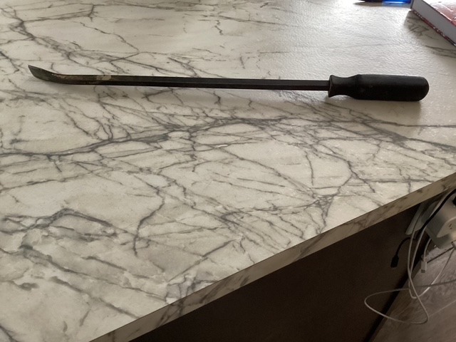

This is what I always used, it's 23" long, I think I picked it up at Princess Auto for you Canadians EH or Harbor Freight for you's south of the border.

I keep one of them on my 8N all the time. Always handy when you need a little prying to hook something up. 8N is my snow plowing tractor and it is always handy to lift the ladder style chains up on the lugs if I get to spinning on some ice and they are down between the lugs. Had that problem today. A few seconds doing that and I am moving again today. I like better chains but get by with the occasional pry bar fix.
