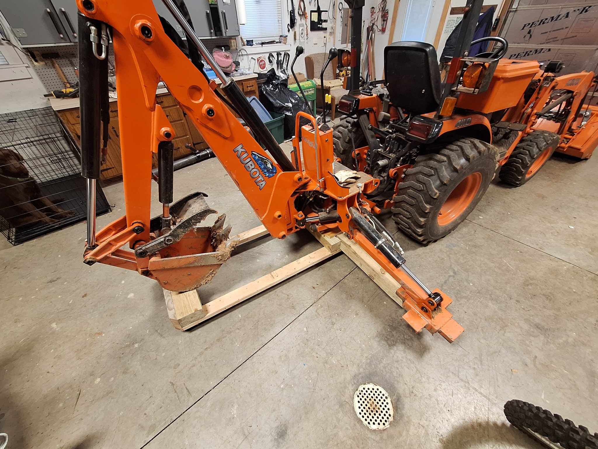

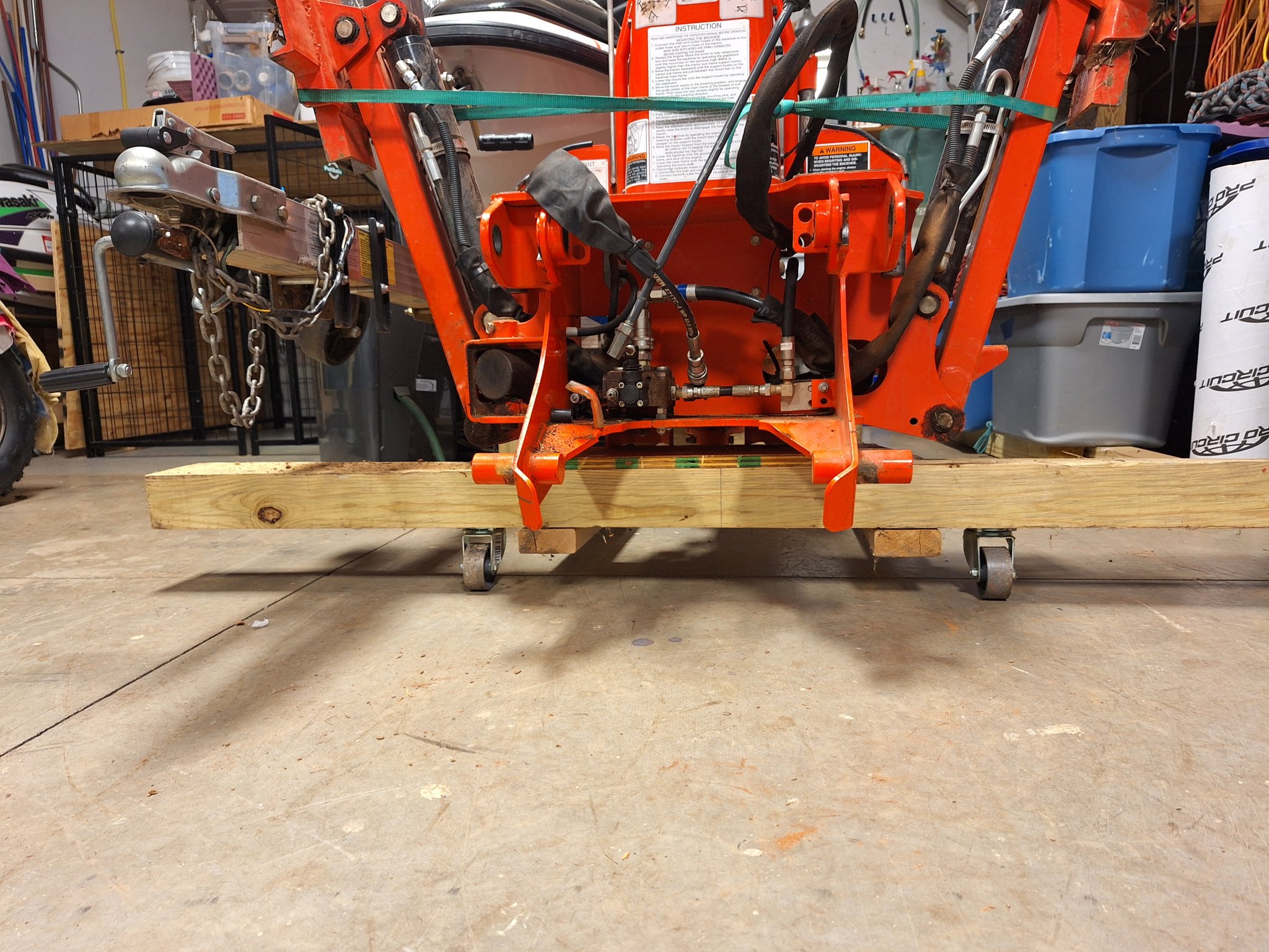

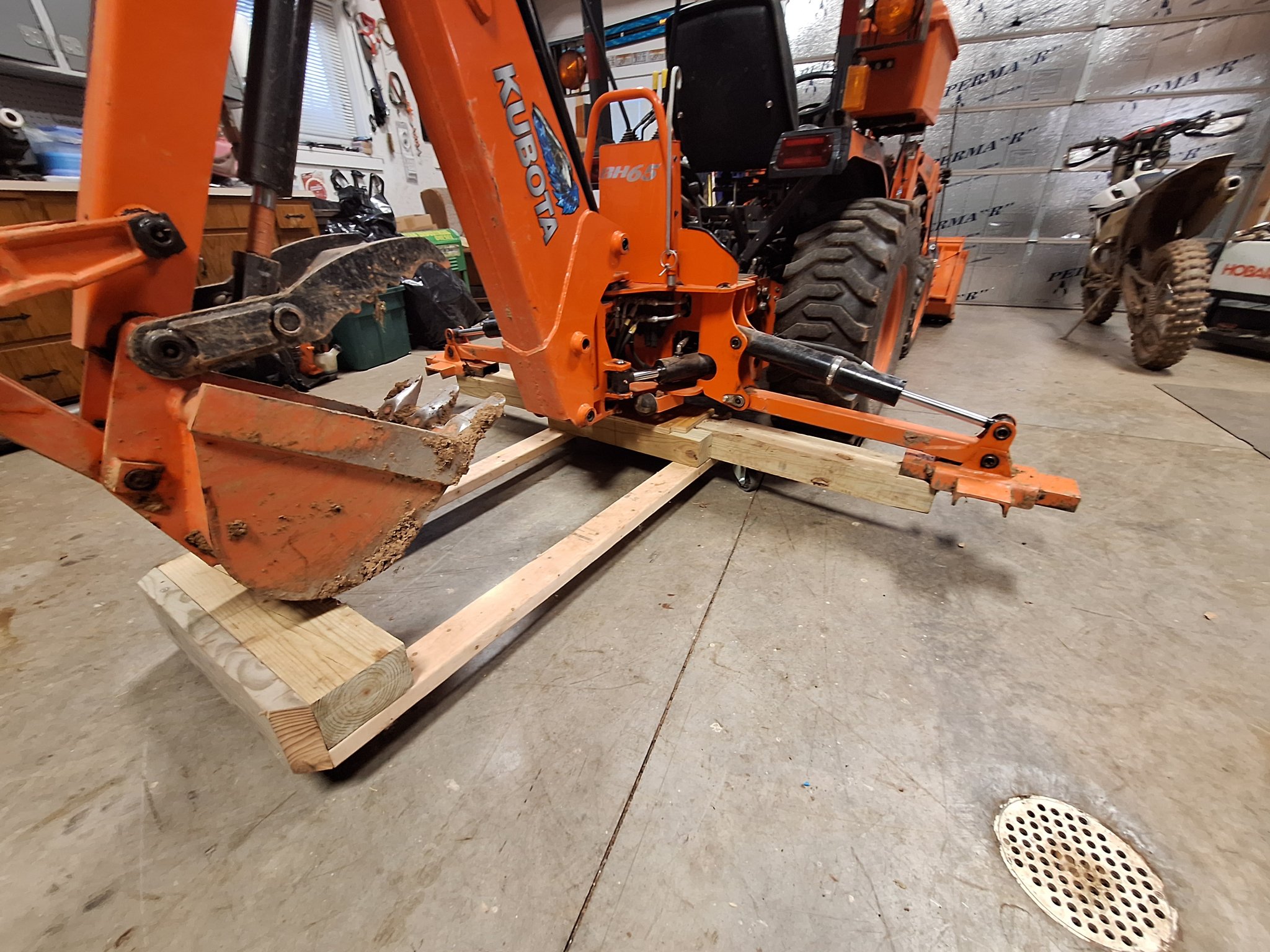

You have a larger BH than the 65 on my B2620, but I'd recommend a dolly for the BH if you are taking it off on a hard surface. I DIY'd one based on some forum and Google searches. It allows you to move the BH to optimize connection rather than moving the tractor. Subtle shifts of the dolly can really ease pin alignment for insertion along with moving the arm/bucket against the ground (or dolly) rather than using the stabilizers.
Here is what I came up with.
