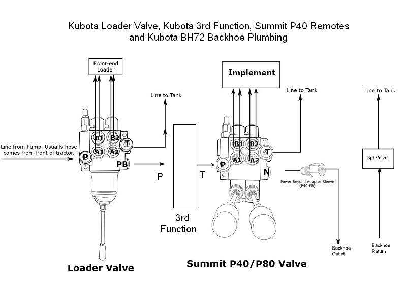

First let's correct a major misconception. The PB line on your loader NEVER goes to tank. With nothing else on the tractor it goes to the 3pt control valve.
Here is what you want and what you get with either OEM remotes or your option 3 when properly plumbed. I dont think your OEM kit will actually work with the backhoe installed.

We need to clean up the nomencature:
P and T are not work ports. P is an inlet port that receives pressure and T is an outlet port that returns the inlet flow to tank.
The work ports are the ports that connect the valve to the actuators - e.g. cylinders or motors.
A normal open center double acting valve has 4 ports - an inlet (P), an outlet (T), and two work ports (A1, B1). When the valve is in neutral oil coming in on P goes straight through and out via T. Noting goes to A1 or B1. When the valve is operated to send inlet oil to one of the work ports (A1) the flow goes out A1, the return oil comes back on B1, and from there exits on T.
A valve with power beyond has 5 ports - an inlet P, an outlet to tank (T), a second outlet to a downstream valve (PB), and two work ports (A1, B1). When the valvw is in neutral oil coming in on P goes straight through and out on PB to the downstream valve. When it is shifted the incoming oil on P goes out on A1, return oil comes back on B1, PB is blocked, and return oil from B1 goes out on T.
The Summit kit you linked does not have a power beyond port and T is used for PB. That works but can create unwanted and potentially dangerous interactions between valves and cylinders.
A proper way to do that is to use a valve with both power beyond and tank outlets.
These valves come with three outlets all of which can go to tank. To convert them to power beyond you install a power beyond sleeve in the port labeled N.. That isolates N from the other two outlet ports and it acts as I described above eliminating those unwanted interactions.
The Summit manual P40 valves can be configured with multiple spools,, float, detents, spring center, motor spools etc and are a lot less expensive.

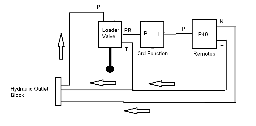

I have a B2601 and was going down a similar road a while ago. I was headed towards your option 1 because it was more integrated. After research, the $$ amount and complaints about Kubota's stack valves leaking made me go option 3.
I was leaning towards using the aux. power ports when Dan corrected me. This is an unnecessary $250 spent. Just tap into the PB line.
I now have a 3rd function solenoid valve mounted low and behind the rear axle, a 3 spool valve mounted on the right fender/ROPs and a 2 spool valve mounted in the near stock location.
The 3 spool valve powers my top, tilt, and mower deck lift. The 2 spool will be plumbed to QDs at the rear of the tractor, for whatever. Dump trailer, blade angle, etc.
The key is the daisy chain as above, P Port in, PB port out to the next valve, T ports from the valves tied together and tee'd in to the original loader tank line.

Dan, do you have a diagram for installing rear remotes on an L2501 with Kubota loader valve + LP 3rd function using the Summit P40 Valve?
Would it be basically the same as the above diagram with port "N" plugged?
7,270
3,552
You still have to use the N port wuth a power beyond sleeve.
