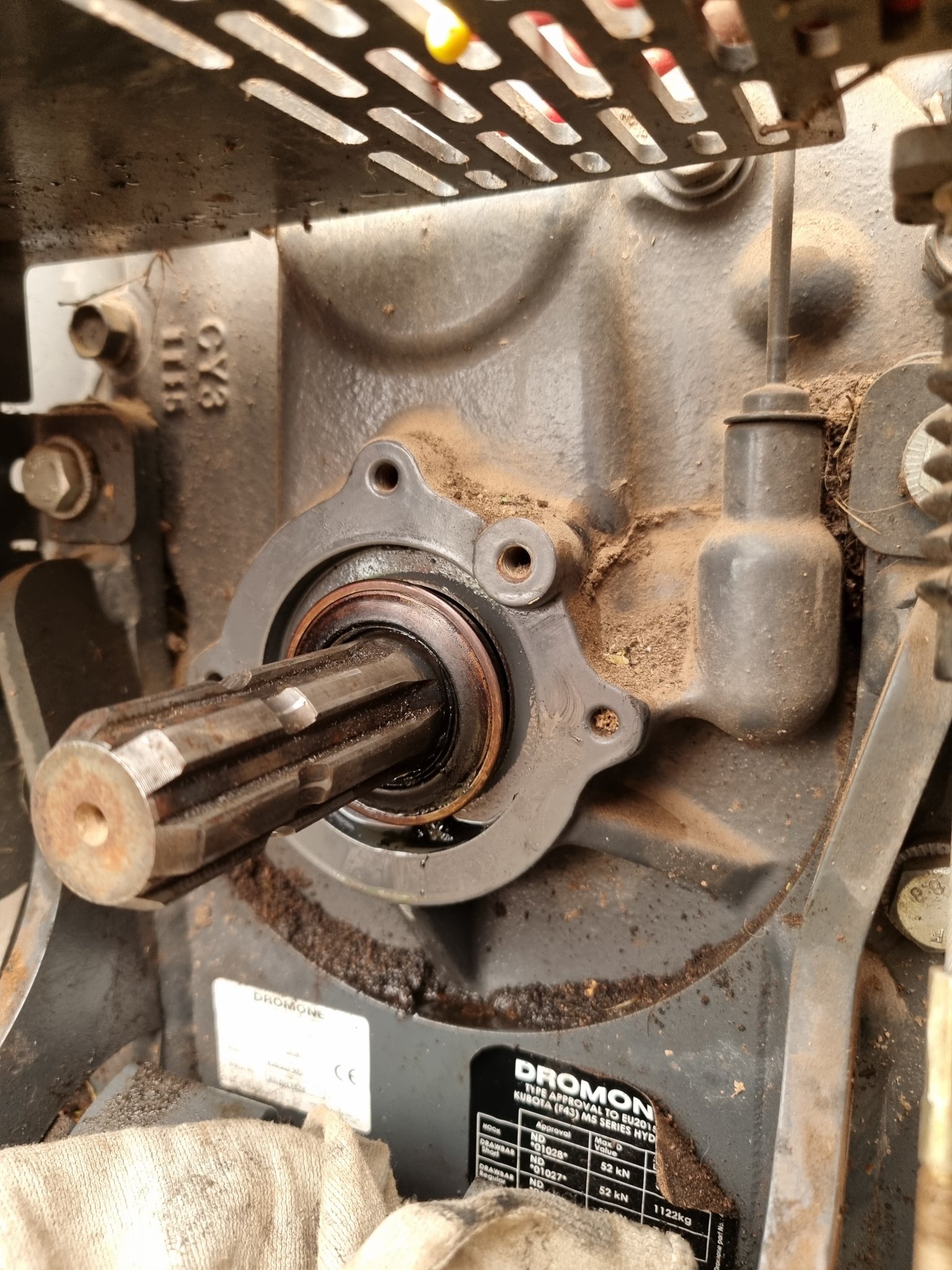

The PTO seal has blown out twice (within 1 hour of working with the replacement seal) on this M5112 tractor - which has less than 1000 hours since it was purchased. Dealer simply replaced the seal under warranty. The dealer now seems to think this may be caused by a plugged breather (transmission) - however the dipstick, which is less than 100 mm from the seal, would certainly be expelled much more easily than the seal itself, so the breather theory seems bogus at best. Anybody have any experience with the bearings failing on the PTO output shaft? There are 2 bearings on the output shaft and two on the countershaft. My best guess is that one of the output shaft bearings has failed and the misalignment/friction is forcing the seal out. See attached pics. Any additional input would be appreciated.

Measure the seal and bore to confirm fit. Indicate the PTO shaft to confirm straightness. Leave the fill cap off when a new OEM seal is installed.

The breather/vent theory is valid. That would be the first thing I would check for any seal leak. I have seen seals STOP leaking just by cleaning a stuck or clogged vent.
My old JD855 was pushing oil out of the hydro side shaft. Dipstick remained in place. Found the breather tube clogged and cleaned it out and the leak stopped. Had a similar experience on a Mustang axle seal except it didn't have a dipstick. BUT cleaning the stuck vent stopped the leak without doing a seal replacement.

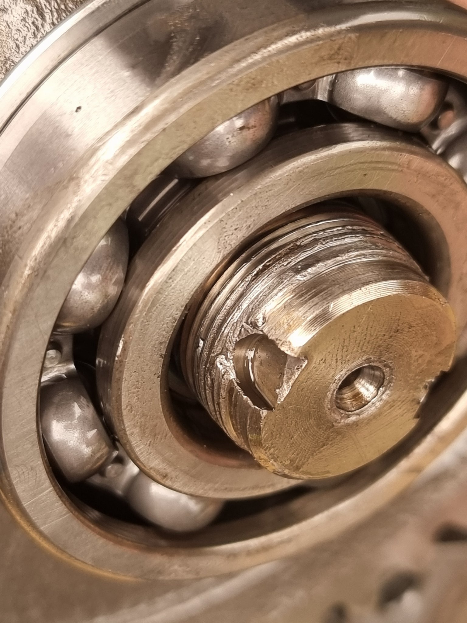

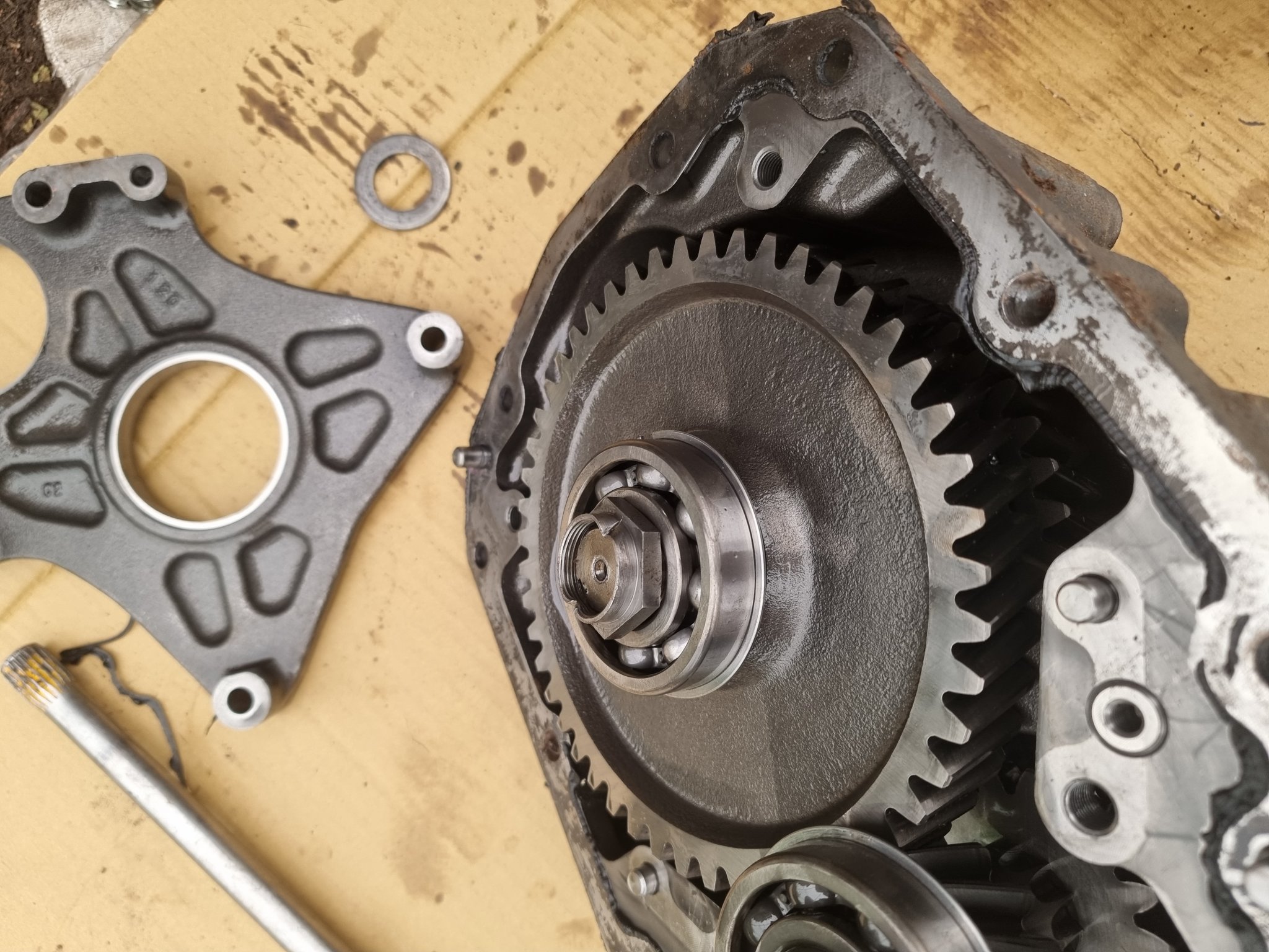

Breather theory was, in fact, bogus. Nothing plugged. Once the tech grudgingly confirmed that, he bit the bullet and the rear PTO case came off.
The failure is now obvious, however the cause is not. See attached pics.
The retaining nut on the PTO output shaft failed or was damaged during installation. The nut and washer were lying in the bottom of the case. Will have to await a response from Kubota warranty, but this is clearly not a simple failure. Number of theories why this occurred on such a new tractor with so few hours on the PTO. Some possibilities:
1. Japanese workers are not all 'legendary', and over-tightened/stripped the nut on installation;
2. Retaining nut was not manufactured to spec - bad metal;
3. inexplicable load on the PTO output shaft (unlikely, imho) - your guess is as good as mine.
Some things to note:
1. the nut was swedged as designed - unlikely it rotated off - it rattled for a long time;
2. the nut is stripped, but the shaft, although damaged, is not nearly as bad;
3. the seal failure was likely caused by the shaft moving in and out of the gear/bearing stack;
4. unlikely the output bearing failed (no play at the output) - but will have to await teardown;
5. output and countershaft gears appear clean with no apparent damage;
6. gear oil was clean - no stardust.
Any additional ideas/comments as to the cause of the failure would be appreciated.

Just one additional clarification - the oil leak was between the seal and the case - not between the seal and the PTO shaft. The seal was physically expelled from the housing - visible in the pic with the first post.

Yeah, that's because the PTO shaft is working its way out of the case and the gear/bearing stack.
Everything is supposed to be clamped together between the output bearing shoulder and the nut.
Once the nut fell off, the only thing stopping that blessed event was the rear seal. The bearing shoulder on the shaft (directly behind and shoving on the seal) is apparently what ejected the seal from the case. The failure would have been catastrophic in very short order. Kubota warranty got lucky.

Sure looks like it was cross threaded during the factory install. Nothing the owner could have done could cause that damage(imp PTO shafts are telescoping, no real load on the tractor PTO shaft. As for the 'why failed at 1000hrs'... tractor probably hasn't had PTO RUNNING for 1000hrs ! Heck my BX23S has 1225hrs on the clock, and ZERO using the PTO.
The repair is simple, new nut, shaft, seal..should be good to go in an hour.

Once re-assembled, the tractor started and the PTO engaged with no load at idle (500 or 1000 rpm PTO speed selected) - the PTO box has a death rattle. Same volume and frequency at both PTO output speed settings, so that would indicate that the noise originates at the point of power input. The clatter is louder at idle than the tractor's engine. Disengage the PTO and you just hear the tractor's engine noise. Turn off the engine and spin the output shaft by hand - you still have the same noise. You can feel the noise in your hand as you turn the shaft. Conclusion - source is in the PTO box and it's not 'rattling' gears due to clearance. Once again - these are helical cut gears not straight cut ones - and there is no way to adjust gear backlash. The bearing cap is aligned and fixed by two dowels so movement or misalignment theoretically cannot be the cause. Audio of the PTO box noise attached.
Any input anyone might have as to the cause of the rattle would be appreciated.

sigh, something is WRONG in the repair, quick return to dealer. Any 'in/out' of shaft ?

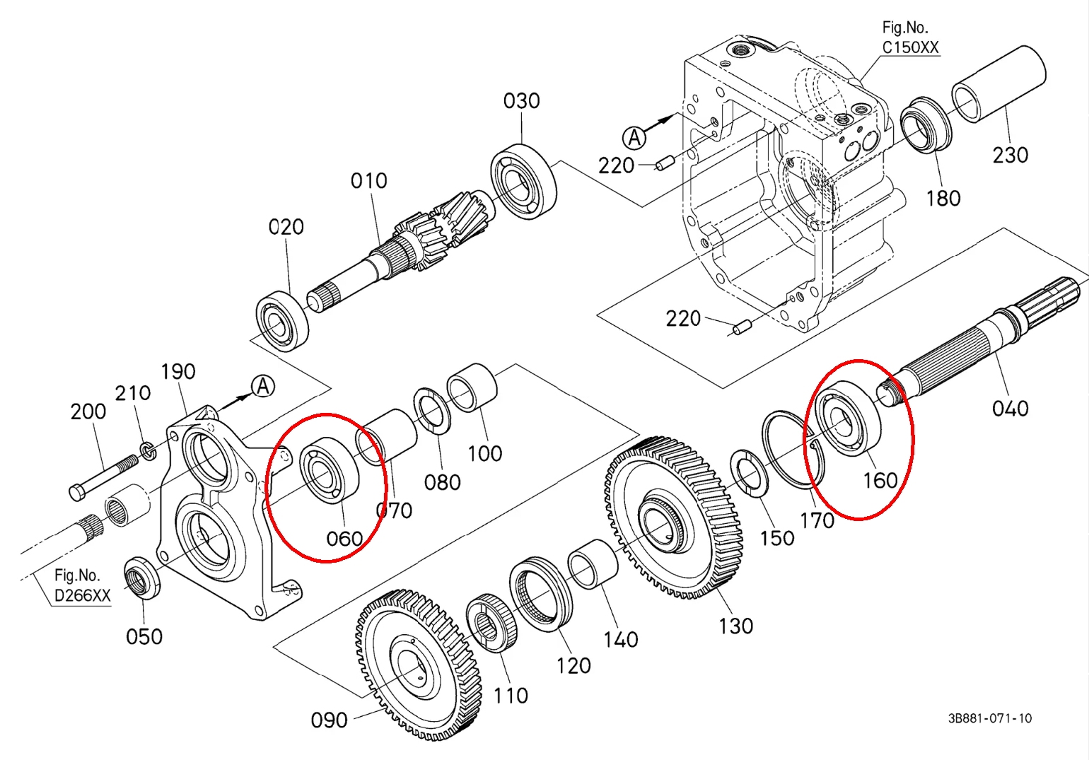

Maybe the 'sequence of parts on the shaft is wrong ? #050 and 080 look similar but could they have been swapped ? I didn't look them up but different numbers usually means different parts.
Noise when hand turning the PTO shaft indicates it IS in the PTO output shaft, not what is powering it.
