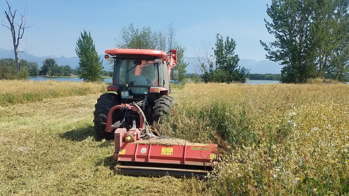

Bought a new MX6000 and a Delmornio Super Centurian 158 Flail Ditch mower.
The lift works fine, but the rear controllers that the dealer installed have too much power in them to make the things usable. The part is next to me, and I can promise if I pulled the offset lever more than an inch, I could flip-move a Ford F250 20 yards. there must be a way to retard or adjust the flow to the rear controllers? the hydraulics are pretty short.
ideas?

Slow engine speed to idle.
and/or
Install these on the cylinders.
