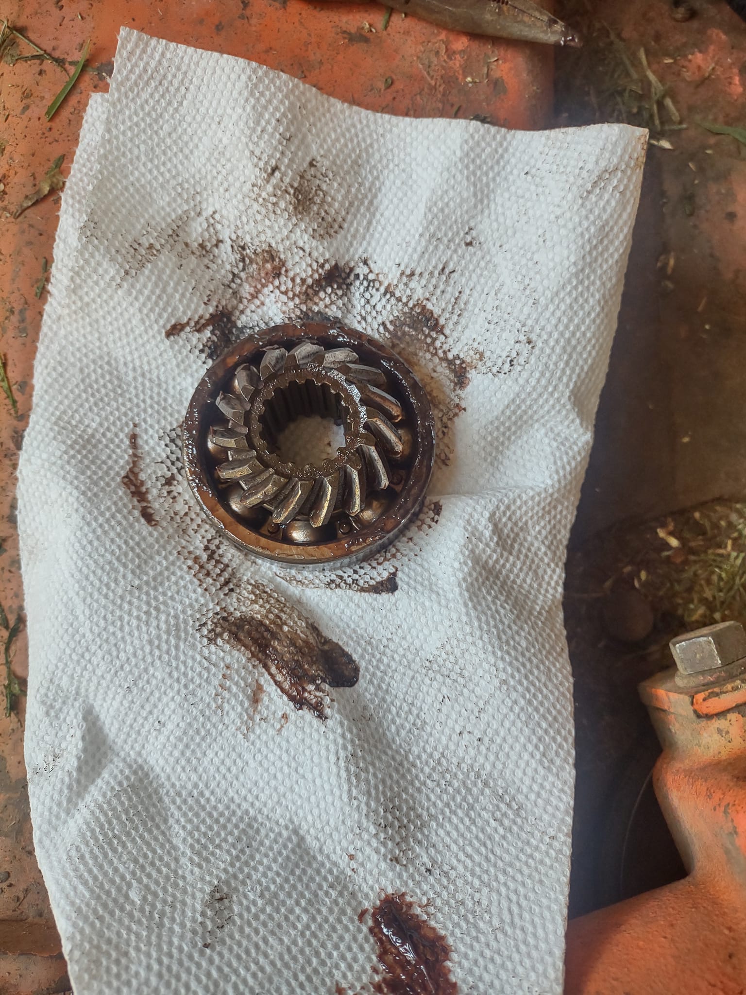

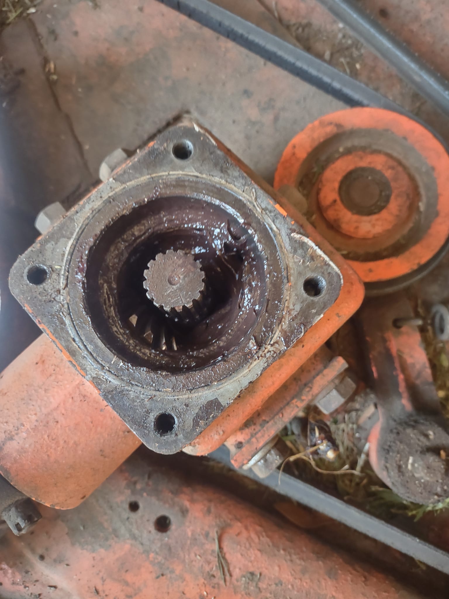

Not good. Anyone know how to rebuild a mower deck gear box?
Previous owner removed the external clip from the shaft, I see no shims, no o ring and they packed it with grease. The good thing is it still works, the bad thing is it makes too much noise.

You probably should remove it from the machine and do a complete disassembly.
Inspect all components and identify what is missing.
Messick's has a breakdown of the gear box and has many items you probably need in stock.
Then you can put it back together and do the shimming then.
Since it is ball bearings, you probably only have to shim for gear backlash.

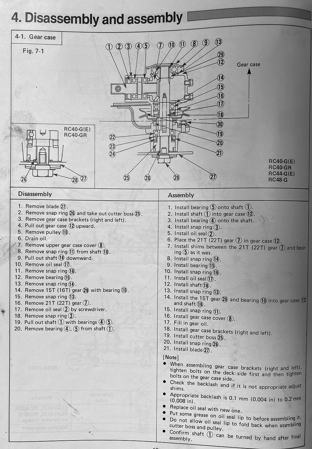

Rebuild procedure attached. Usually when they are filled with grease instead of gear oil, it's because they leak......
