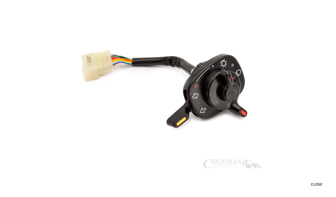

On the Kubota site, the part is listed as discontinued.

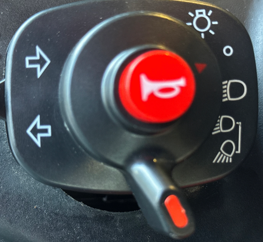

The only ones I see for sale are aftermarket ones with a horn button which, when pressed, activates the rear warning lights.

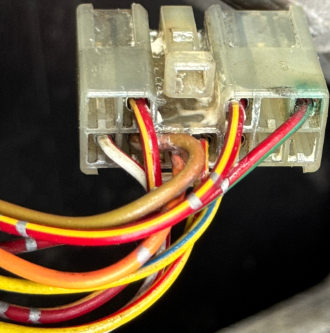

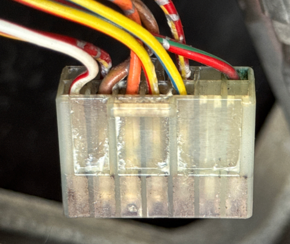

OEM connector on the BX2660 side:
In the WorkShop Manual (WSM) sections 6-S18 through S-23, the wiring is listed. The colors listed match the colors of the wires on the BX2660 side.

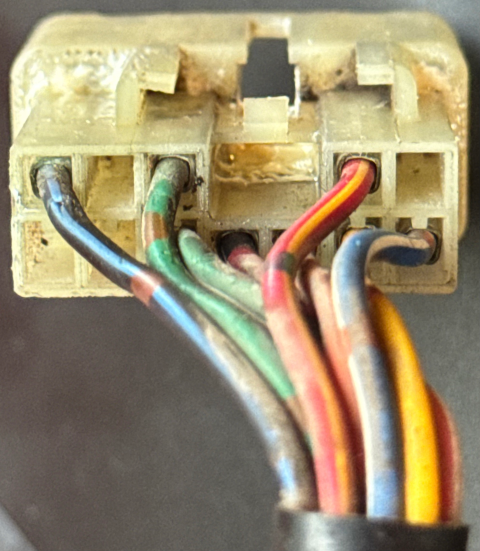

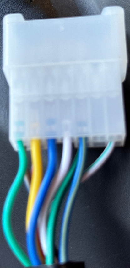

OEM connector on the combination switch side (the colors do no match the wires on the BX2660 side):

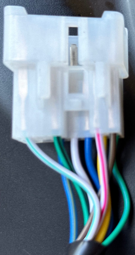

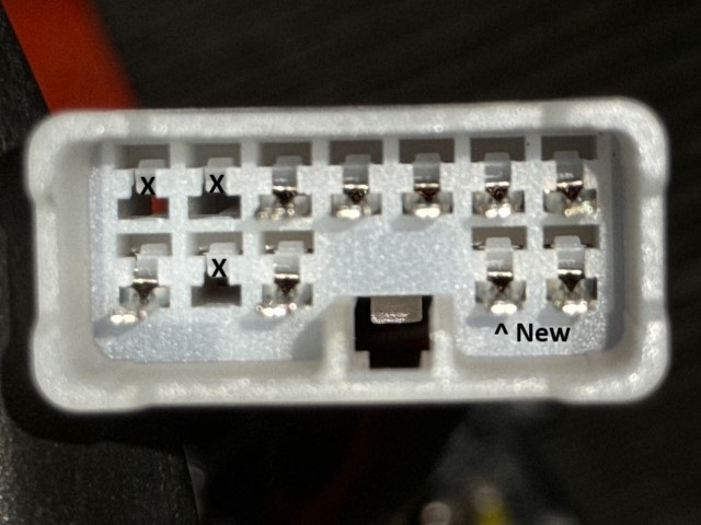

Aftermarket connector:
The pink and white wire in the second pin from the right is the connection in the aftermarket combination switch that is not in the OEM switch. I don't know what it does.

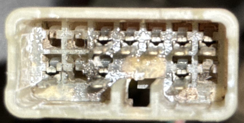

Sorry for the poor image; the OEM connector is worn and dirty:
The aftermarket connector has an extra pin with the pink and white wire above:
When you press the horn button, the rear lights start flashing, similar to the OEM switch being twisted to the ⚠ symbol, but when you let go of the horn button, the rear lights revert back to being always on or off.
