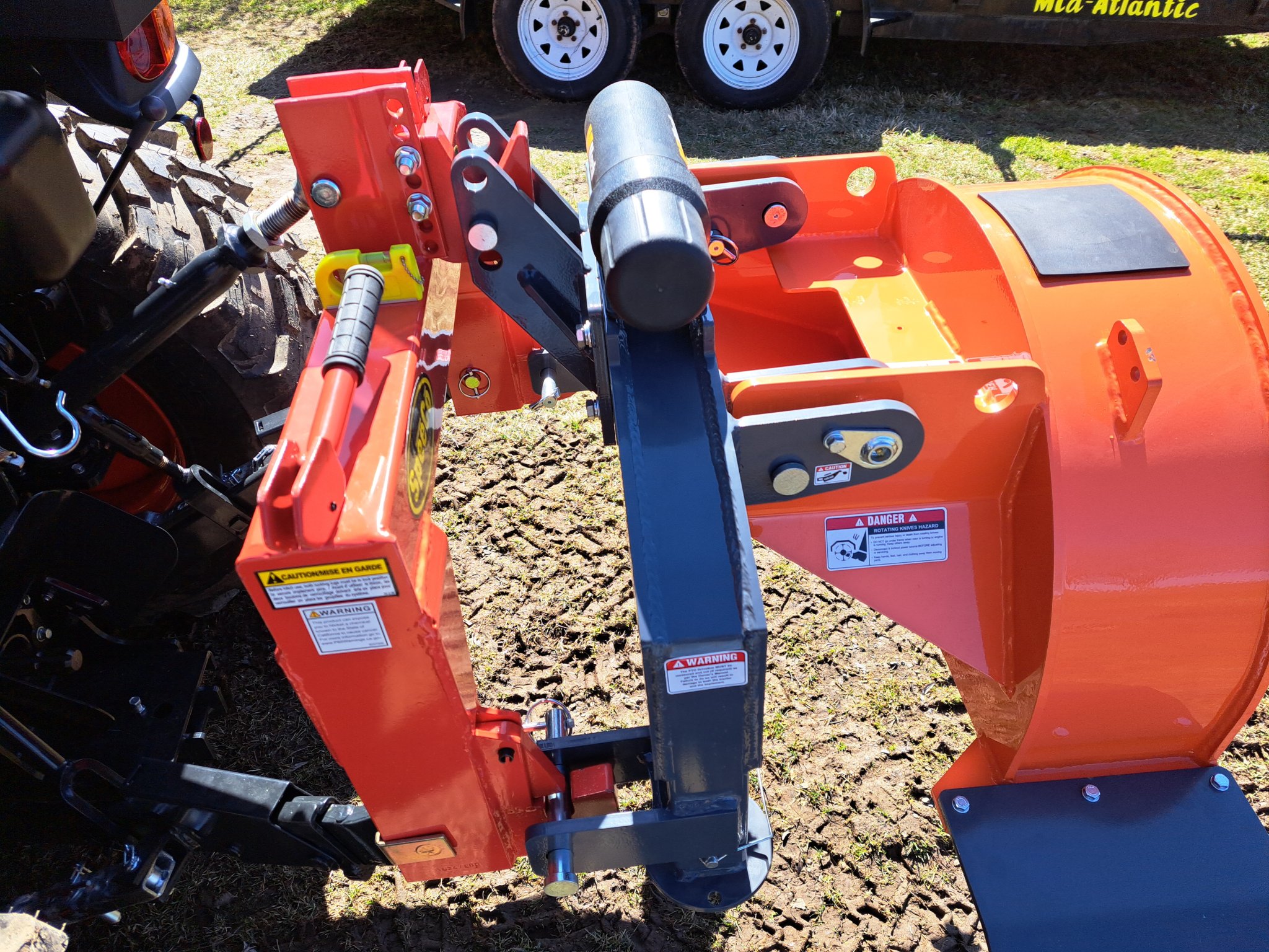

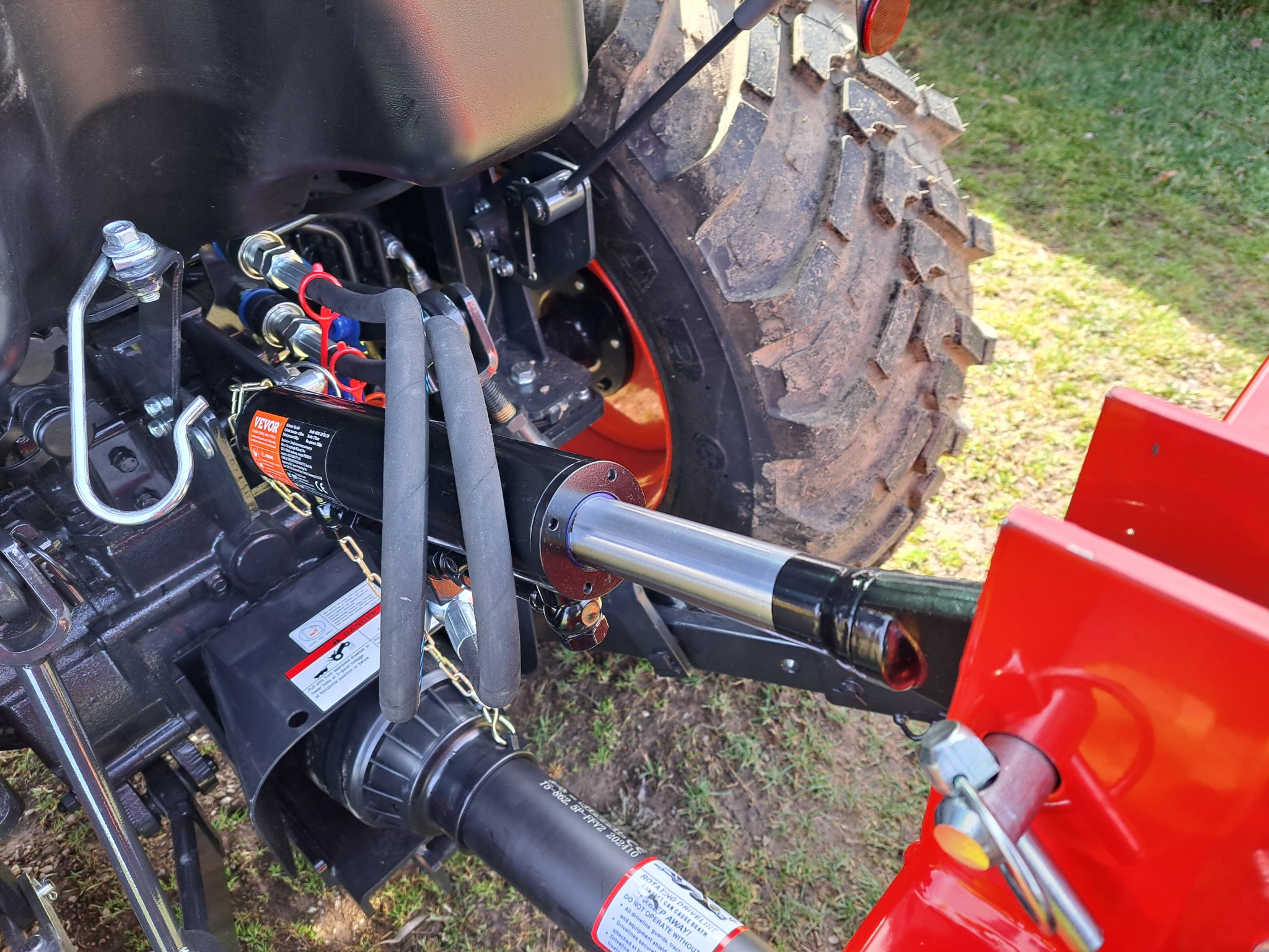

Not if you have top-n-tilt. 😂
A Quick Hitch without top-n-tilt is like a peanut butter and jelly sandwich without the jelly (jam). :)
I have top-n-tilt on both tractors and would never be without that feature. Not only do they make a QH unbeatable (with QH compatible implements of course), they are a huge upgrade for any implement that requires regular adjustments to the top link, or the side link, or benefit from floating the top or side links.

Take a full step! 😂😂😂 You won't regret it. I often put the side link in float mode for the snow blower, flail, rotary cutter, grading scraper, box blade, etc. It allows a rigid implement to better align itself to the terrain ... if that's what you want.
