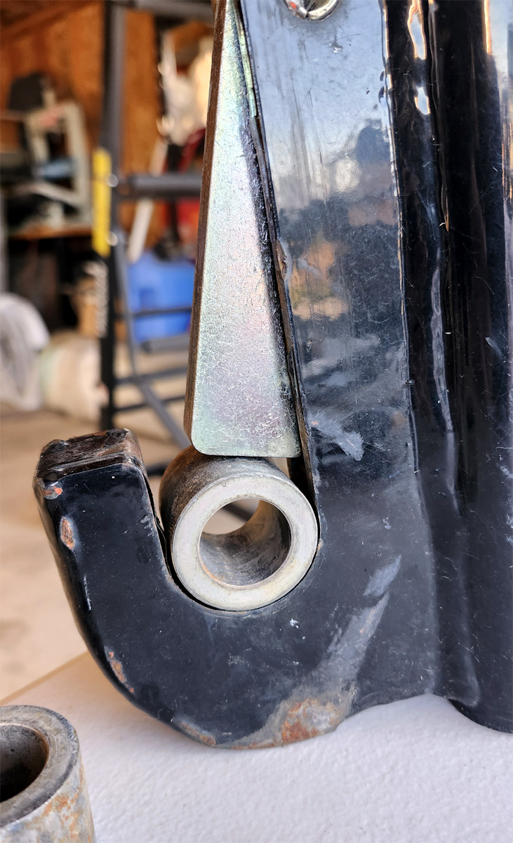

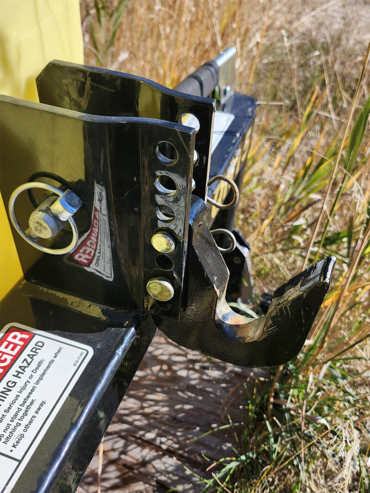

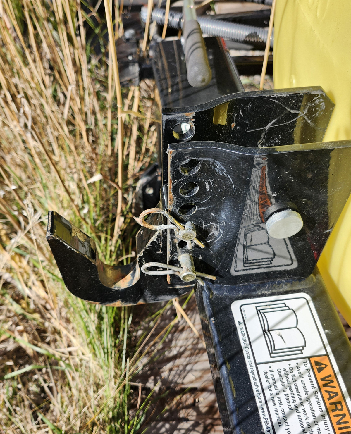

I know that some here really like the Pats system, but I still have my doubts that it's better than a Land Pride or similar Quick Hitch when it comes to hooking up to QH compatible implements, particularly if you have an hydraulic top link and hydraulic lifting rod i.e. top-n-tilt. The ability to move (angle) the QH around as a unit and get connected to the implement without getting off the tractor is a real benefit.
I started out with a QH05 on a BX25D and then QH10 and QH15 on the MX and M. I think I prefer the QH10 to the QH15 since the adjustable hook on the 15 seems to be more trouble than it's worth.

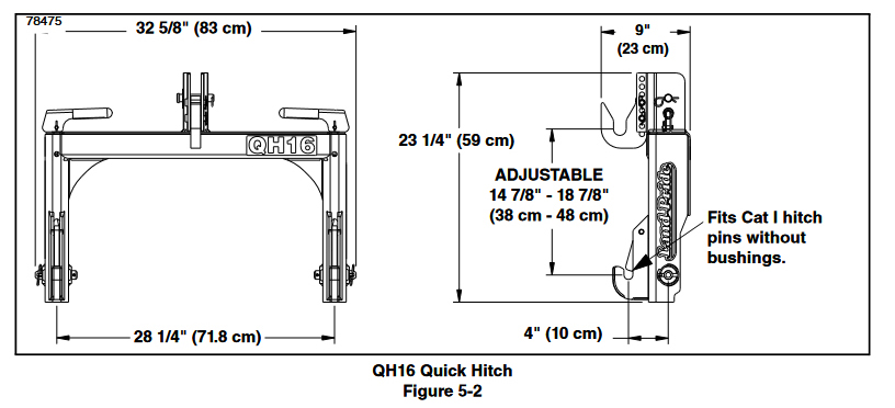

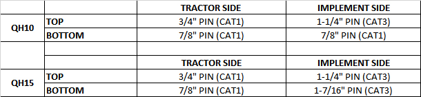

also
most CAT1 quick hitches are NOT CAT1 on the implement side, they're CAT2 so you need adapters,bushings,increasers to use your CAT1 implements with them.
The adjustable hook, couldn't that be modified to accept "pins" to make the adjustment quick and easy?
My QH is an older John Deere solid hook.

also
That's the case with my QH, all my attachments have the bushings.
🤔 I could (should) modify that.
