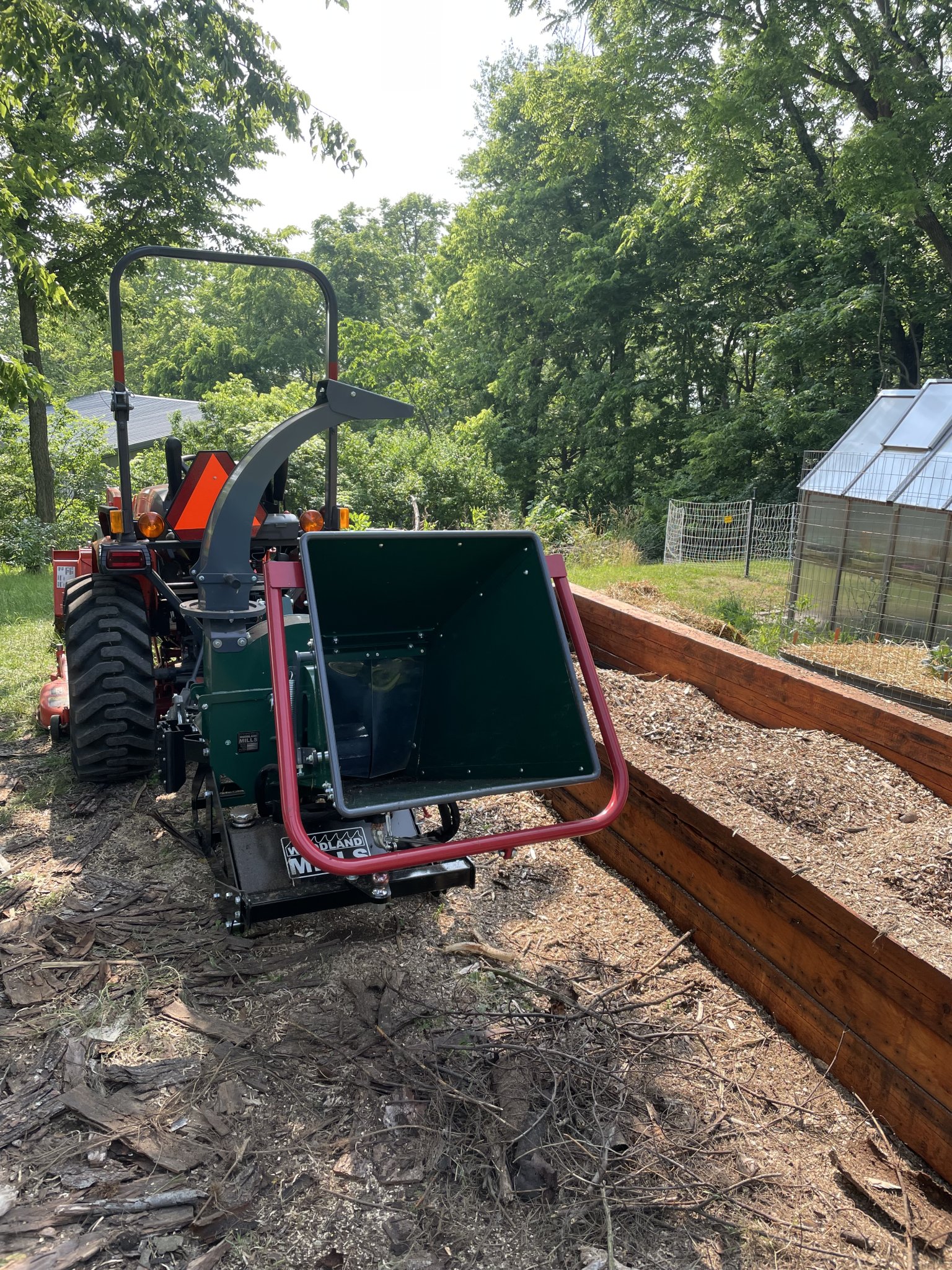

I have a woodland mills wc-68 which I use paired with my B…suits my needs. (I have no experience with another PTO brand to make a comparison). Makes great ballast too, but it hangs back a bit. As far as I am concerned it’s like an angry beaver and will take up to 6”. I don’t have any complaints with mine and I would buy it again. I Think if you go to a Paul Bunyan or logging show you might be able to compare some side by side and try. It be nice to try or demo before purchase, but I don’t have a brick and mortar place near me. I got mine as a drop shipment that was inside a metal crate…it was packaged well but one of the corners was damaged (not the sellers fault unless they loaded truck like that, but the machine itself was just fine…very well protected and packaged very nice and instructions easy to follow. I hope this helps.

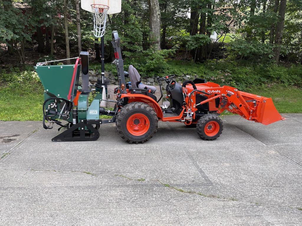

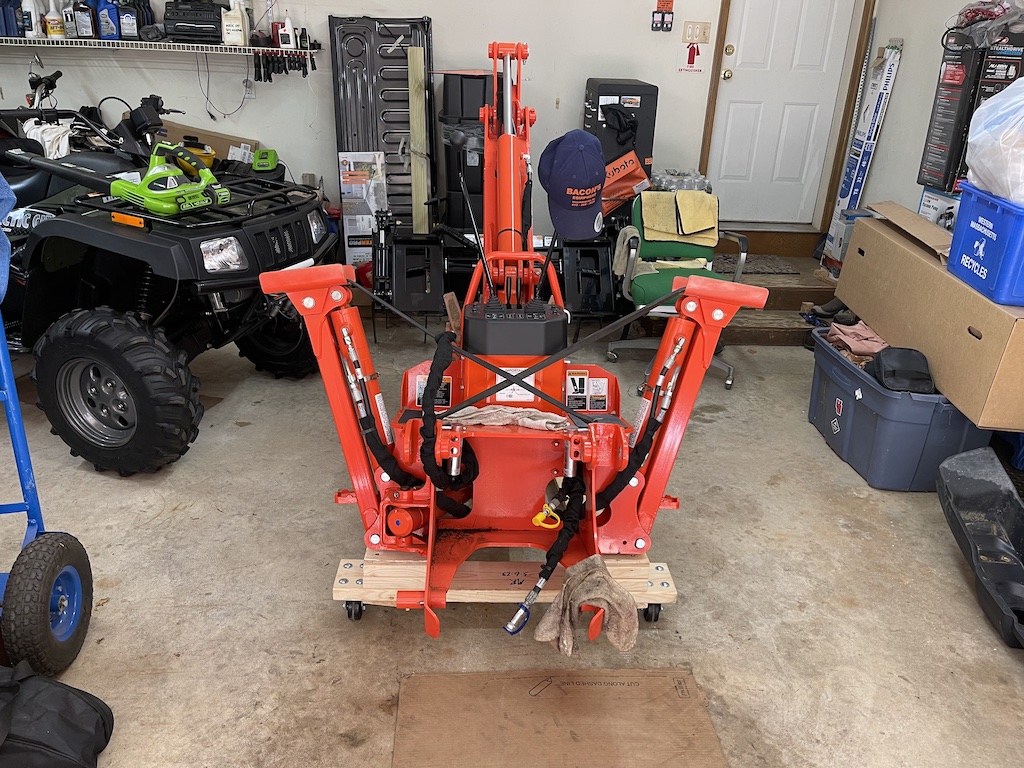

Here's my B2601 with my Woodland Mills WC68 attached; got in four hours of chipping today. Chipper is in 'travel' mode, with feed chute folded up. Had to take my BH70 off (first time since acquiring it 3 months ago), that process was much easier than I anticipated. My BH dolly works great, but rolling it around the garage really reminds one how heavy that BH is.
My WC68 had a slight hiccup today (it's first in about 20 hours of use); I had chipped up two loads of newly-cut birch & ash and the 'green' wood caused a clog in the discharge chute. It was really packed in there, took ten minutes to clear it out; easily done by opening the flywheel cover (one bolt) and rotating the flywheel backwards, along with using a screwdriver to dig out the clog. I sprayed a serious coating of silicone lube in the chute, then ran some dead pine branches through it, seemed to solve the problem. I will add that I had the discharge chute pointed to the 'left' (driver's side) which is not in sync with the spinning of the chipper's flywheel (clockwise when viewing the chipper from the rear).
I later fed a whole bunch of freshly cut long-needled pine without any issue; the chipper ate 6" logs and produced very nice chips which I used for my blueberry bushes.

How much chipping to fill a bed like you have there? I've thought about getting a chipper to make my own mulch, but I've been advised it will be way too slow and take a much greater amount of material to make any sizable amount than I might expect.

Good day. Happy 4th? What’s too slow? I did not time it with a stop watch…the raised bed is 20’x5’ and about 20” tall. For the amount of fill in the picture which leveled out to about 8- 12” +/- of chips…that took about or close to an hour I would estimate. I started with a pile of branches that were 4 or 5 feet high and maybe 8-10 feet wide at the bottom just to give an idea. IMO it went pretty quick. I sort of think the opposite about how much it makes…I think it makes more mulch than I expected.
So I guess I come back to ‘what’s too slow’…what does that mean? For me I still think a whole lot easier / faster chipping branches than cutting the tree up itself…I burn firewood and love the size that doesn’t require to split, so even large branches I cut up and burn in the stove…. but there is much more labor in cutting the tree than chipping the branches IMO. When you say 30 acres, does that mean selective timbering, or are you completely clear cut / timbering and left with a mountain of tree tops from 30 acres woods? Maintaining trails? To me chipping makes sense if you are already cutting up the tree anyway and you want mulch and plan to use regularly. For me personally I think it takes a lot of time to safely burn because you have to stand there and feed it not to mention it doesn’t take much of a fire before an individual will not be able to put it out if it gets out of control. If you have to stand there to feed the fire and haul water out to where planning to burn, at that point, then might as well mulch it it not have to stand next to the fire. The other issue for me with burning is the wind…it’s windy at our place and stars planets and satellites have to align for me to have nothing else to do on the days it’s damp out and low wind…you can chip when you want and don’t really have to worry about blowing smoke in directions you don’t want or the risk of a fire getting out of control.
I know you did not ask for all that, but ‘slow’ is not really any sort of criteria. Depending on what really doing with your 30 acres, I think trying one (rent or borrow or help someone that has one) might help convince you one way or the other.

I am sorry if I misunderstood….you can make 3 or so waist high piles in an hour very easily. I am not sure how much mulch that would be, but you will be thankful to have a loader on your tractor to scoop and move it. I think it produced more mulch than I expected from the little bit of branches…depends on what expecting…I don’t have a good way to estimate the volume. I keep the chipper at my residence where I only have a few acres…it makes more than enough for our muching needs on just a few acres…and that’s for gardens, chicken coop and pathways. We compost it too for soil amendments. That still really doesn’t explain volume though.
