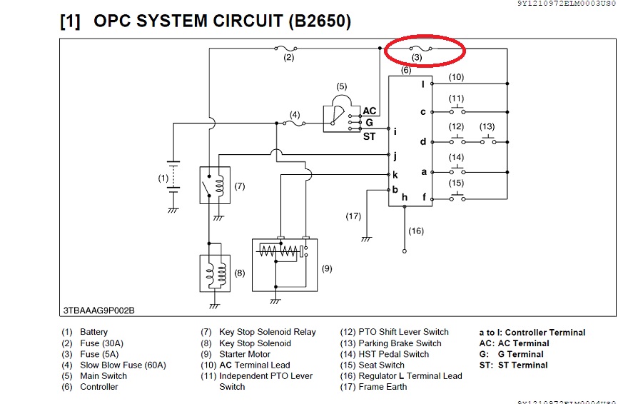

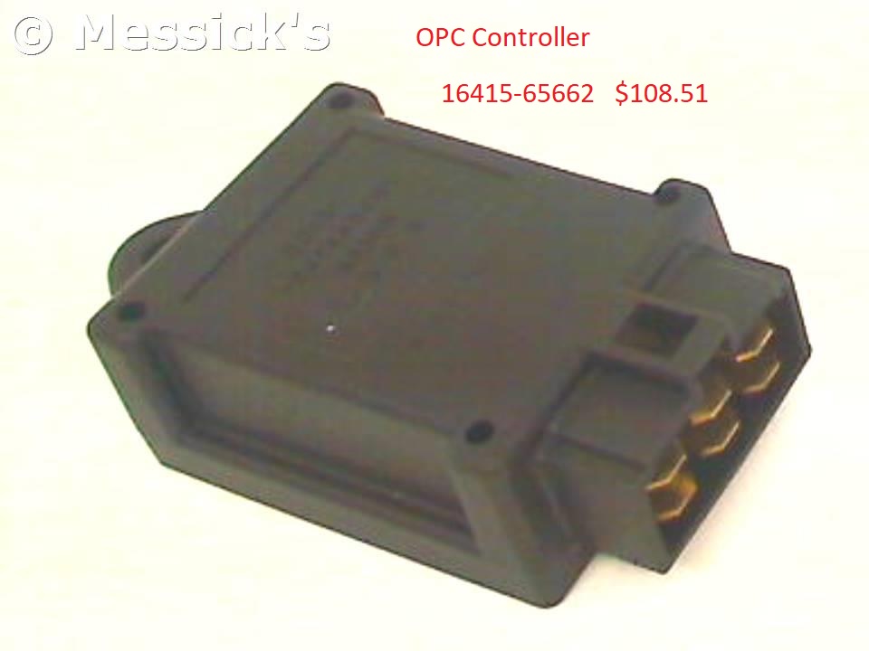

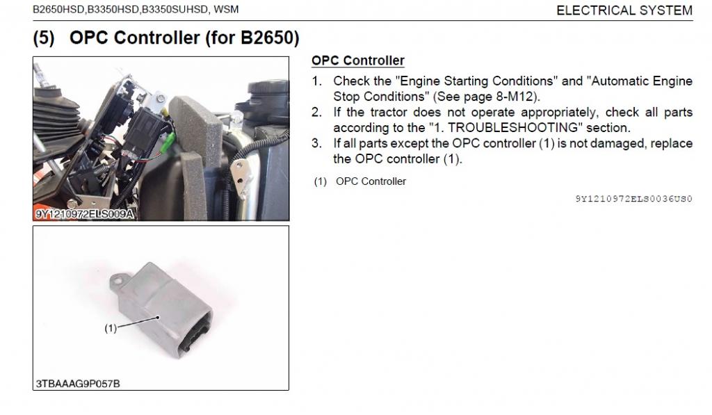

See attached photo of OPC. A plug in type connection easily done.
However, before deciding the OPC is faulty you need to rule out all the safety switches that feed it info.
I have attached some OPC info but for a different model tractor. This will give you a better understanding of the OPC system on any tractor.
