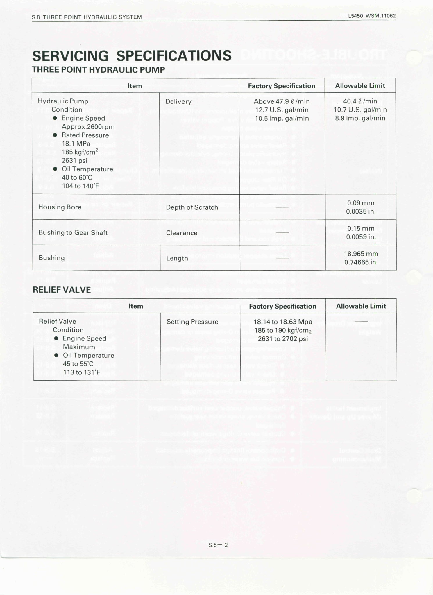

A aftershock New member Equipment L5450 Jan 31, 2025 1 0 1 ontario, Canada Today at 1:59 PM #1 I have a 22+ year old L5450 I suspect the hydraulic pump is failing. I am putting together a pressure gauge to plug into the rear remote. Does anyone know what I should read on a healthy pump and a number where I should look at replacing? TIA.
North Idaho Wolfman Moderator Staff member Lifetime Member Equipment L3450DT-GST, Woods FEL, B7100 HSD, FEL, 60" SB, 743 Bobcat with V2203, and more Jun 9, 2013 31,322 7,180 113 Sandpoint, ID Today at 3:04 PM #2 The pump might be fine and your pressure issue could be from the pressure relief valve not working properly. You're looking for 2400PSI - 2500PSI FYI, it's a 33 year old tractor.
