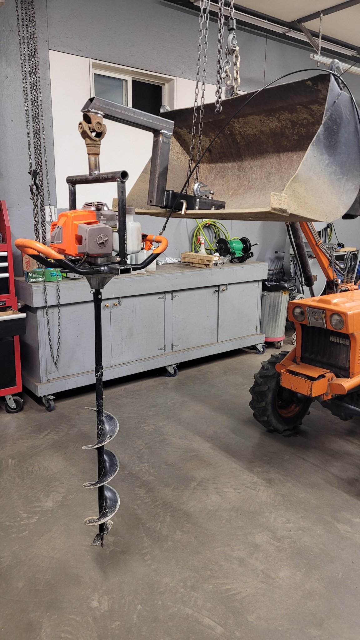

This is one of those ideas that on paper is trash, and in reality is not any better. I knew that going into it, but desperation, lack of mental acuity, and curiosity about things that will potentially get you killed in interesting ways, lead to me proceeding with the design (that's stretching that word) and manufacturing of this thing that rhymes with smismortion.
I have an actual 3-point PTO post hole auger, but the B7100 just can't quite do it due to the limitations of the ability for the 3-point to lift at such a length. I also have a hand auger, which is a 63cc piece of Chicom garbage attached to a screwy death thing, and the problem with it is that it tries to violently remove your arms when you hit anything hard, and you often get it stuck so you can't pull it back out of the hole.
Solution, mount hand auger on tractor bucket. Simple? Yes, so simple that if it was really a good idea you'd just be able to buy this commercially, but for some reason it's not available. Hmm.

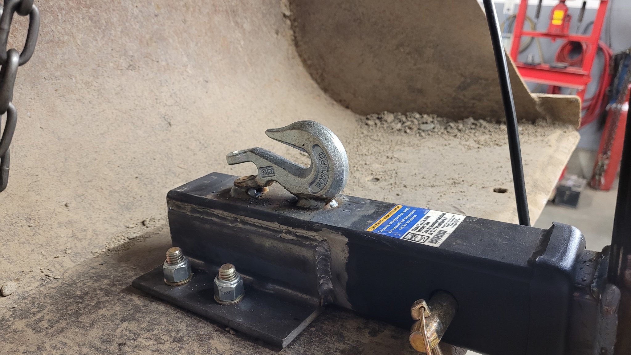

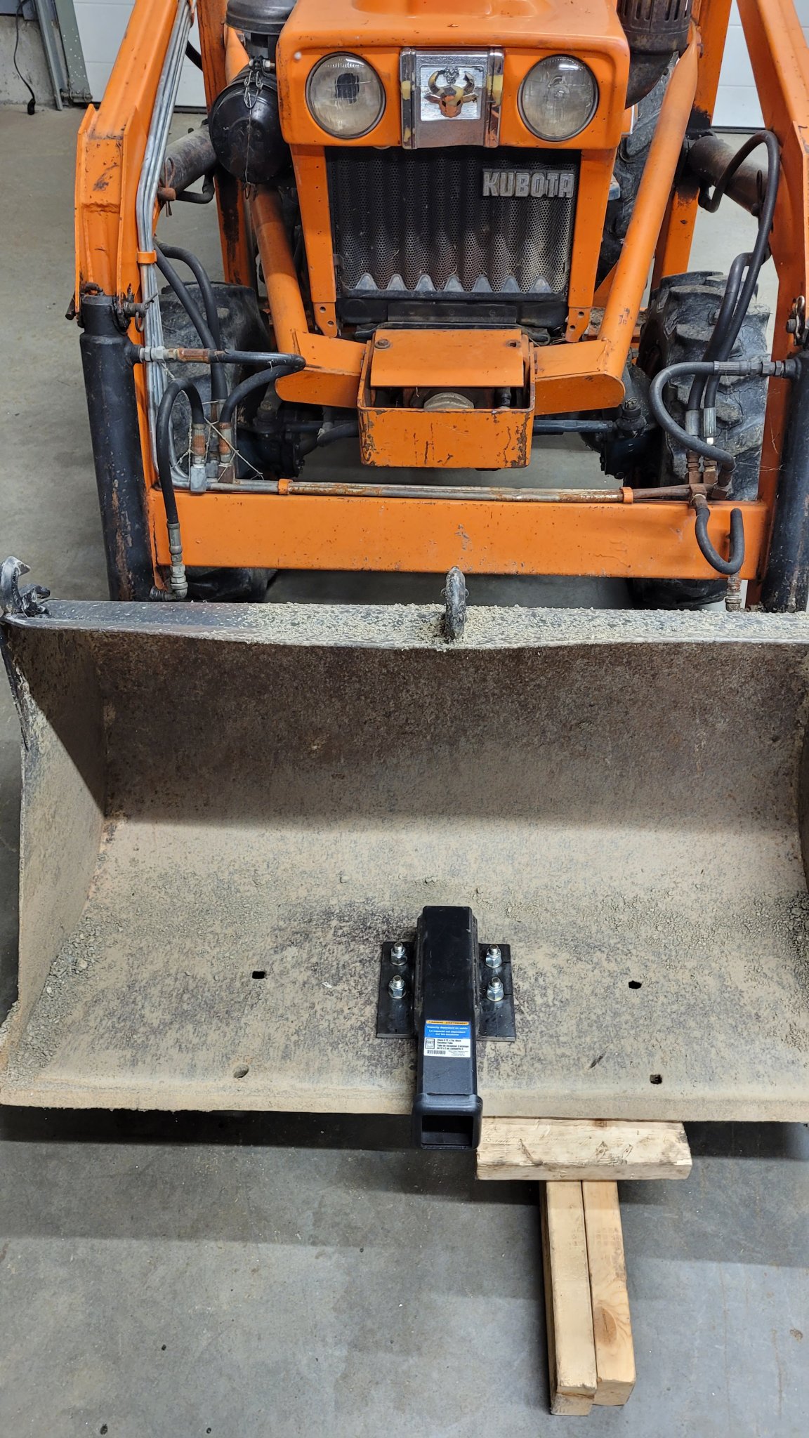

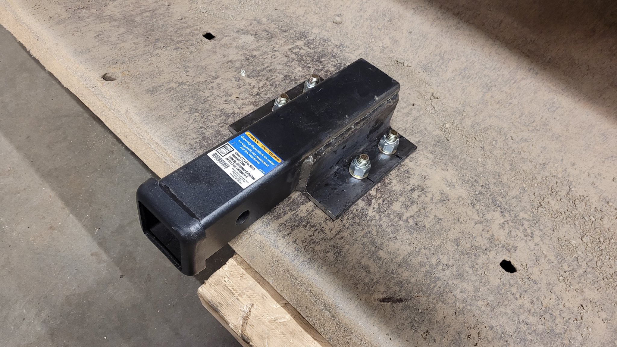

First, I needed some way to interface a mount. I also use my tractor to move my utility trailers around quite often, and I just have a hitch that I bolt to the bucket, it's not great as it's only a single bolt and all that. So I built a proper receiver that would bolt to the bucket. It's just a PA weld on receiver (which oddly comes painted), with some angle iron welded to the sides. The bucket already had the 4 hole pattern torch cut in it, so there was no modifications required to the tractor.
I also welded a grab hook onto it for safety chains. I meant to weld a loop on too, but in my excitement to build the auger attachment I forgot.

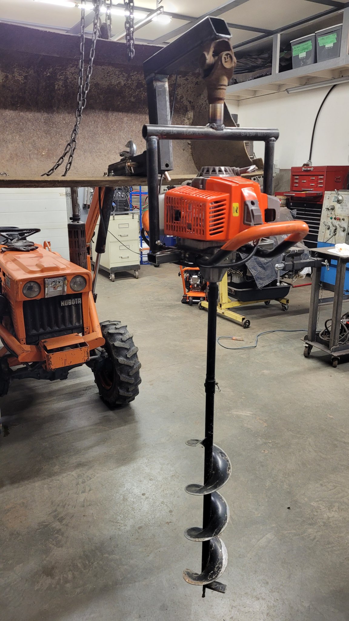

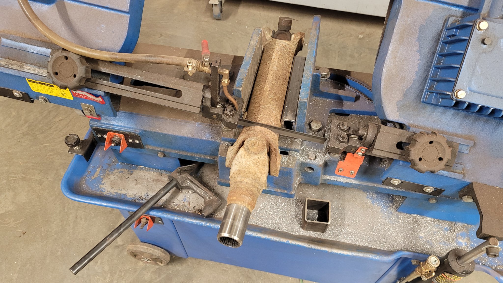

So on to the auger. Some sort of a gimbal is required so the auger will always hang straight up and down. For this I looked in the scrap pile, and I found an old driveshaft from a Jeep TJ. There's a reason I save everything, it's so I can do stupid things later.
In my excitement I stopped taking pictures, but this is just some scrap 2" HSS and Sch 40 pipe. I did have to weld some mounts onto the auger itself, which turned out to be a total PITA because the tubing for the auger is paper thin.

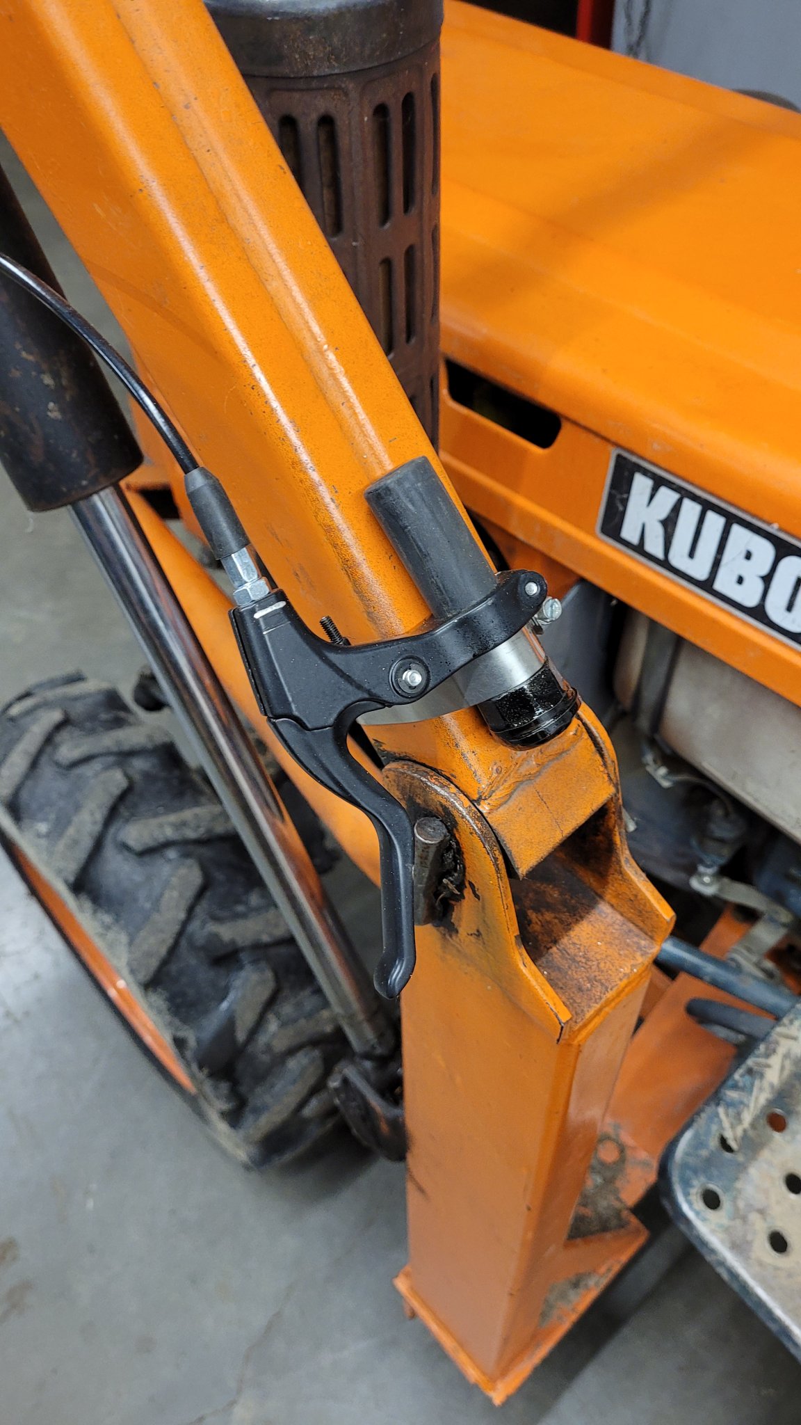

For a throttle I used an Amazon special bike brake lever, and a cable from some sort of ATV or SxS that I modded to fit the brake lever. It mounts to the loader using more scrap pipe, and a hose clamp. There's a few zipties to hold the cable along the loader frame. It just pulls the throttle lever on the auger, so you can still use the throttle lever as normal when starting the auger.

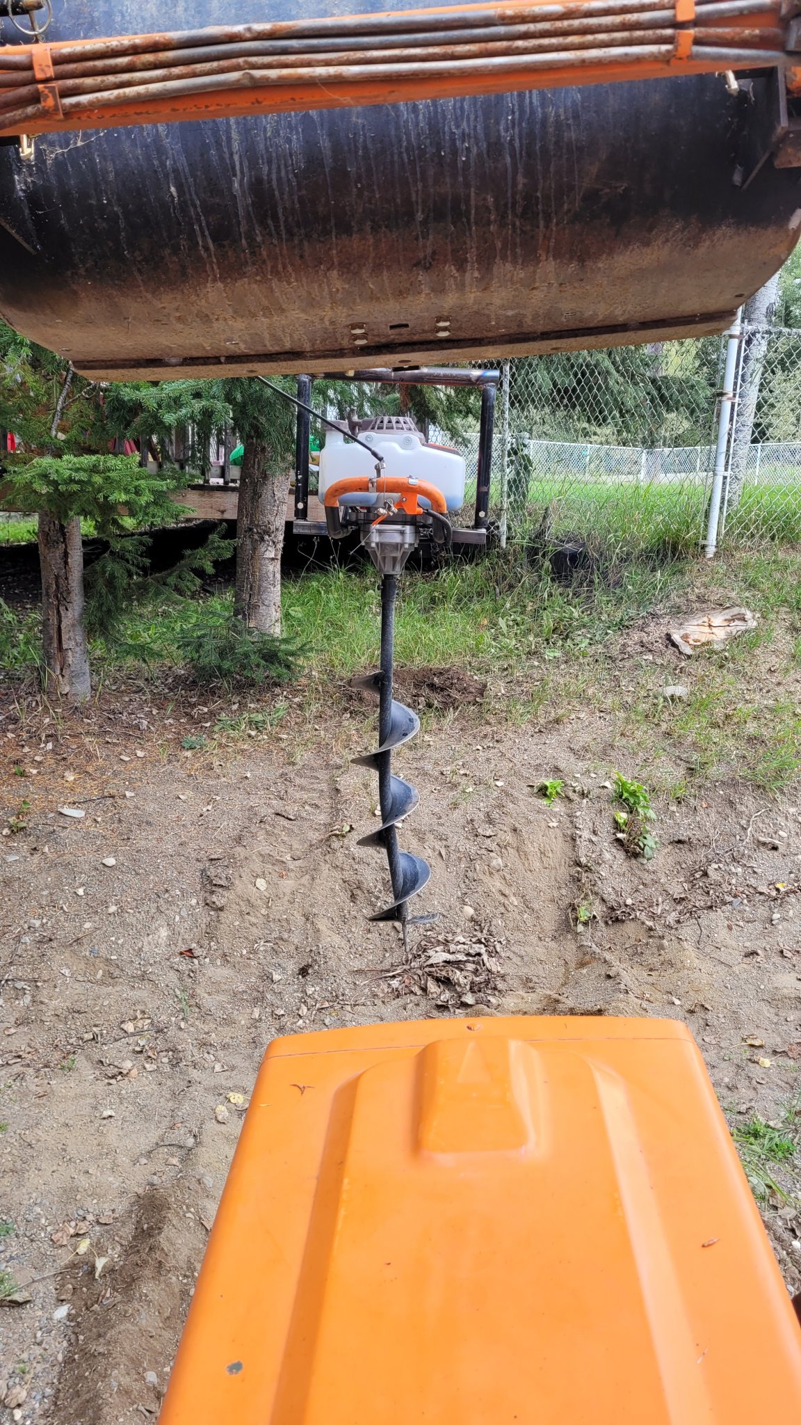

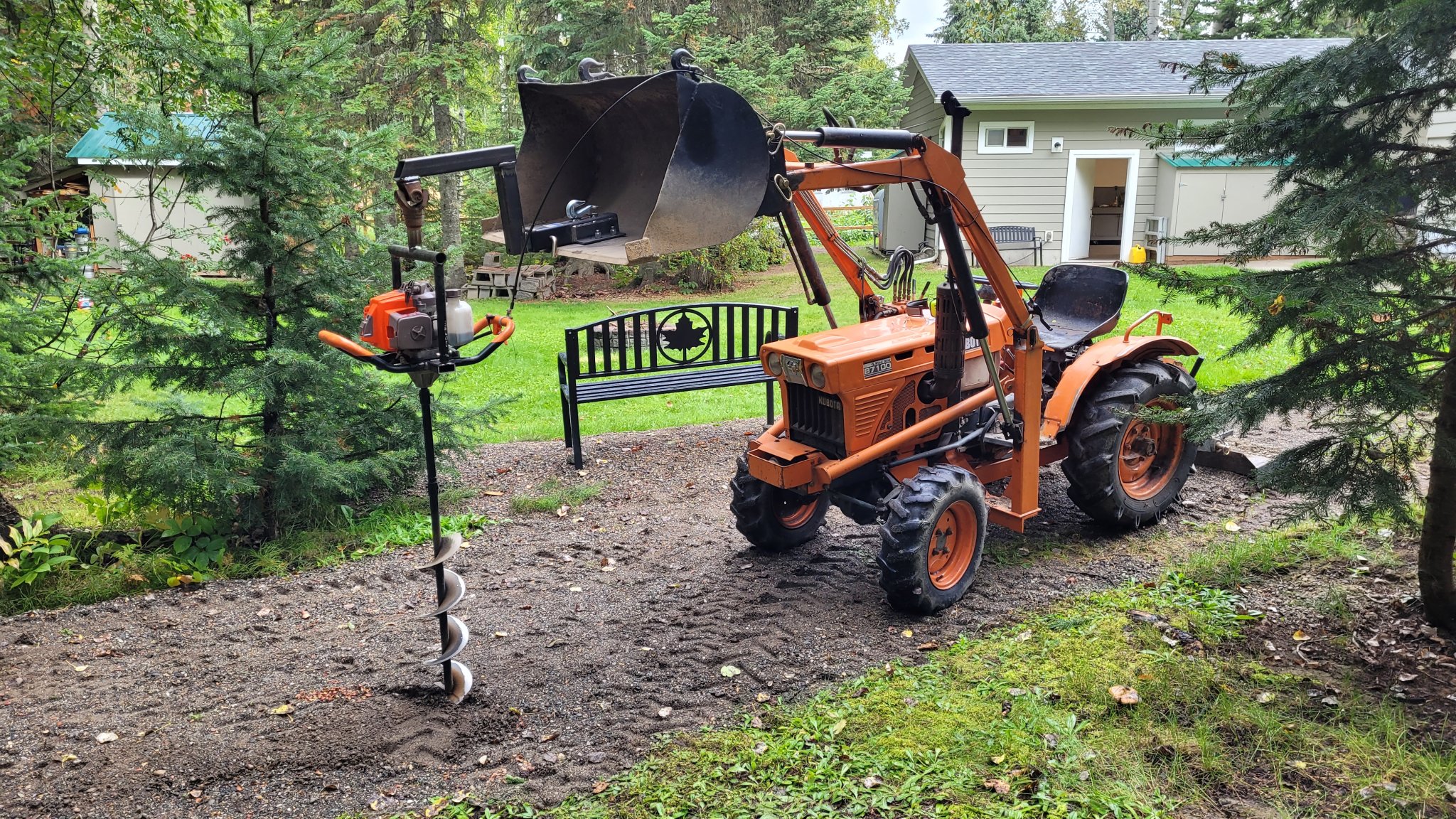

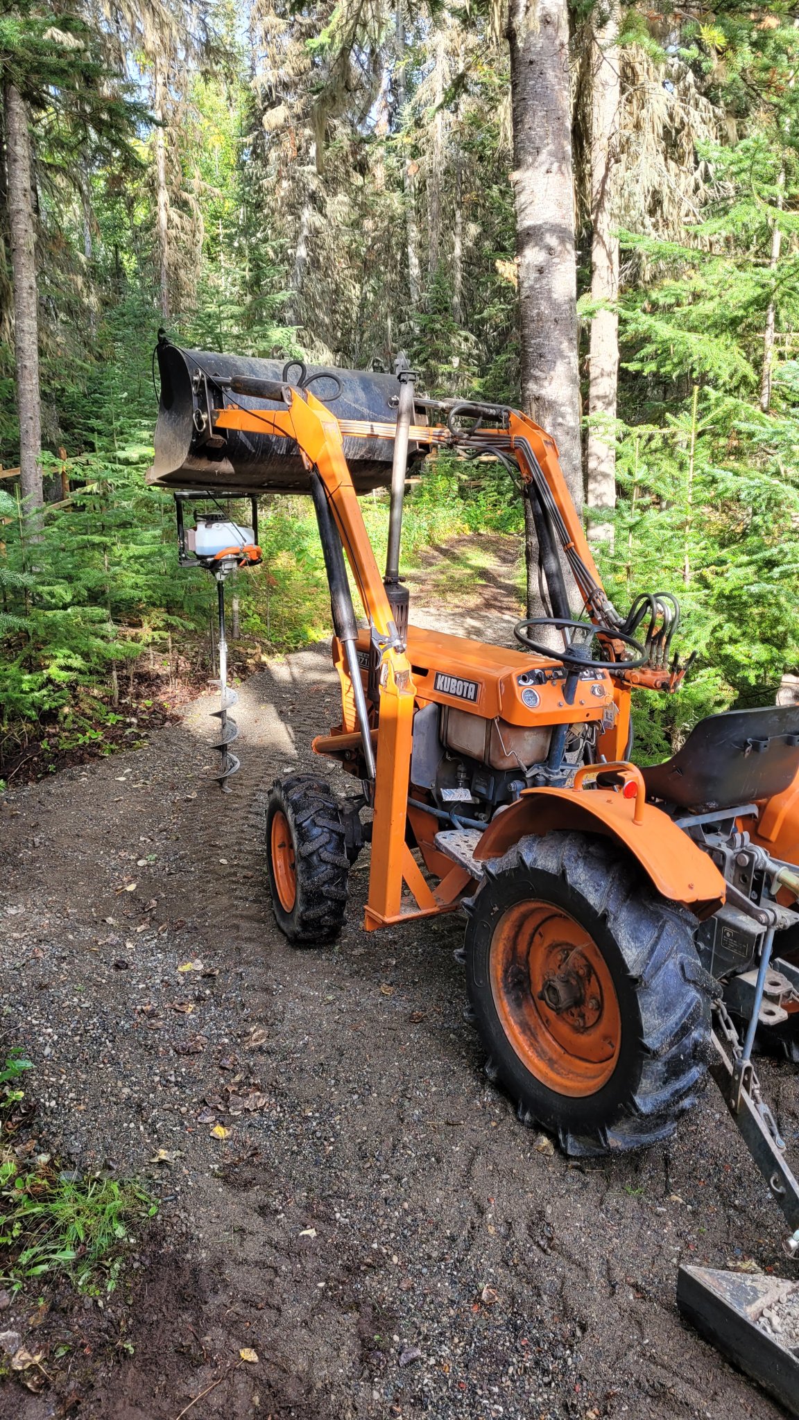

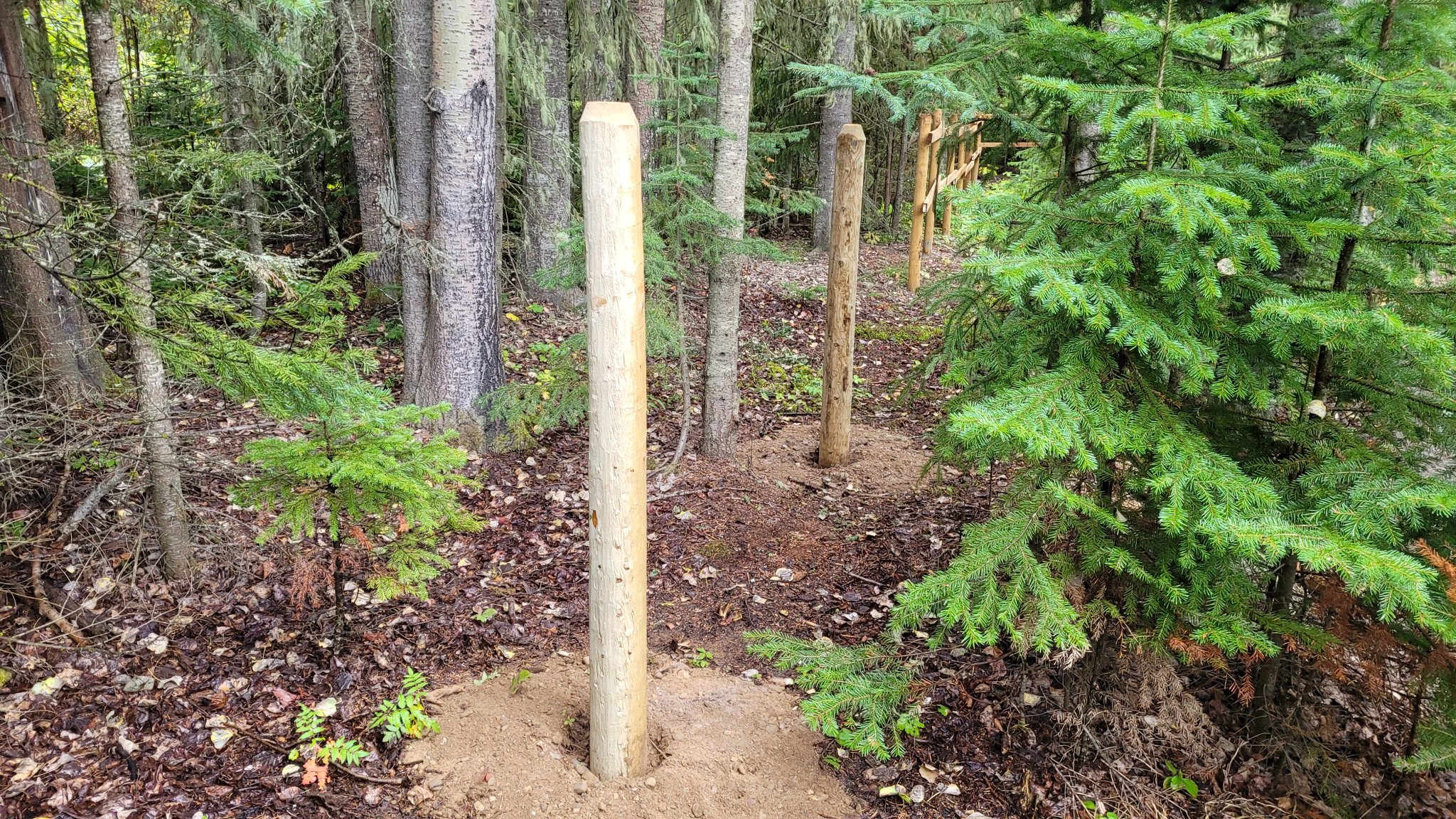

This actually worked reasonably okay. Assuming you redefine the word okay to be the same as crap.
Then on the second last hole the tractor rolled back while the auger was in pretty deep, apparently I should get around to adjusting the brakes (well, ordering shoes first), and it turned the auger into a banana before I could jamb it back into gear and get straightened out:
A new auger is like $40-$100, depending on quality. I have one hole left, so I'll probably just dig it by hand.
Overall this was much better than using that auger by hand, as it was a terrifying tool with more than enough torque to dislocate a shoulder. I think if I had done a better job of the fab work, had a better auger and powerhead, and put some bungees on it to limit how it swings around when you're moving to the next hole, it would have actually been a decent tool. Plus fixing my brakes would be a good idea.
The real issue is that these 2 stroke augers is that they don't produce enough auger speed to properly evacuate the hole. This is the biggest (63cc) Chicom special I could find, perhaps there is bigger/better ones, but at that point I think you've really got to question what sort of absurdity you're subscribing to by spending the money on it.

1. Impressive you were able to fabricate a working front auger with a mount out of your scrap pile.
2. The whole thing is a low speed, light duty set up. (Not a criticism, just a fact.) In light of that, I’d probably put some effort into straightening that auger close enough to work.

Good luck. Biggest challenge will be keeping the auger vertical. You'll have more forward motion than down with the bucket arms at the height shown and will have to continually counter with dipping the bucket down or up at the same time depending on the direction you're going. Any time you get off, the auger will bite into the walls and shear the pin and/or bend the bit.
I agree. I would straighten the auger enough to do the last hold, and use it n the future. It doesn't have to be perfect because it would only waller out a bit bigger hole if it isn't.
Well, seeing as how I managed to use it to auger out the 14 more holes I needed, and only bent the auger because the tractor rolled back 2 feet while it was in the hole, I'm sure I will take into consideration how it won't work.

Off the top of my head, the only thing that I might change would be the "drive shaft 4 way" swivel mount.
I think the "left to right" needs to be fixed in place, so the angle of the auger is only adjustable "fore to aft" with the tractor movement to try and keep it vertical??????
