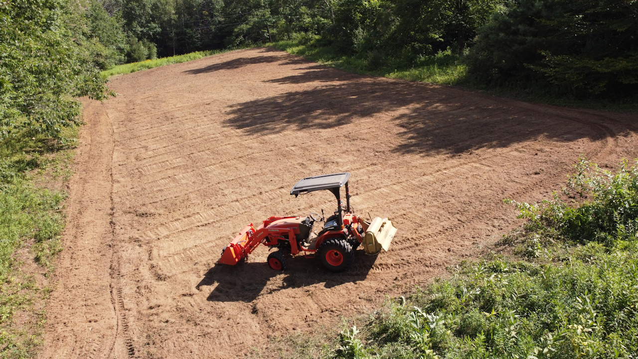

Hey Robinson and welcome to the forums. You are making a decision I myself was making several months ago. I own a year old L2501 and next year I plan to finally put in a good size garden. I will not be doing 2 acres as you are, but the rest of our situation is pretty similar. I was looking at putting it in what was previous horse pasture with thick bahia grass. I was also debating between a Disc Harrow or a Rototiller. Ill share here what I ended up doing and how its worked out so far and hope you will find it helpful.
I ended up going with a disc harrow over a rototiller. This was primarily because I landed a great deal on one from a coworker. It had never been used but had sat out for over a year under a tree. Aside from some dirt and just a little rust, it was in excellent condition. It was a Frontier DH 1176. I will include a picture of one below. He told me to take it for free but I insisted on paying him $500 and he finally took it. From my research it was worth around $2,000. I just couldn't pass up such a good deal so this largely decided the question for me. I had began to lean toward a disc harrow anyways however, for a couple of reasons: You can pull a disc harrow in wooded areas, and I have an ongoing project of clearing wooded areas around my property and expanding my yard space. A disc harrow in my opinion just is a better tool in these areas than a rototiller. A rototiller would be hitting tons of roots and other things in these areas. This was a big deciding factor for me. I also had experience using a disc in wooded areas before and felt it worked really well.
When I first began considering my co workers disc harrow I made a thread here. My primary concern was whether the DH 1176 was too big and/or too heavy for my L2501. The DH 1176 is both wider and heavier than the allowance for a disc harrow in the L2501 owners manual, but not drastically so. It is a beefy, heavy, well built disc harrow though, so I did have some concerns that I would struggle to pull it. Some on this forum told me I wouldn't be able to pull it, that it was too heavy for the L2501. I ended up getting it because the deal ended up being too good and have since used it extensively on my property, both in wooded areas and in putting in my new garden plot for next spring.
So how did it go for me? In my case, I got the Harrow and immediately put it through a lot of fun tests. I was really curious how the L2501 would handle it. It turns out the L2501 handles the disc harrow just fine. Ive had no problems at all pulling it in any situation Ive put it in. In woods with thick leaves and clutter and roots, or in well tilled loose soil in my garden plot where I can bury the discs. If I set the front and rear axle of discs in the most aggressive setting, I do have to put the tractor into 4WD to pull it. This has been the only caveat. If Itry to stay in 2WD at the most aggressive setting the rear tires will begin to slip and then spin - Meaning I dont have enough weight. Weight is THE decider on what you will pull on your tractor, so before I began this post I looked up your tractor weight which is listed at 1554 LBS (No FEL or anything attached) My tractor weight is listed at 2623 LBS for comparison (again no FEL or anything) I also have liquid balast in my rear tires that put me a little over 3000lbs. The FEL with bucket is rated I believe around 1,000lbs as well, so before I attach the disc harrow my L2501 is sitting somewhere just over 4,000lbs. The DH1176 disc harrow is 76 inches wide and weights over 700lbs.
What is the best choice for you? It will depend entirely on your application I think. If you want the best solution for a garden, I think the rototiller is the better option. A disc harrow can make a patch of ground look very similar to what a rototiller can, so you can achieve roughly the same results with either, but a rototiller is just much quicker about it in my opinion. For me to break in my new garden plot and go from grassed pasture to soft, fluffy garden spot, I had to take multiple passes over the plot. A rototiller would have broke this ground in much faster, and would have broke the grass down easier and more efficiently. A rototiller is also substantially easier to pull for the tractor, so if you have no ballast in your tires, and especially if somehow happen to have no FEL on the tractor, you will be pretty light. Weight is king when you start talking about pulling something, and especially pulling something with a lot of resistance. Horsepower will not be your limiting factor. You have a 29 horsepower tractor, I have a 25 horsepower tractor, but I suspect the weight difference would mean the L2501 likely pulls more. What will happen is your tires will just start spinning and you cant get traction - This is a problem of weight foremost, and traction secondly, not engine power. If you do find applications where you think a disc is more preferable, as I did in my case, I would suggest keeping it under 600 lbs and under 6 foot in width, and look for one that offers some adjustments to its aggressiveness. In the end both options will but you in a nice garden. One relies more on your PTO power while another relies more on your tractors ability to pull. The jobs you want to accomplish with this new option is what I would let decide which route I went.
This is what my harrow looks like:
