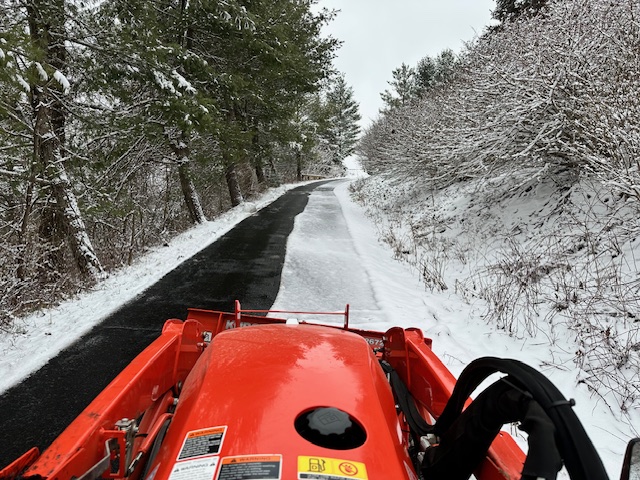

As my late neighbor used to say, "Let's do something even if it is wrong."
So I did.
Picture shows the left side clear after going downhill with my blade and its new rubber edge in float. That really squeeged the snow off, but sandpapers the rubber.
I can't plow well going up hill, though the snow was very wet and soft so I did a little that way. The asphalt seems to have melted some snow as it hit.

"Let's do something even if it is wrong." 😄
If I said it once, I've said it 1,000 times (10,000?).....;)
Like I said, I've gotten this wrong a few times this season.
I'm sure that is much more steep than it looks in a picture......looks like a very nice paved but steep driveway.
Your B2601 with blade doesn't plow that little bit going uphill?
Do you have rear ballast on the 3 point hitch? 3-400+ pounds on the 3PH can help plant the rears for traction. Sometimes I carry my box blade for weight if we get a lot of snow and I need extra traction.
What tires do you have? R4, R14, or R3?
Are the rears loaded? In 4WD I'm sure? Doubt you have chains on the tractor or want them. I wouldn't on a surface like that in Virginia.
Worse case, plow downhill one side. Head back up with blade lifted, then angle to the other side and repeat downhill for the half.......
Your B2601 with rear blade doesn't plow that little bit going uphill?
It's a front blade on my tractor. Most of our driveway slopes 20%. There's a curve at the top, where it turns toward the hose, that is steeper. Tires are loaded R14s.
Yeah I pretty much plow downhill. I can take take a small bite going uphill . . . Very small!

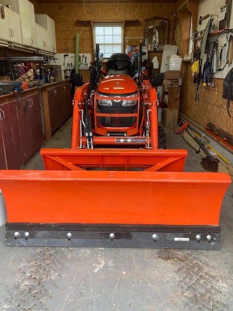

...............Picture shows the left side clear after going downhill with my blade and its new rubber edge in float. That really squeeged the snow off, but sandpapers the rubber..................................
That looks quite good. Does your setup allow you to float just the blade or are you floating the FEL? If the weight of the FEL is on the rubber edge it is a lot of abuse.
We made a rubber edge for a rear blade at work from the tread part of a tire. It held up for years of use on a combination of blacktop, crushed stone and dirt. The biggest challenge was cutting the tire and making holes in it so it could be sandwiched between the cutting edge and the moldboard. We did think ahead and made it wide enough to flip when it wore down. Never had to flip it because the tire is many times tougher than cow mats. IIRC we had about 2" of rubber below the cutting edge.
