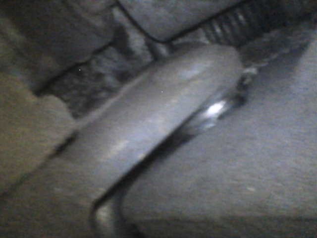

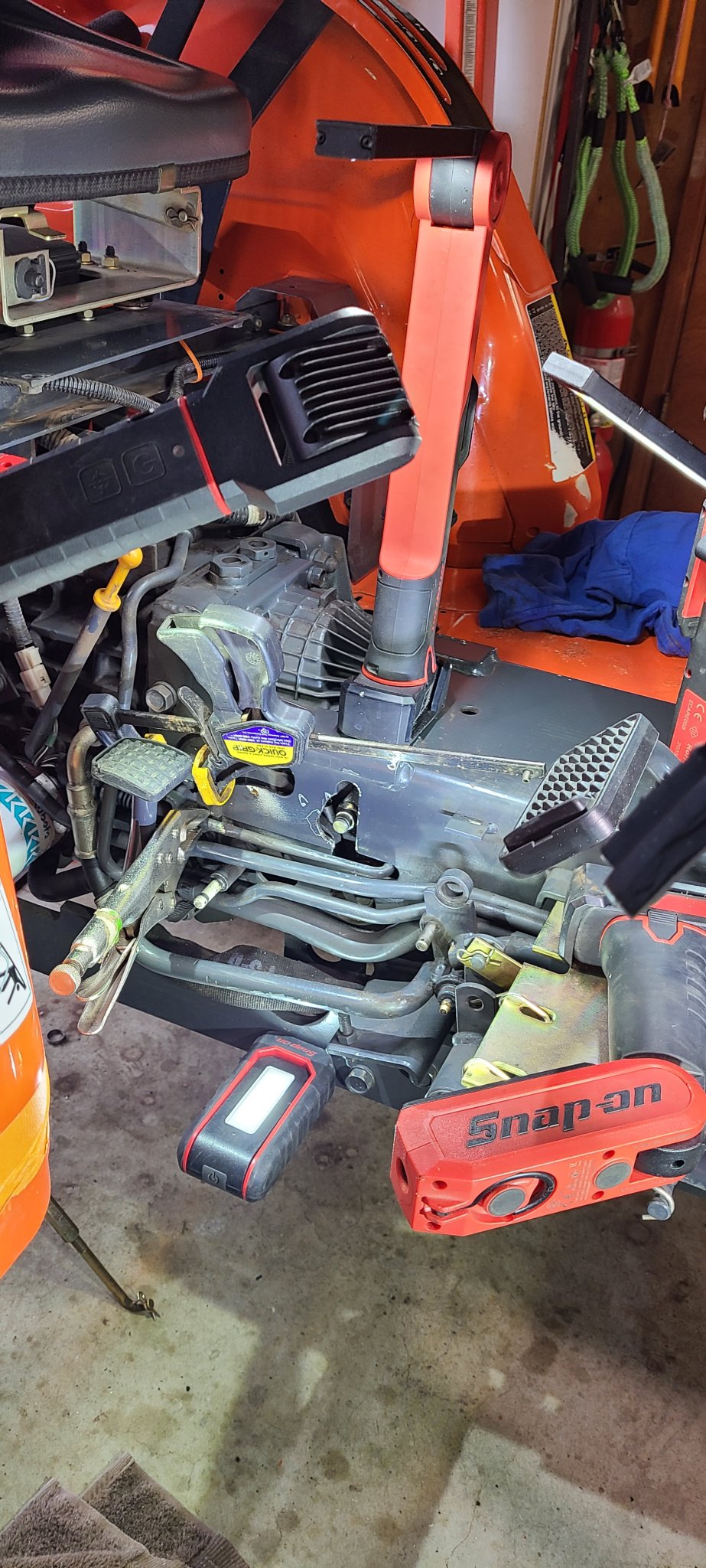

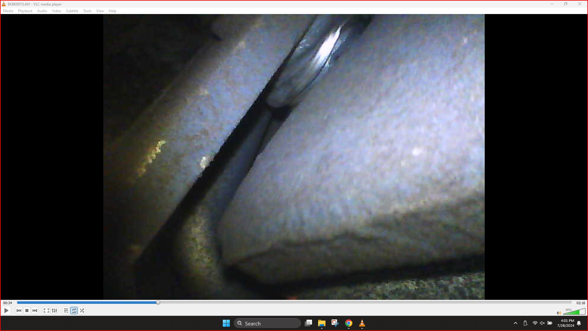

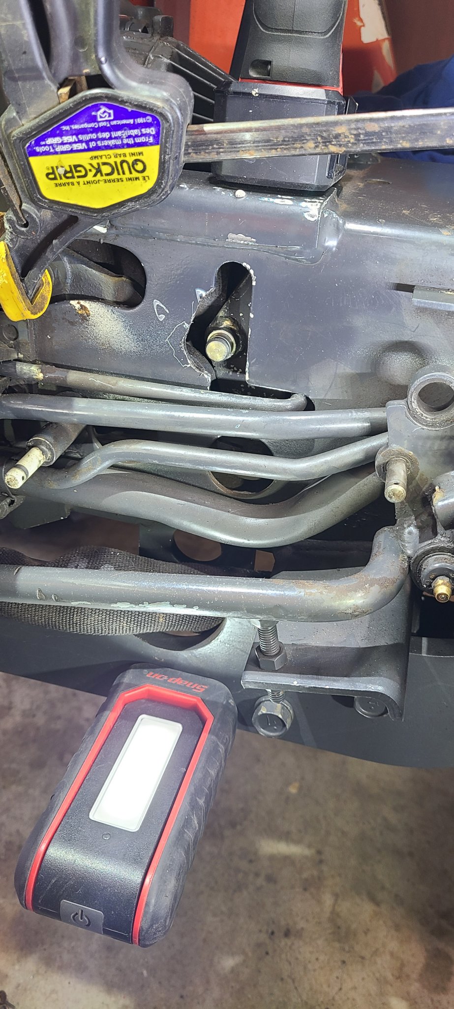

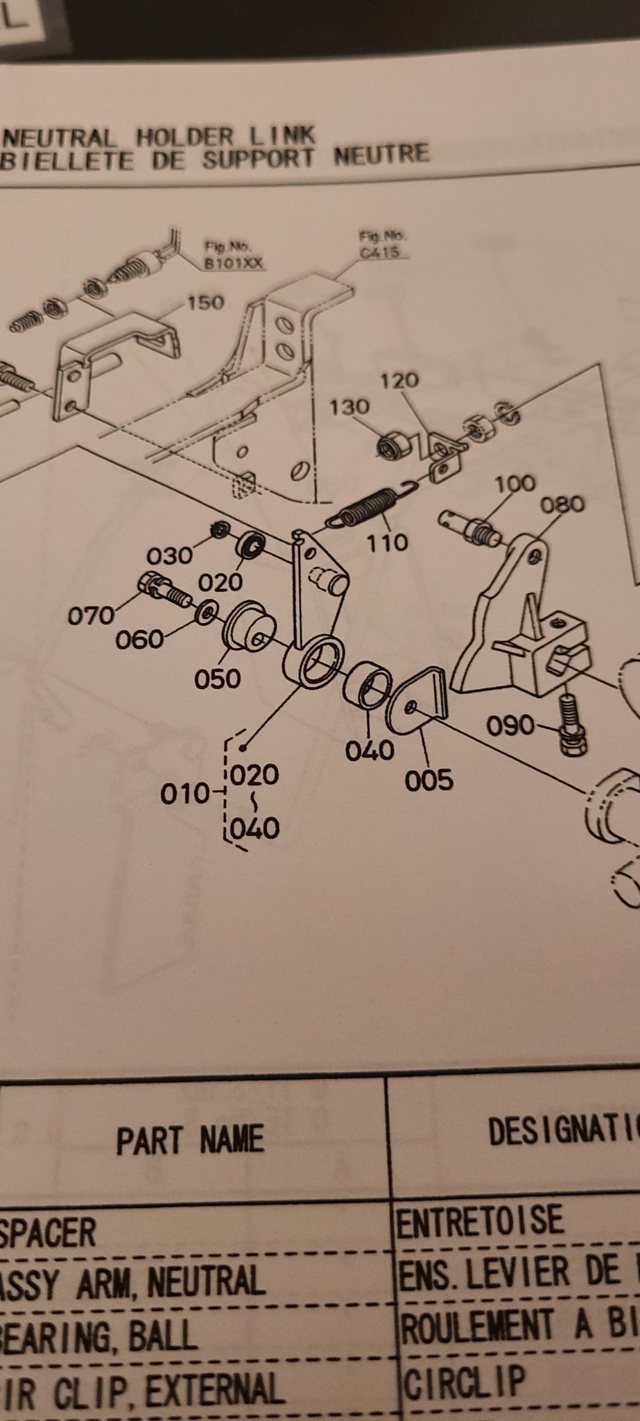

I have B-7800 that has play in the forward/reverse pedal. What I found was a worn bushing mounted lever mounted way inside on the transmission I think this looks like a problem. What it does is make the forward/reverse pedal have travel in the neutral position. The year is a 1993 HST B-7800. I have parts manuel and a owners manuel so I am trying to find what I need. Any help would be apprieated
10,603
4,477

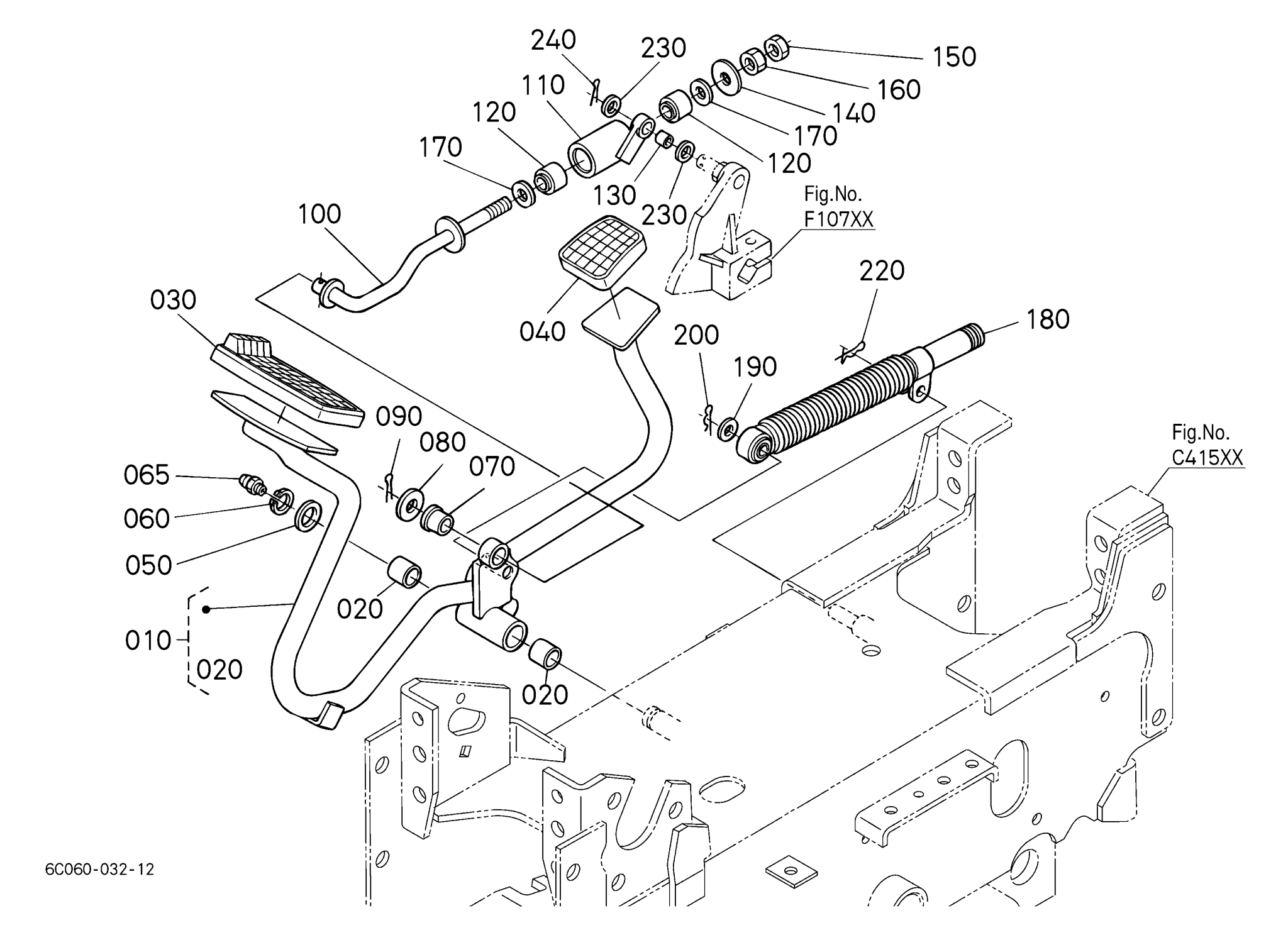

Curious was I....Probably 2 pcs of #020, bushing $5 each ?? Maybe #070, while your at it ?? Check for slop at #100-120
