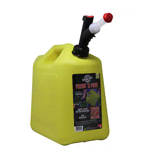

The plastic tube/funnel on the world's most poorly designed fuel tank ejected itself into the long tube of the Kubota L3560 fuel tank as I was filling it. I could not find it with my snake cam, so I just kept working. Went from 3/4 tank down to 1/8...no signs of fuel blockage. The piece is so big I think it wouldn't be able to block the fuel line, but I am wondering if it will break down / dissolve over time and damage the engine.
Removing/replacing the tank looks like one of those jobs I would probably f-up somewhere along the way. Picture shown below - the spout is the white piece. If the spout was made out of the same kinda plastic as the tank, I wouldn't even be asking, but I could not find out online what kinda plastic the white piece is made of.

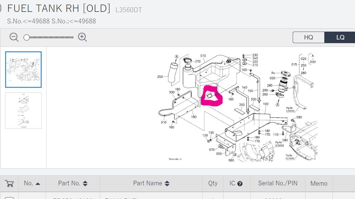

hmm.. do you have 'easy' access to the fuel tank sending unit ? Bigger hole, easier to retrieve.
Plastic will be there until the sun novas but IF a chard(small piece) broke off it WILL eventually get stuck in the exit spigot.
Heck, at least it's WHITE ! My little chard was BLACK and NO way anyone could see that in the black tank !!!

I would take some more time and get the spout out of the tank!
Drain the tanks empty, and pull the cross over pipe to fish out the spout.

There is no fuel sending unit in that tank. ;)

hmm TWO tanks..... fill the right, sender is in the left then.......
so... as other say
put LED light and camera in the 'filler tube', remove from crossover port..
should be a 'fun' time....
