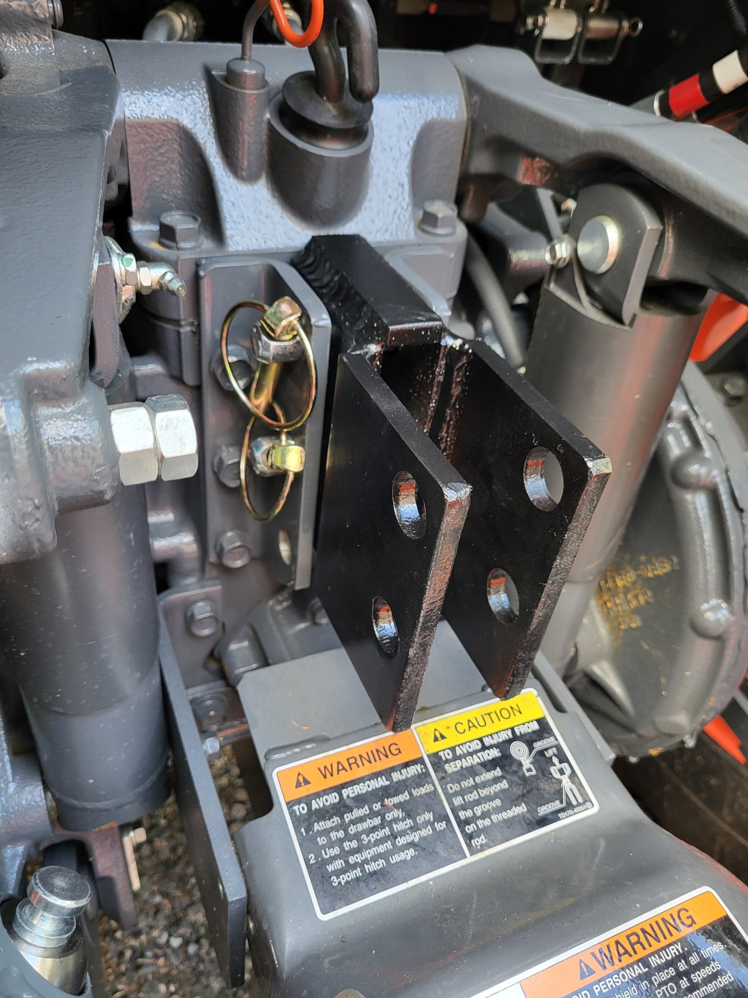

Would like to apply a set of Pat’s Quick Hitch’s to a 2005 Kubota L3430. I’ve seen posts where it may be necessary to buy an extended top link also for the setup to work properly. Can someone confirm or deny this and please advise of the needed top link required? Thanks in advance.
Installed Pat's on my L6060. The standard Kubota dealer hydraulic top and tilt kit top link was too short for reaching implements. I measured the amount that the Pat's extended my lower 3 point arms (4.5 inches in my case) and had a local weld shop fabricate a tractor side extension bracket. Works great and easily removable if necessary. Good luck.
