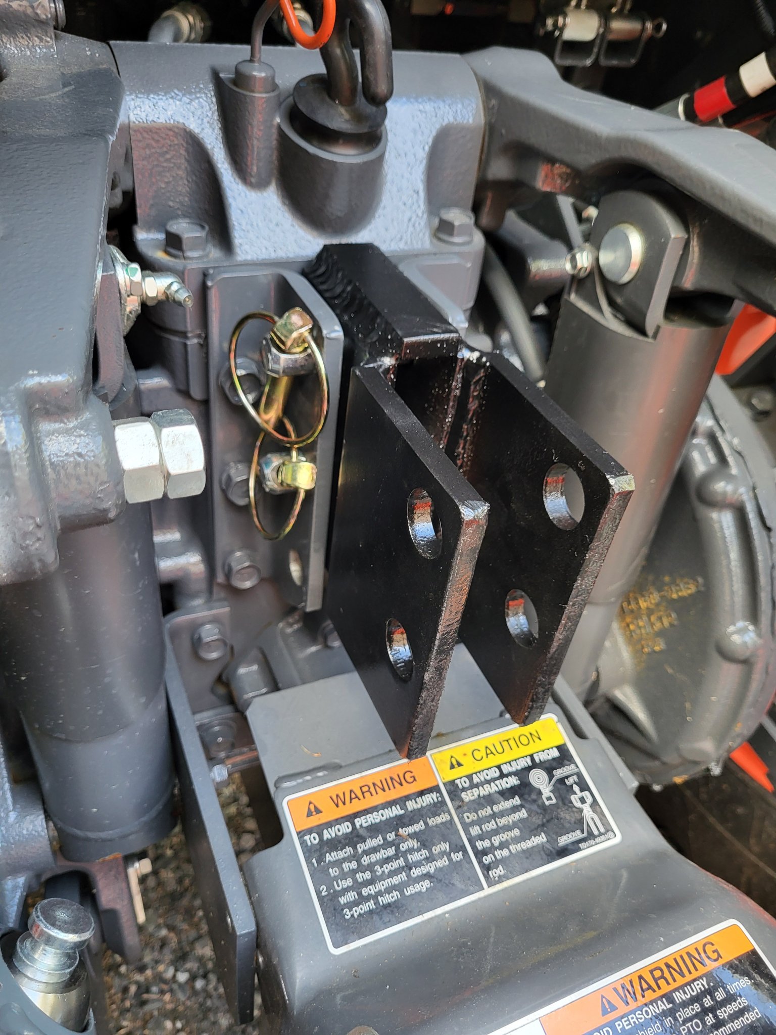

I have a Pat's Quick hitch and then added a top and tilt kit. Even after telling the dealer I needed the extra length, the top cylinder fully extended was too short. The dealer didn't seem to understand the isssue. So I went to a local weld shop and had them fabricate an "extender" which mounts on the tractor side to push back the top link attachment point (about 4.5 inches as I recall in my case), You will want to measure how far the Pat's pushes your mounting points back. Works great for me. Perhaps this solution will work for you?
