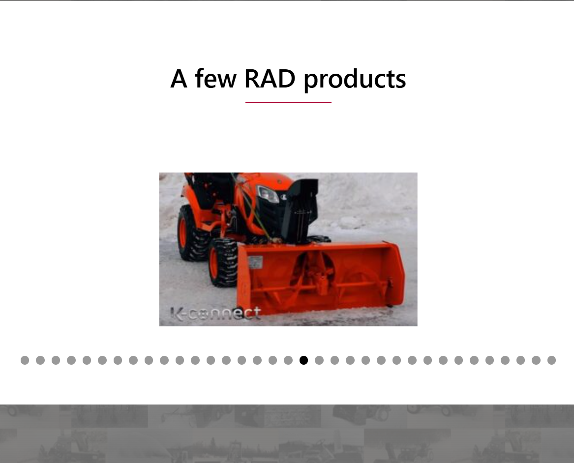

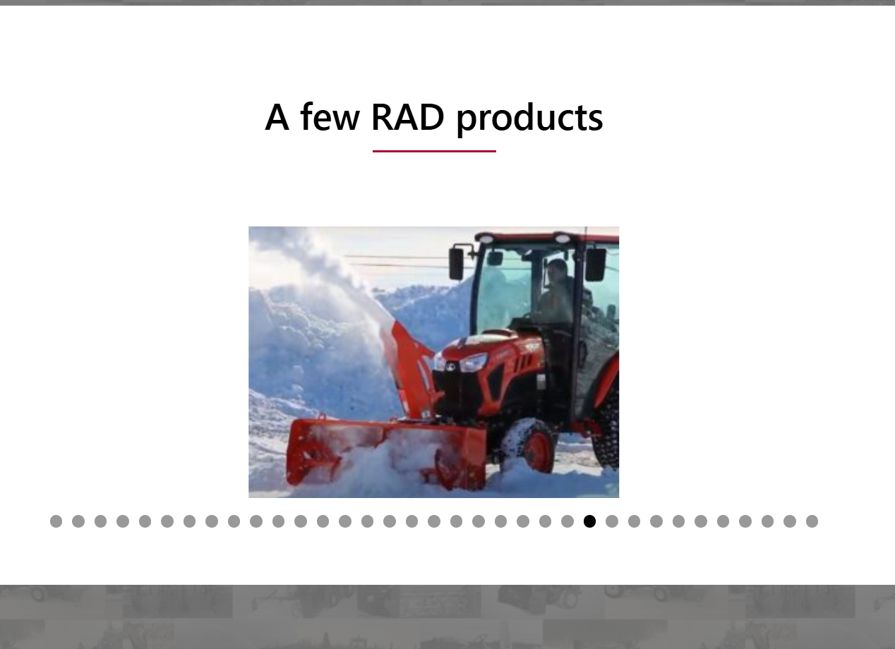

Kubota snow blowers are usually made in Kansas by Land Pride.
Wrong, Kubota front mount snowblowers are made by Rad Technologies in Quebec, Canada.
