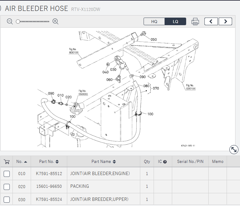

Did you open the coolant bleeder valve while filling the radiator?

will admit i have not looked real close for a bleeder valve on hose on front of engine, will look for that tomorrow the hoses going to the heater are cold also, if that helps define anything. never dealt with anything that has the multi level pipe that could restrict the air moving through them.
Did not know there was a coolant bleeder valve on it but does make sense. talked to three dealers and they said they had no idea, just bring it in
