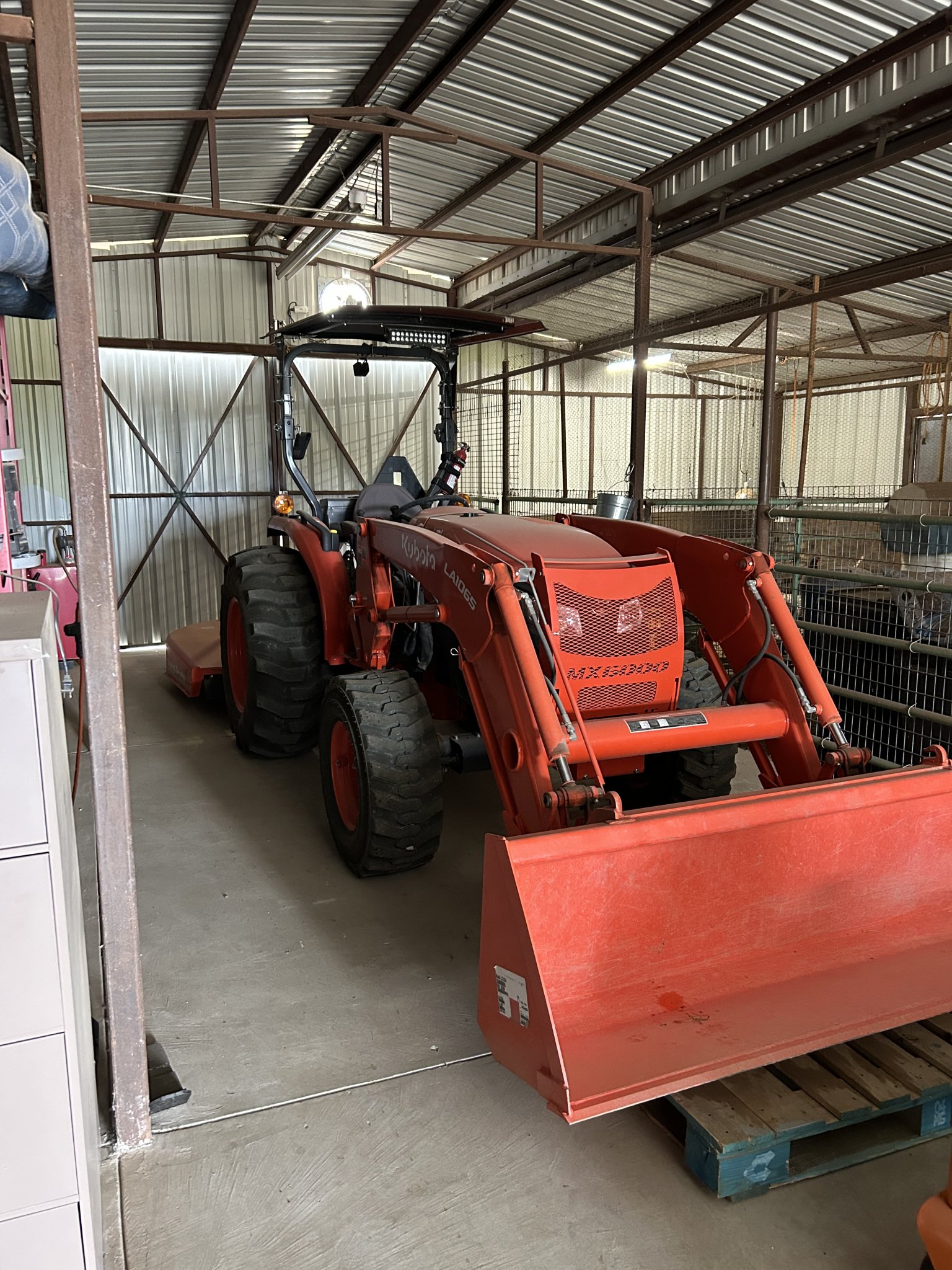

Not a great photo, but you can see the LED lightbar at the front of the canopy and the light facing backwards at the rear. I would take better photos, but my tractor is currently at the dealership getting remotes and top snd tilt installed. My canopy is steel so it’s rigid and has some steel supports also. The front light at is attached to a piece of flat steel I bolted to the underside of the canopy and the tear light is just mounted to a bracket on the ROPS.
Thanks nice Tractor. I was just looking at the L47 that was suggested by Ontheridge. I really that one.

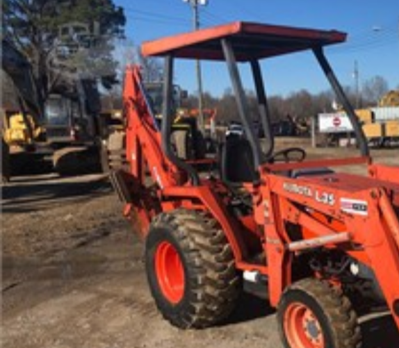

Maybe you could model it after the TLB. You've seen the L47, here's the L35.
I've found one advantage is that the front posts help deflect limbs (and spider webs) from hitting the operator, and from getting caught under the canopy.

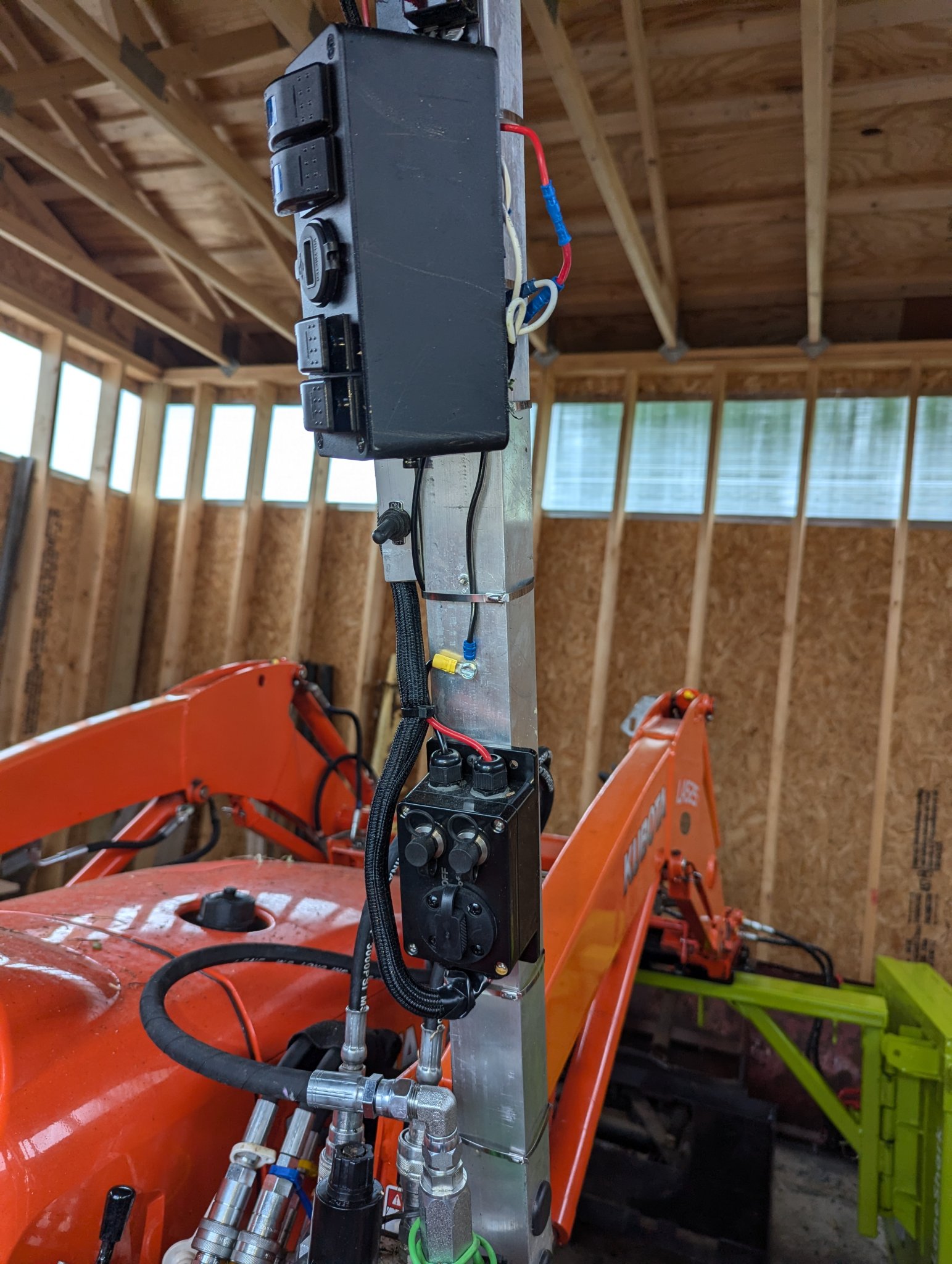

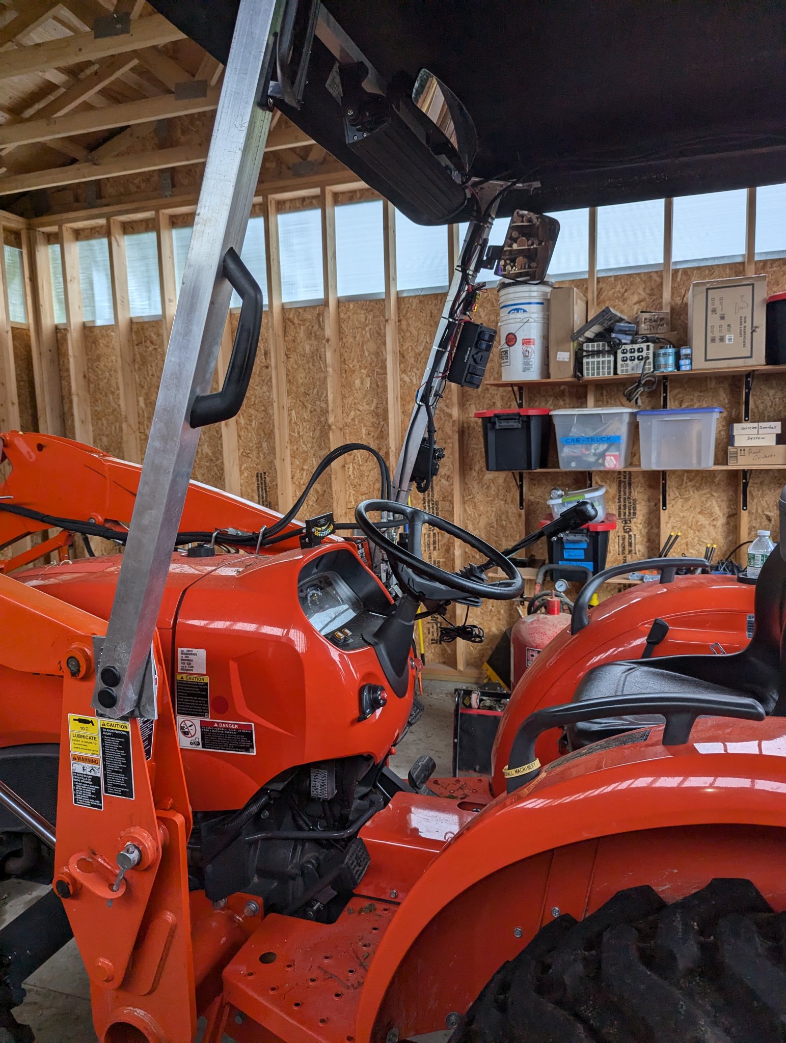

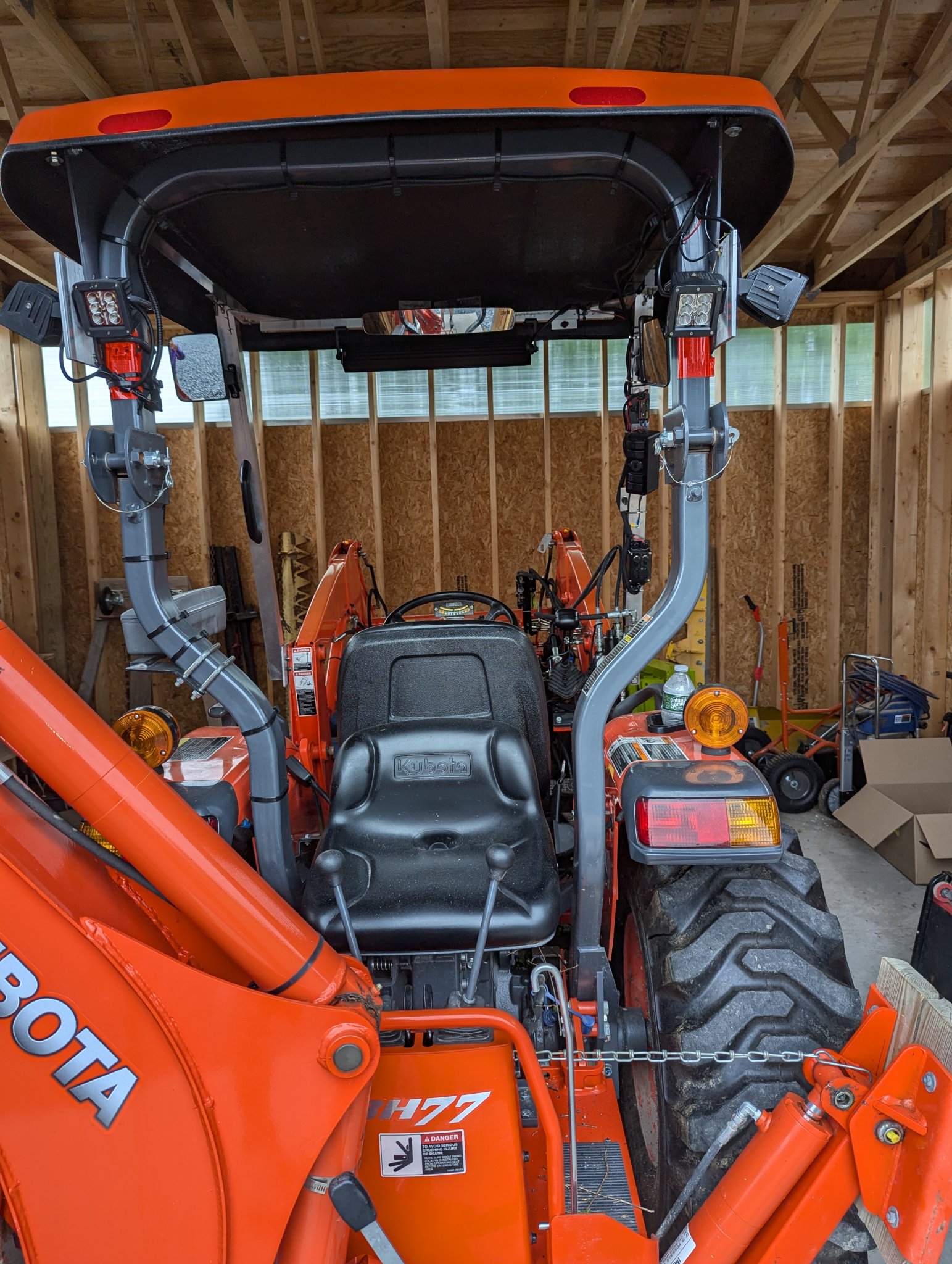

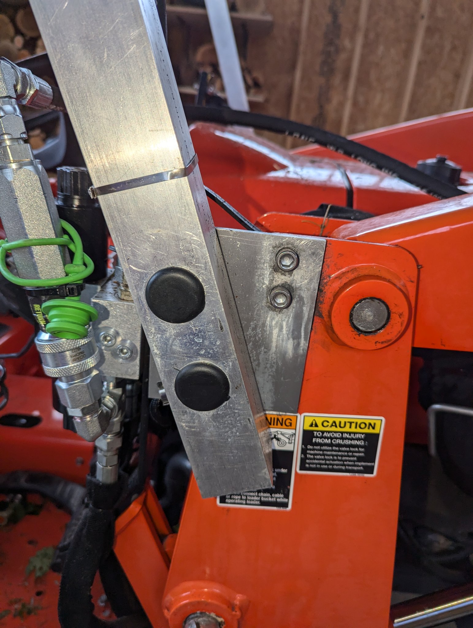

I did exactly what you asked about in the first post - square tubes as front posts. Started with stock Kubota sunshade. Last pic shows amateur overbuilding - my square tube is overkill. My tractor is a L3901, not an M. I can still remove the loader but it would be a real PITA! All attachments to the ROPS are by U bolts. I snow plow so I wanted real good lighting - tractor headlights didn't cut it. Some of the stuff on the right front post includes plug in's for heated gear, battery tender and light switches. Don't tell on me, but the grip on the left front post is a JD item I modified.
WOW GREAT JOB!!!!!
That is what we want
Thanks much for the pics!!!
Could you send me more details?
