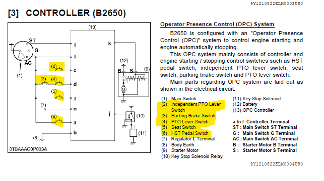

Not knowing the model makes this a guessing game:
or the seat switch
or the shuttle switch
or the other seat switch
or the PTO switch
or the clutch switch
or the wiring
or even the OPC itself

Do you have the WSM (aka Service Manual)?
Below is a list of possible switches and wiring paths that can blow that fuse.
If it's only blowing the fuse when you push the HST pedal, then yes the most likely candidate is a bad HST switch or wiring.

have run into this on those tractors
check the pto switch i've had a few of them just fall apart, shorts internally to ground causes fuse to pop

I have the same tractor,just a little older.
I had the neutral safety switch go bad. It had an intermittent short to ground.
I bypassed the switch with a jumper wire and the intermittent fuse blowing stopped.
I replaced the switch and have not had any more trouble.
