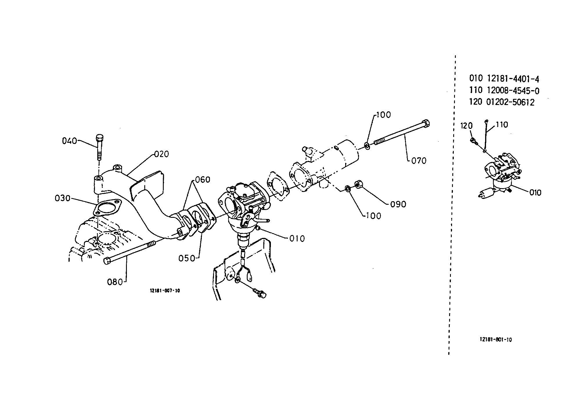

curious, found this , appears to have an electric 'anti dieseling' valve'. When they get 'gummed up', they don't totally shut off gas flow ,so something else to check. Also be sure it gets 12 volt when key is on ( usually can hear a 'click' ,if you have good ears)

yes that's the 'thing' attached at the bottom of the carb
normal test is to remove from carb, apply 12v to the wires and see how far the 'rubber tipped plunger' moves ( if at all).
most move 1-8" or more( they're spring loaded, if they don't return you clean all the 'gunk' out of them, usually 2-3 -or more times. it should move fast and far. if after you clean it and it doesn't move, check the coil for continuity, maybe 100-200 ohms ? varies by make and model but if 'open', it's no good.
replacements can be pricey $50-$100 but i 4 decades never had to buy one,just needed good cleaning.
Don't know if the WSM covers this..bet they say 'replace entire carb' ?? I don't have a WSM for it,maybe someone can check ??

@Greenvillejay is showing pics for the wrong carburetor.
The fuel shut off on that model comes out the side:
