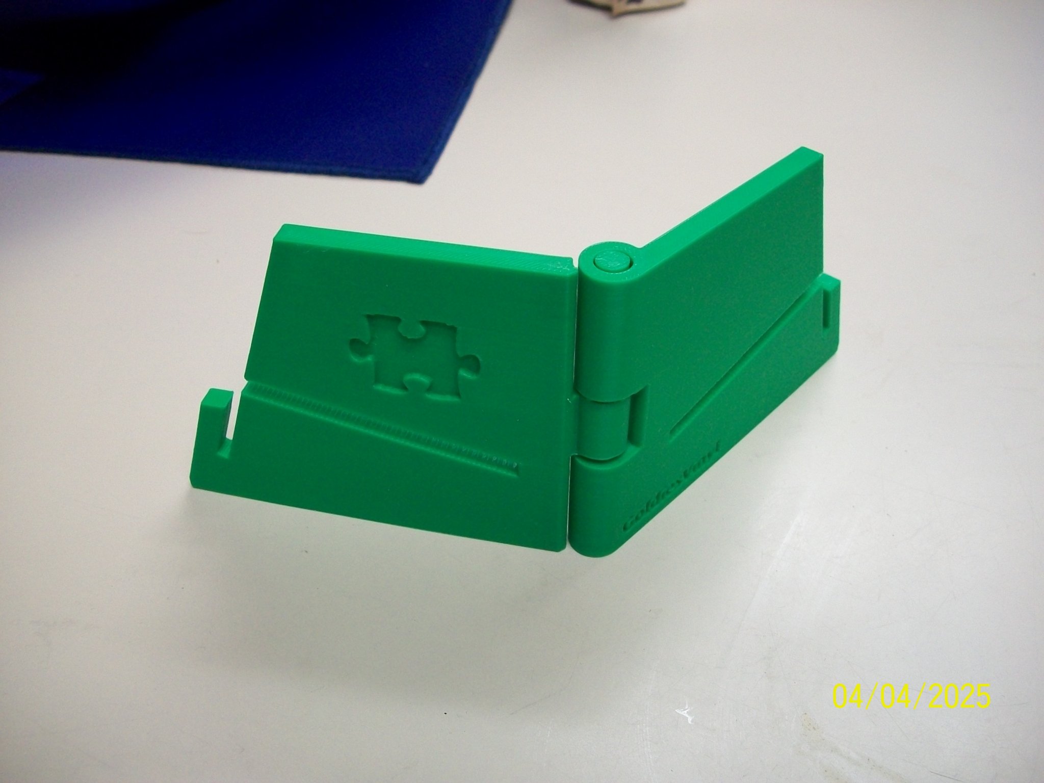

I haven't dived into this yet, (I need another hobby like I need another hole in my head) but the technology & output impresses me.
My wife & her girlfriends do a lot of jigsaw puzzles at events they call "Puzzles & Guzzles".
(grape juice is involved)
One of them found this stand to prop up the box lid for easy viewing.
Workmanship & finish are fantastic, and it was done in one "pour", as a single piece.
There are tiny breakaway posts between the middle & upper and lower hinges, and it swings back & forth quite easily.
Very cool!
