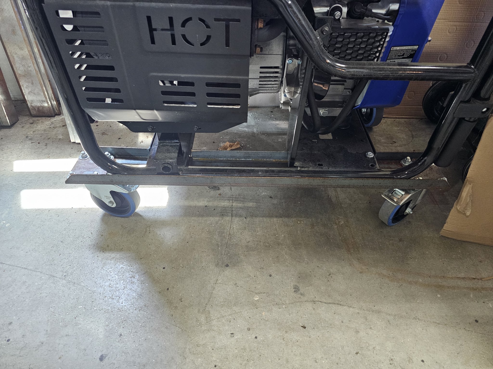

I did add four 5" all swivel locking casters to my giant Duromax one.
