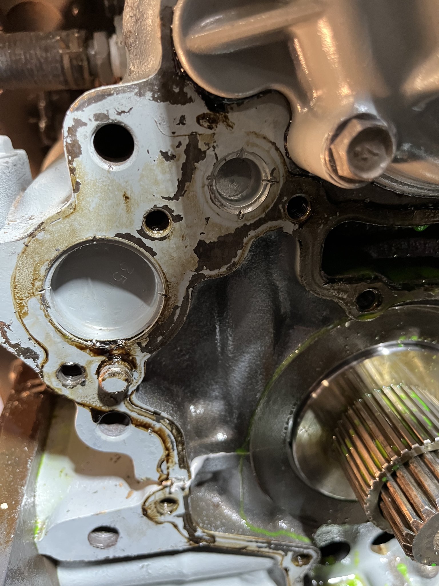

My guess is one of the small expansion plugs under the front cover didn't need to be there. I checked the pump when it was apart and yes the o ring from the pick up tube was installed. I will be pulling the oil pump cover off today (not looking forward to it as the tractor is all back together.)

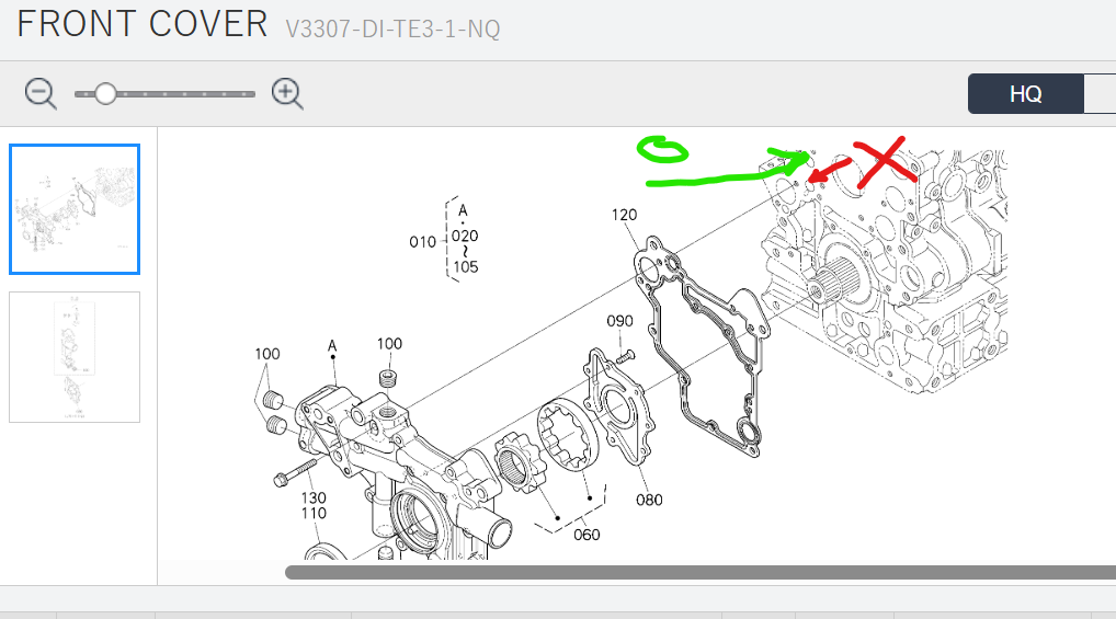

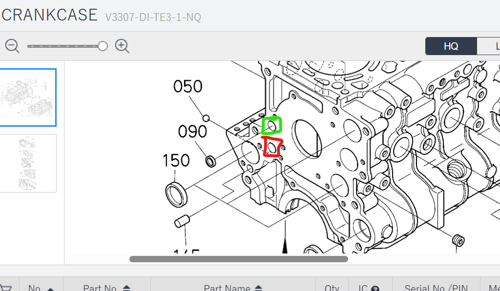

Yes if you put a cap/plug where the red is there that is 100% your problem
That is an oil galley
The plug should be in the green spot only.
If you pull plug 100 (Yellow) you will see the cap/ plug in the block
Yep. pulled the cover and the plug was in the hole, I feel better because I didn't install that plug the machine shop did. I can tell and the hit around the edges with a chisel to keep it from coming out. Checked oil and no glitter, engine was only ran a couple of min, so fingers crossed it didn't hurt the bearings. Ill post a pic later.
